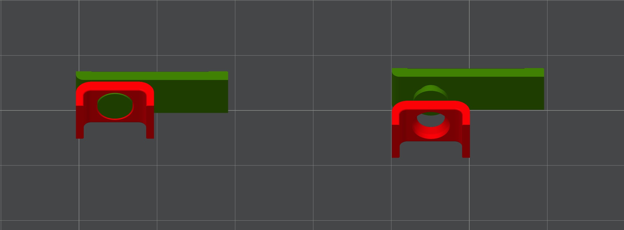

Just for clarity, I’m attaching a picture with the relevant detail… on the left as it is designed (and printed), on the right split into two parts for clarity… dimensions WxH 20 x 6mm, the head of the “peg” has a diameter of 4.5mm… Yes, it’s small, but as I said, it works great when printed separately, just not together…

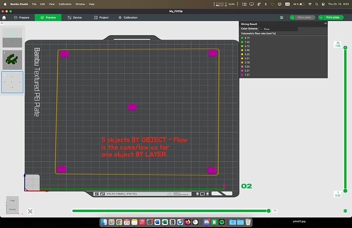

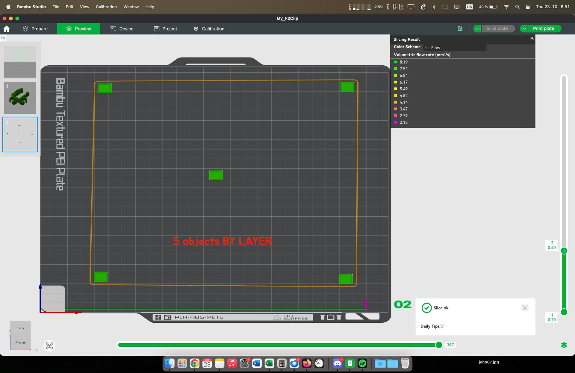

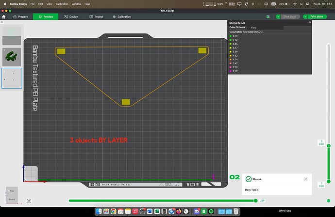

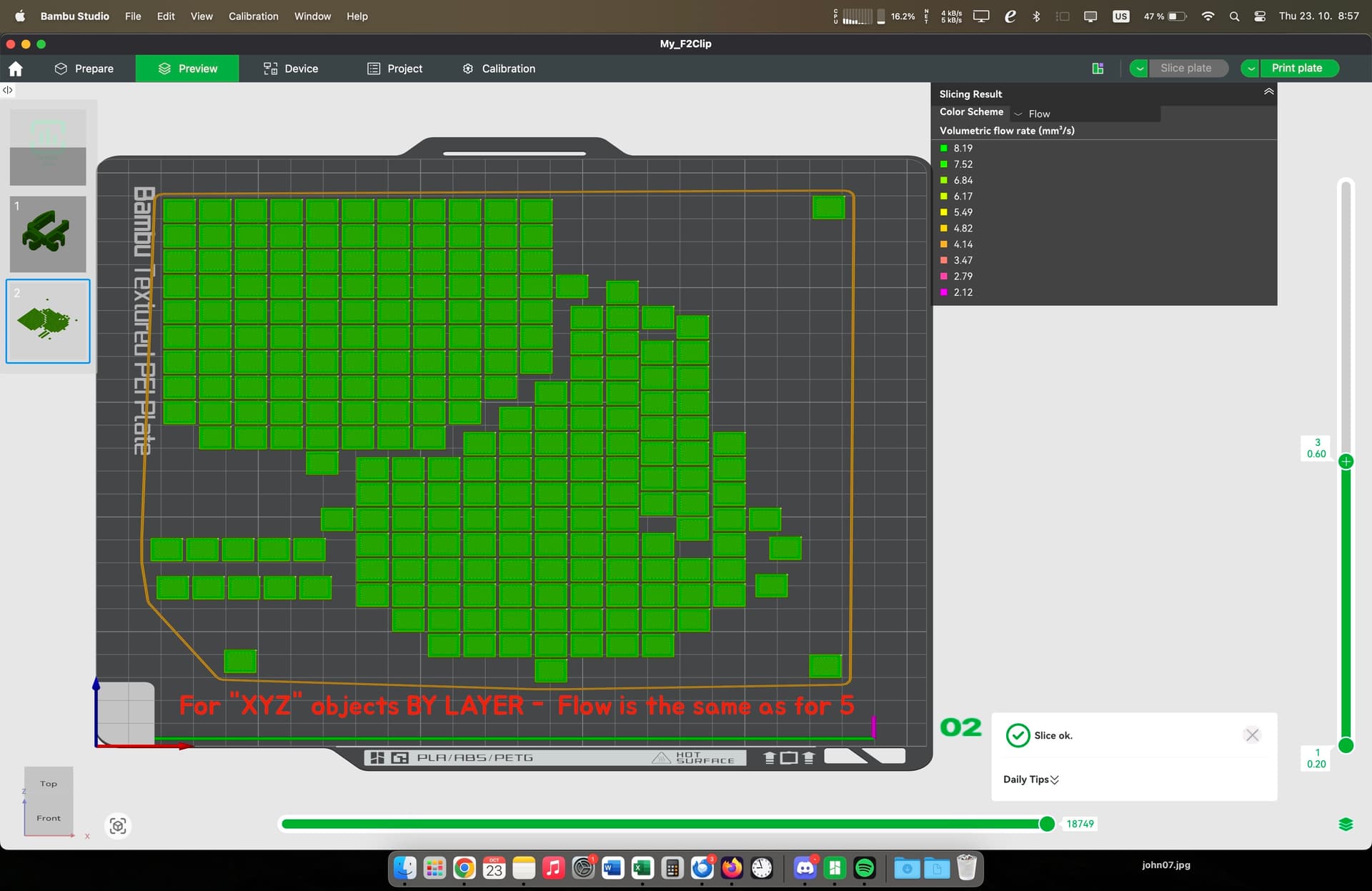

Well, maybe I figured (a little bit) out why this is happening… it seems that the problem is the increasing FLOW RATE. If it is low (for one object in my case), it is OK. But as soon as the number of objects increases, the FLOW starts to increase and causes a problem = the rotary joint “seizes up.”
What I don’t understand here is why the Flow increases with the number of objects? (I’m not saying it’s a bug, there’s probably a reason for it… I just don’t understand it). In my case, two objects are enough for Flow to exceed the “functional value”… however, Flow increases (at least in my case/test) up to five objects, then it seems that it does not increase any further (in other models, this may of course be different).
So my questions are:
  • Why does Flow increase like this?
  • Can this be prevented in any way? (Apart from setting print by object)
I am attaching a few screenshots that show how Flow increases:
  • from 1 to 5 objects when printing “By layers”.
  • 5 objects when printing “By Object” (here the values return as if only one was printed).
  • And finally, just for interest’s sake - again “By Layer” where there are “a million” objects - no difference can be seen compared to 5 objects.
BTW, test object is just a simple cube 10x10x1mm
In your filament settings, there is a setting for some time “targets” and it can slow down printing to try to hit those targets, which would look like reduced flow when not much is being printed on any given layer
its kinda hidden and poorly named, but mouseover it for the tooltip
I’m not too wild for using it for PLA at all, but it is on by default. it becomes useful when you run filament that needs zero fan.
