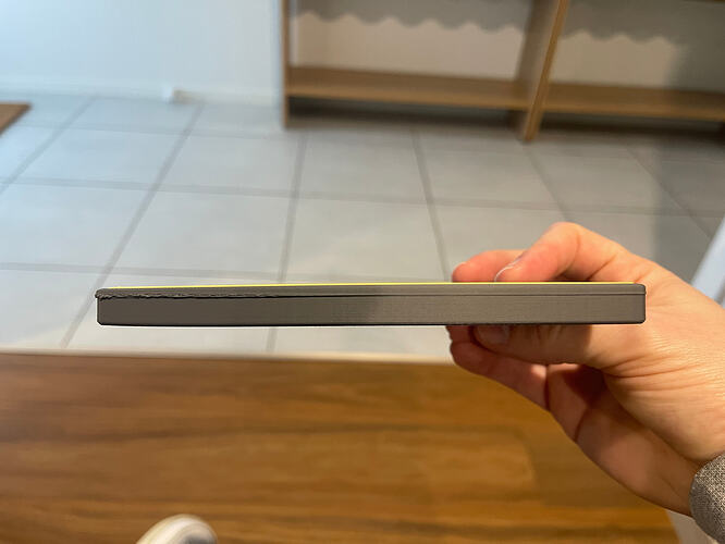

I’m trying to understand why this model is printing the way it is. Please read everything before commenting, as I’ve done quite a bit of troubleshooting already and have ruled out many of the obvious causes.

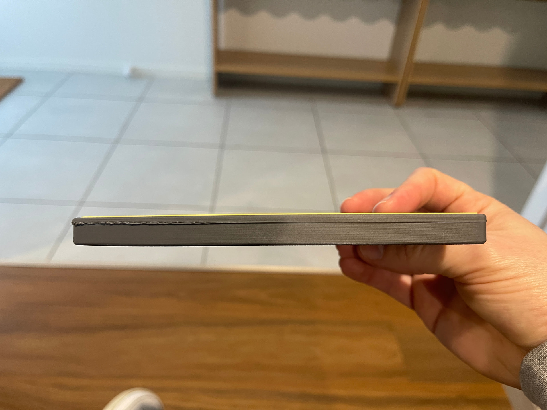

In the first image, you can see what appears to be over-extrusion around the edges. I’ve done a lot of prints and have noticed a pattern: this only seems to happen when the printer is moving back and forth over short distances. My theory is that, as the print head approaches the corners and the travel distance becomes much shorter, the extrusion rate is too high for those small movements compared to the longer runs across the middle.

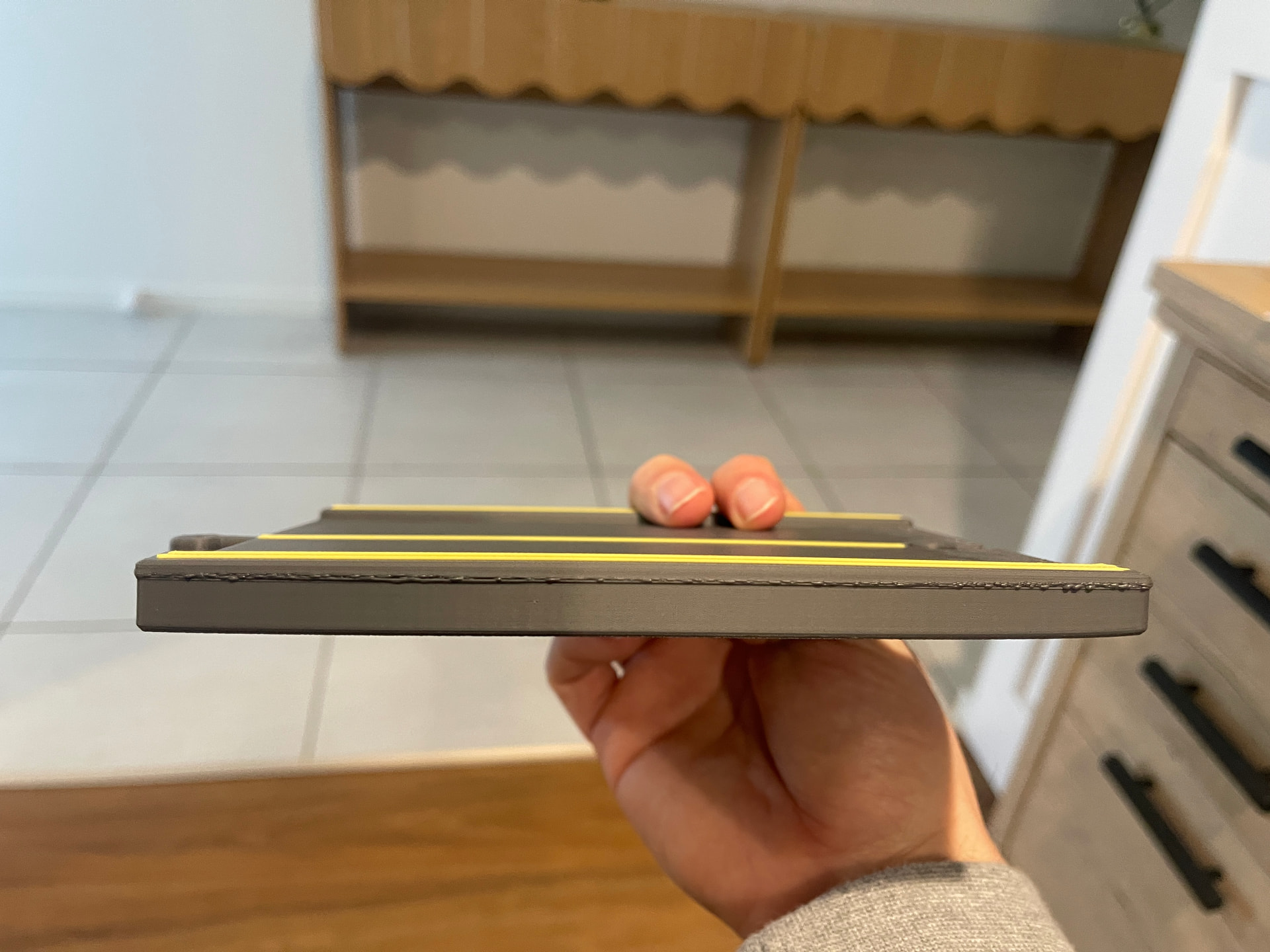

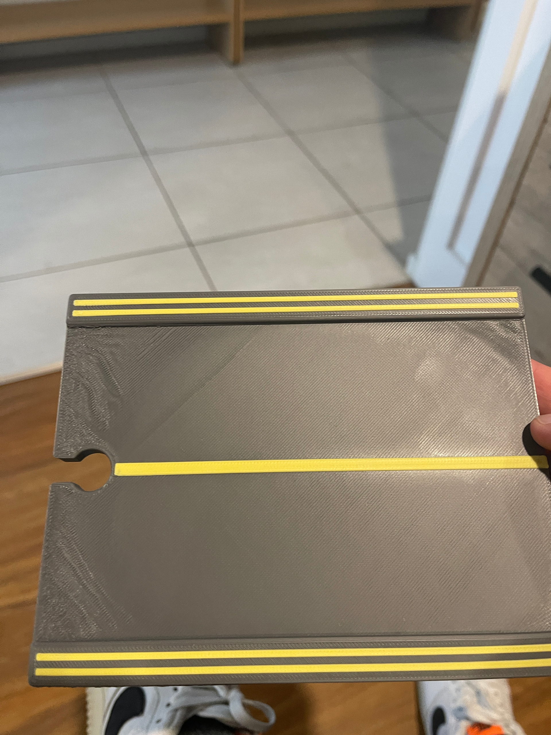

In the second and third images it’s a little harder to see, but one side of the top surface appears thicker than the other. This seems to be because the top layer is sagging or overhanging slightly on that side.
Here’s everything I’ve tested and confirmed so far:
  • It’s not a filament issue. Initially I suspected the cheap eSUN filament I was using. To rule that out, I opened a brand-new spool of Bambu Lab filament and printed the model immediately after unsealing it. The results were virtually identical, so I’m confident the filament isn’t the problem.
  • It doesn’t appear to be a nozzle or printer issue. I’ve cleaned the nozzle, checked the cooling fans, and inspected the printer. More importantly, it prints other models perfectly. For example, I printed two Bambu Lab spools yesterday, and they came out immaculate.
Because of this, I feel I’ve effectively ruled out both the filament and the printer, leaving either the slicer settings or the model itself. However, the model has excellent ratings, and I can’t find any obvious issues with it. Many other users have posted photos of successful prints. I’ve also synchronised my printer and filament settings in Bambu Studio, so I’m using the correct profiles.
At this point I’m genuinely baffled. Through a process of elimination, I feel like I’ve ruled out everything obvious. Has anyone experienced something similar or can suggest something I may have overlooked? The issue seems to occur only with this specific model, yet everyone else appears to be printing it successfully.

I’m almost certain the issue is caused by part warping - as it lifted on that edge, the 0.2mm of new height for the new layer to be printed in disappeared due to the upward curl, so the only place the filament being extruded for the outer wall loops could go was outward.
Dry your filament before printing, and clean your build plate very well with dish soap, hot water, and a nylon scrub brush. Dry with clean paper towel afterward.
If the warping persists, you may need to use glue, add a brim to the part, or both.

Looking at the second picture it looks like there is a warp of the lower right edge:
If the model bends upwards due to warping it gets closer to the printhead and that will look exactly like it does on your print. There’s too little space between the print and the hotend and it will look like massive overextrusion. At my case it even lifted the plate from the magnetic bed. Depending on the material you use you might have to play with temperatures and cooling to get warping under control or reduce strength of the model.
Some good answers here. The curling/lifting off the build plate is what is causing the surface scarring. The change in layer print time between the large flat area and the smaller border region that sticks up around the flat area is why the squish out the sides. The Bambu wiki discusses this and ways to get around it with chamfers or fillets to smooth the layer times transitions.

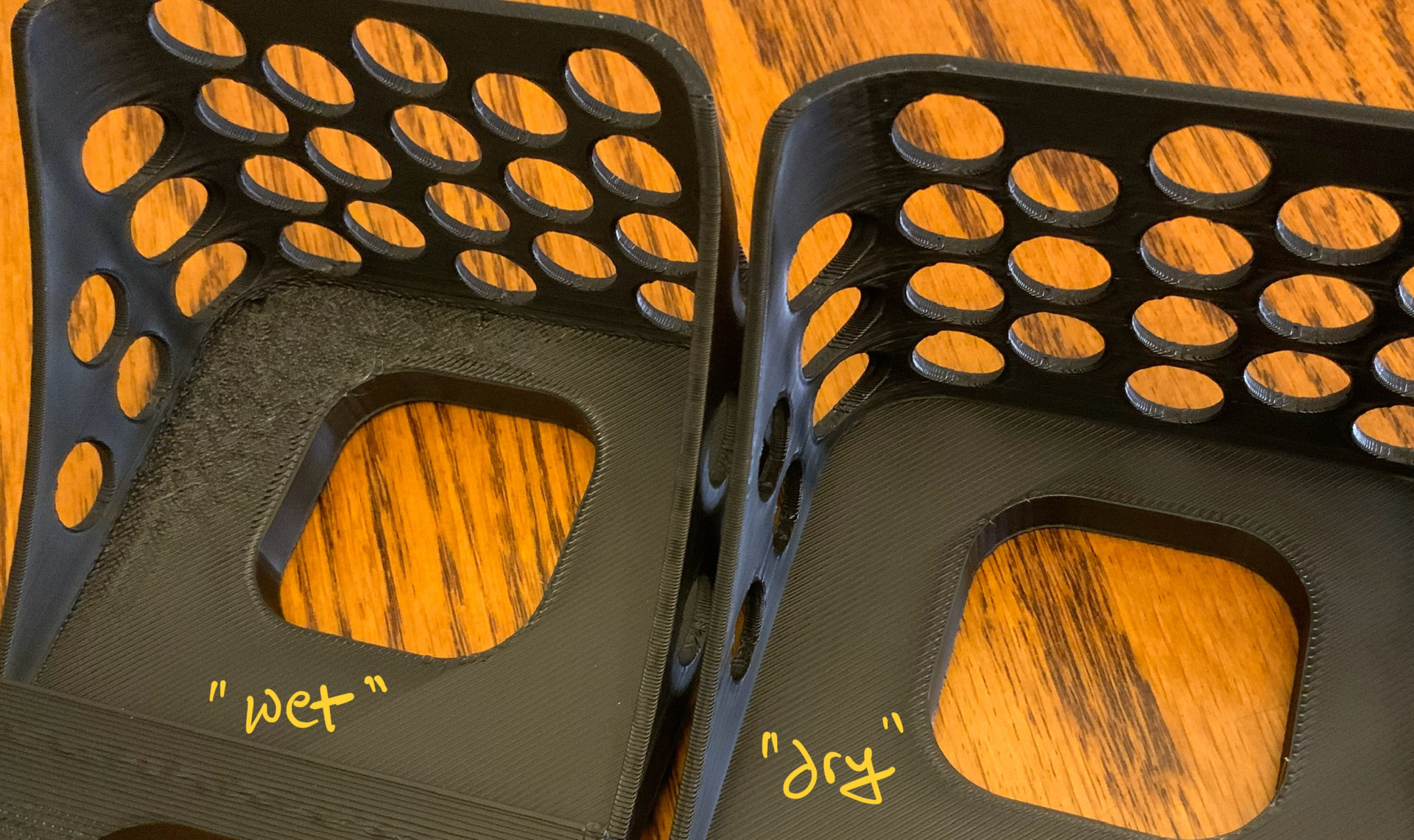

And about the filament being dry, I saw very similar lifting/scarring issues with wet filament that simply disappeared with dry filament. It was even the same spool of filament. Only difference was drying.

Can you use a straight ruler and check flatness of the bottom of the print?
I also used to believe this, but the fact that the factory sealed the filament in plastic with a desiccant pack doesn’t mean it’s impossible for the filament to be wet.
Humor us and do a good drying cycle and see if it helps.

Looks to me like it is warping of the parts. This more challanging from long continuous walls.
The filament is put down at the same temperature for all the layers. The ones closest to the bed harden at the full size. Then as it goes taller it is relaying on the layers below to hold its size. When they cool and shrink it pulls the ends up off the bed. It is obviously a bed adhesion problem.

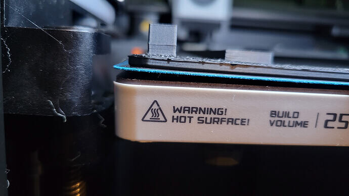

Others have had models curl up the build plate during printing. There are certain design features you can add to a model to make warping/curling less likely as well as controlling chamber temperature and print settings to minimize that. It’s not always an adhesion issue as illustrated in the link @simon14 posted — but frequently is.
yes that is the same warping problem it is pulling the bed up not just breaking the bond to the bed.

is that raising that bed during the print? I am guessing most of that print was with the bed down. and it came up after cooling.

IMO your edges are warping up off the plate. If its not curling off the plate, its bringing the plate with it, but that is warp imo. Huge full plate contact patches can and will warp so strongly it brings the plate with it. When we used to print on glass, it shattered the glass.
So, if your plate is staying down, try a brim first, glue second.
If your plate is raising up, you need to consider some more wild things. People use bed clips to physically restrain the plate, which might work.
