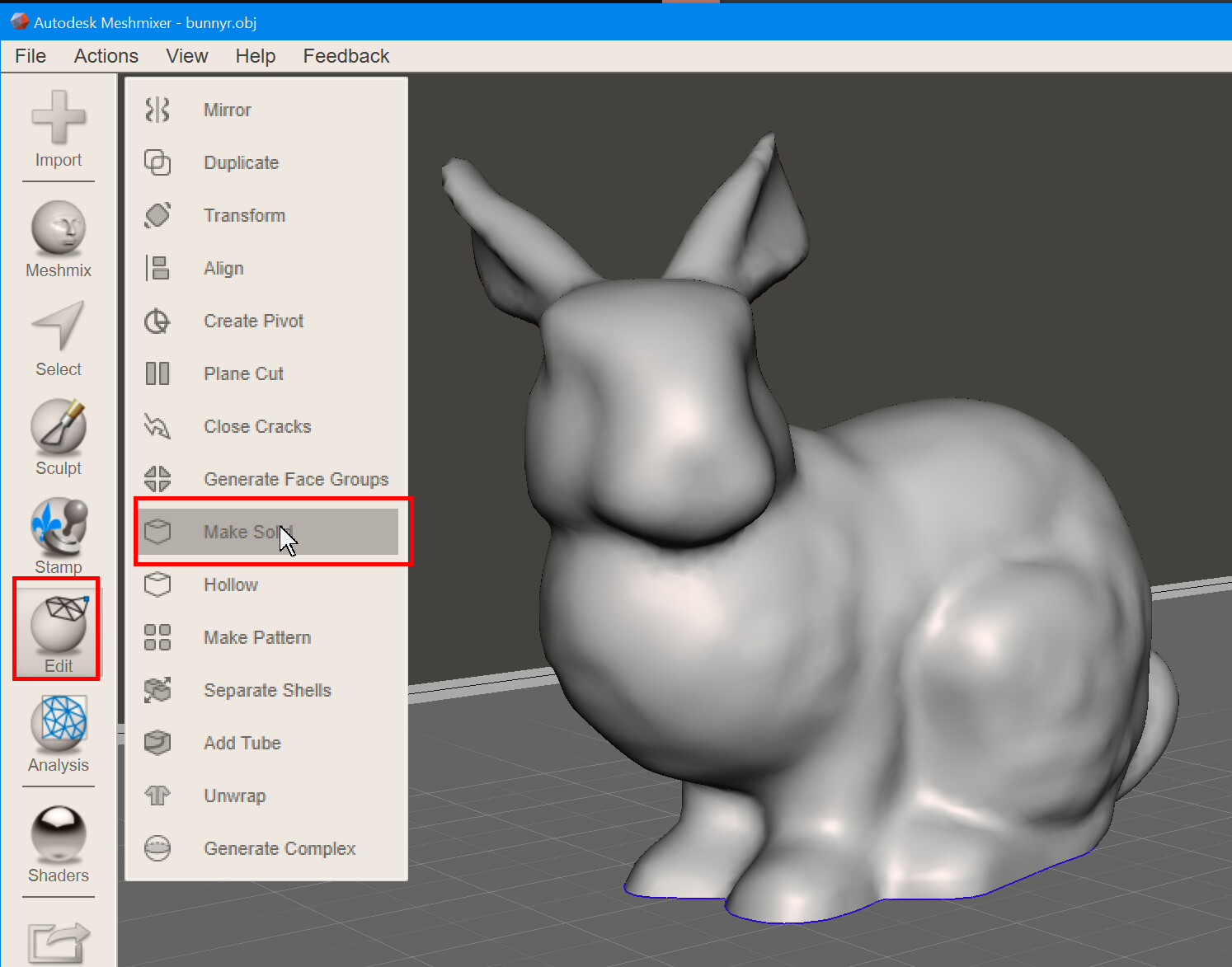

The best tool for that is Meshmixer from Autodesk, it’s free.
Load your STL, click edit, then click solid and file/export. Make sure you choose the right file format, STL or 3MF.
After it makes the model solid, you’ll have two models. Click the solid one before exporting.

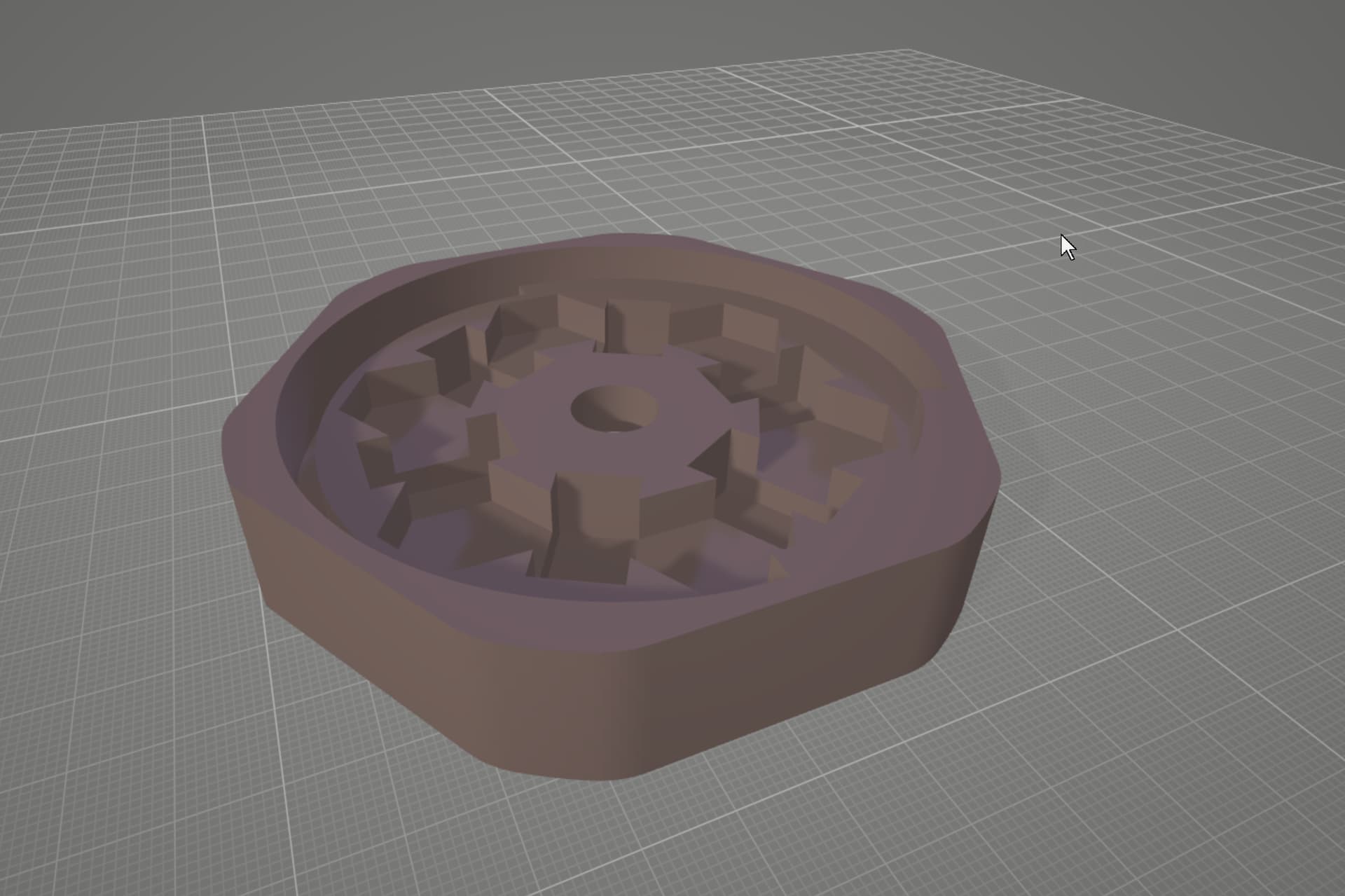

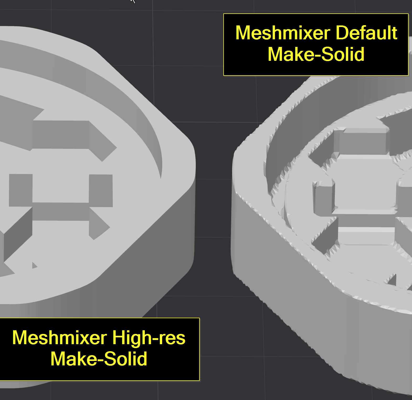

If the input model is flawed, no slicer or other software will improve it if the information is incomplete or damaged. This is especially true for defective or non-manifold meshes. Meshmixer—though not my preferred program for this purpose—offers many options that can output the same surface while leaving the interior solid. Mastering them requires experimentation. Alternatively, Autodesk Fusion 360 provides the same functions with more granular control but comes with a steeper learning curve.

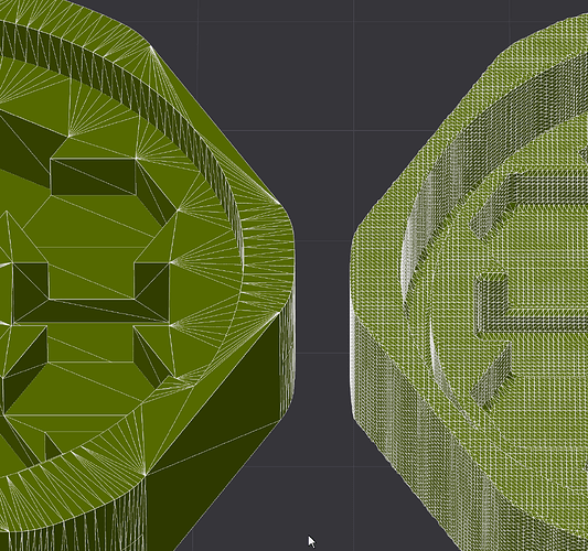

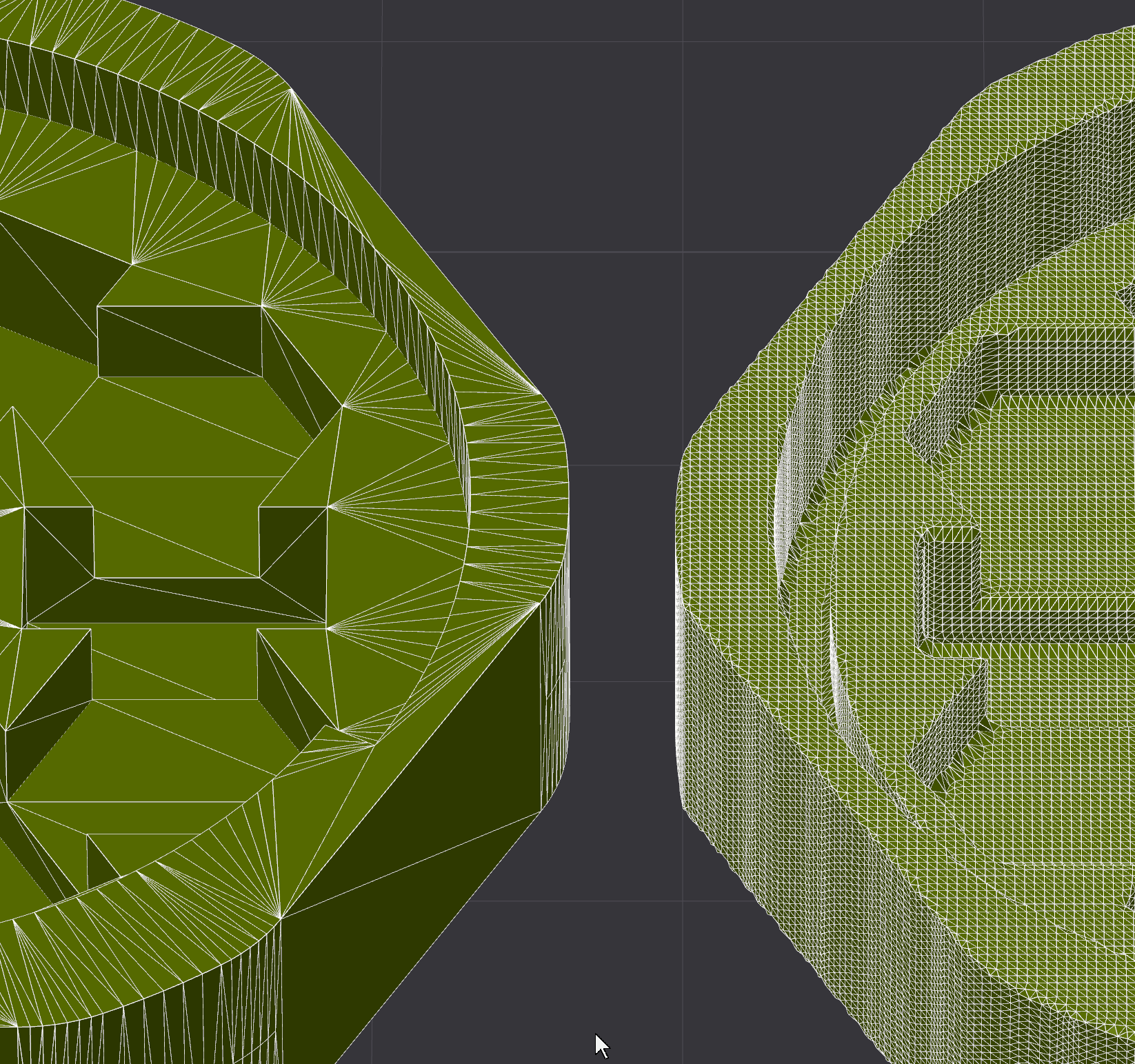

You may be experiencing this degraded level of quality (object on the right), which is the default Meshmixer make-solid setting. Admittedly, it looks horrible, and the edges are degraded. However, the one on the left has crisp edges when the resolution is turned up and one uses face-groups before generation.
Click to zoom in high res images.

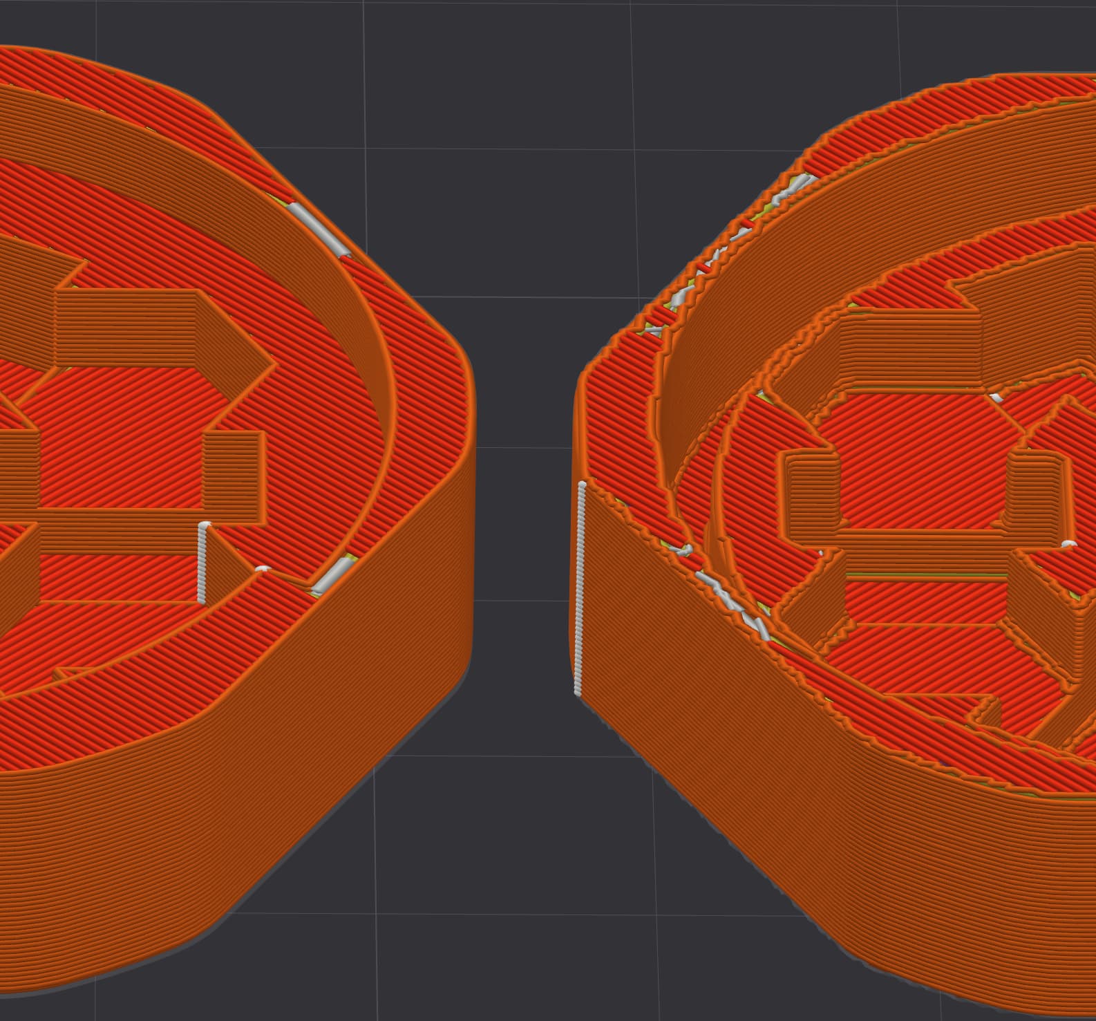

And as you can see, when one looks in the slicer mesh view, Meshmixer does an even better job of fixing the mesh than the slicer itself. Here’s what that looks like. Note the overwhelming number of vertices in the model on the right which is the bad default mesh mixer solid output, however, the one on the left which is the higher resolution model has nicer flatter edges. This same principle can be used for organic shapes too.

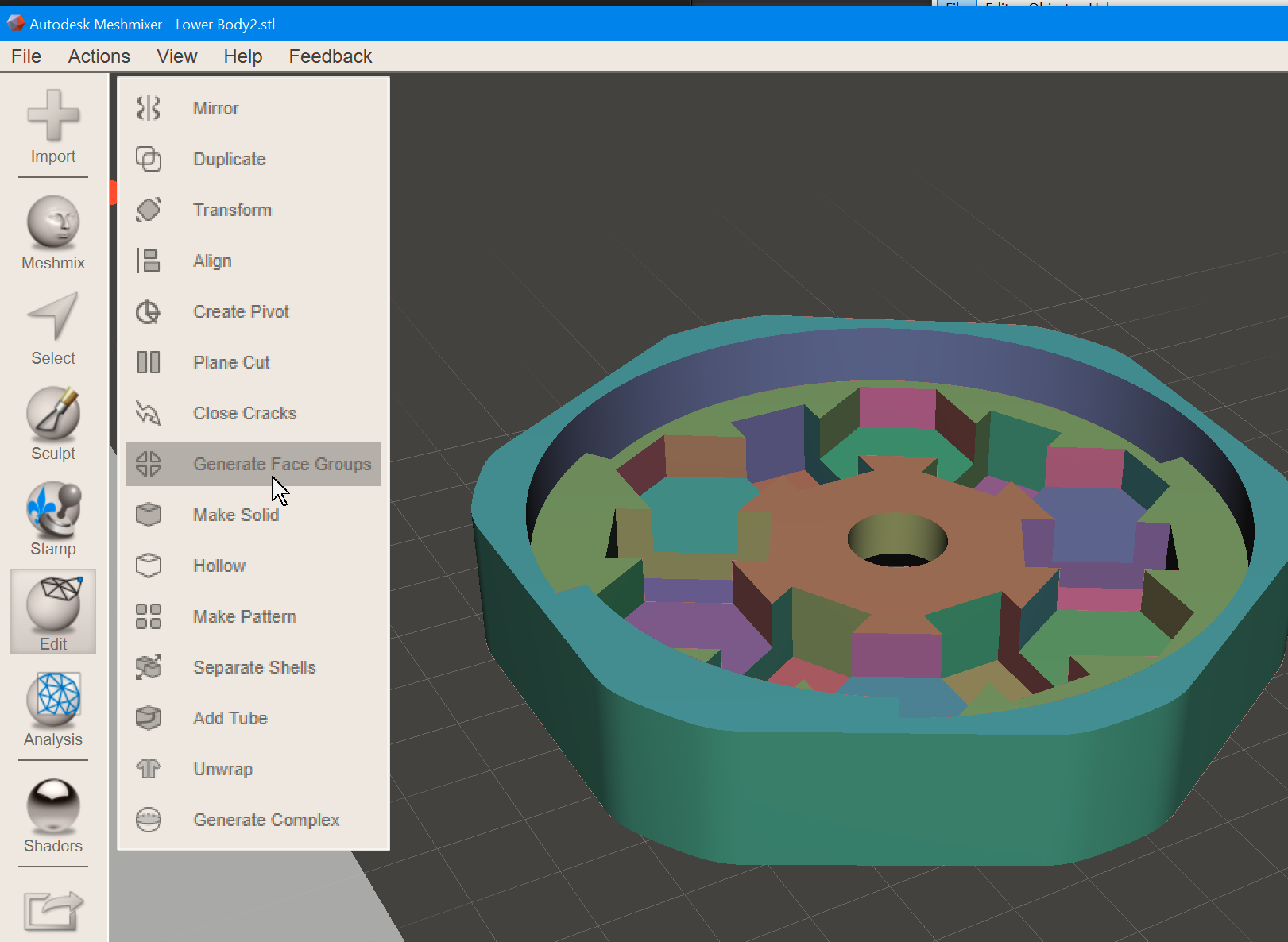

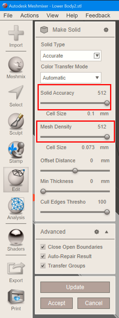

Here are the settings I used. I first used generate face groups which is similar to that function in Fusion 360. This allows the algorithm to refine how it creates the solid mesh.
Then I crank up the resolution.
It produces a very crisp output. Here’s another view using 3D Viewer.
