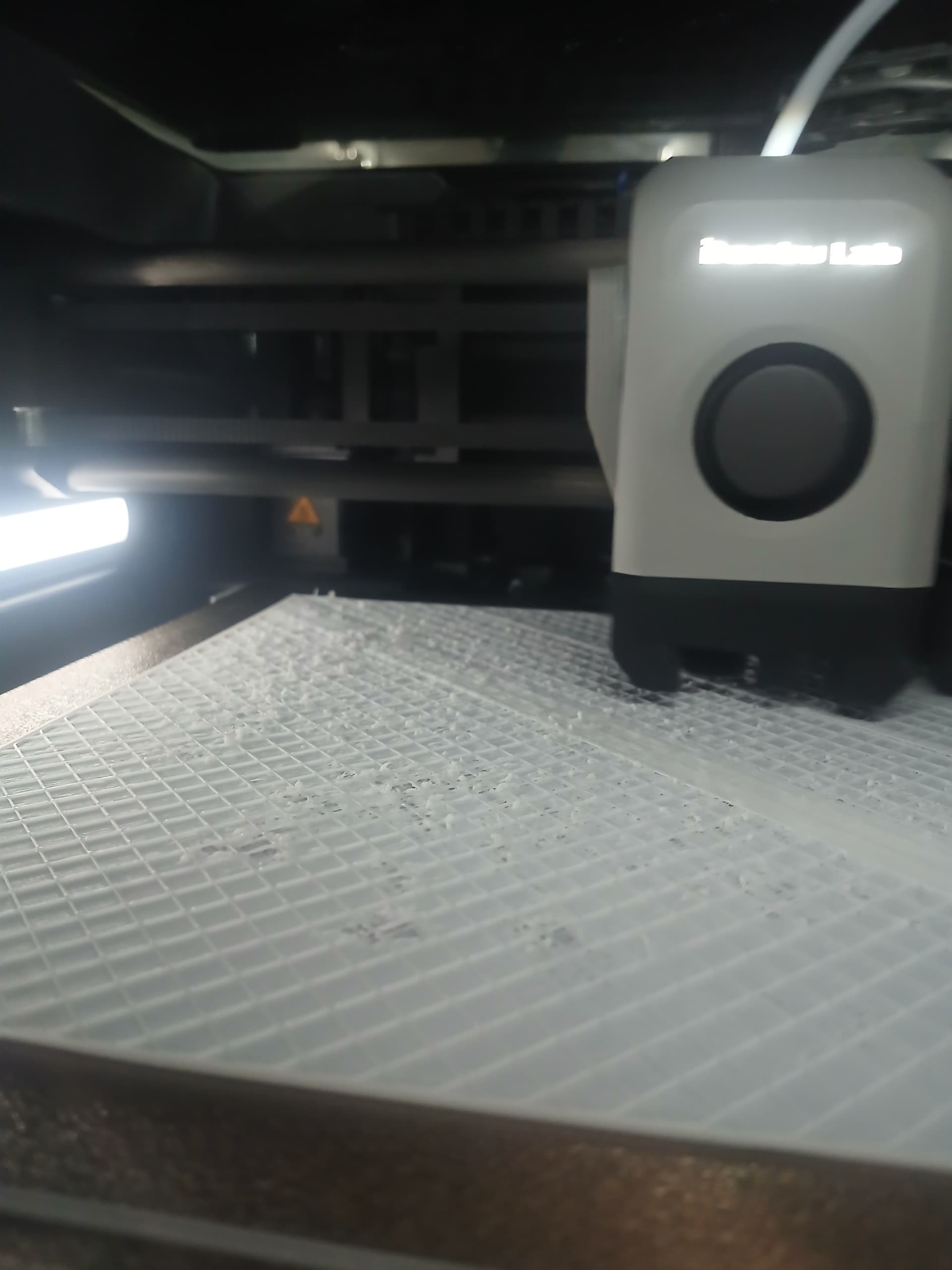

Hello,
I need help where when I using printing speed sport or ludicrous, the surface will become rought. Do I need to calibrate or need to add more lubricant? Currently using X1E
You’re simply printing too fast since your hotend/flow rate cannot keep up with the speed you are using, IMO. You can disable/lower the speed of the aux fan to get rid of the curling infill.. you can increase infill walls and use a different pattern to address this too. There was a recent bambu studio update which introduced a new pattern which allowed more than one infill wall width. In the end > your printer reaches limitations.
Are you using the standard hotend? You need a high flow one to be able to push the speed up.
The E3D is best IMHO. Also available from Bambu store if in stock in your region.
Welcome to material science
You need specifically high flow branded filament to expect good results at fast speeds. They are formulated to melt quicker, usually be less viscous, and have a lower liquid-phase surface tension.
That being said, you might increase the nozzle temp to try to get it better, but “too fast” is a real thing and with no other data shared than the pic and x1, i think youre going too fast
