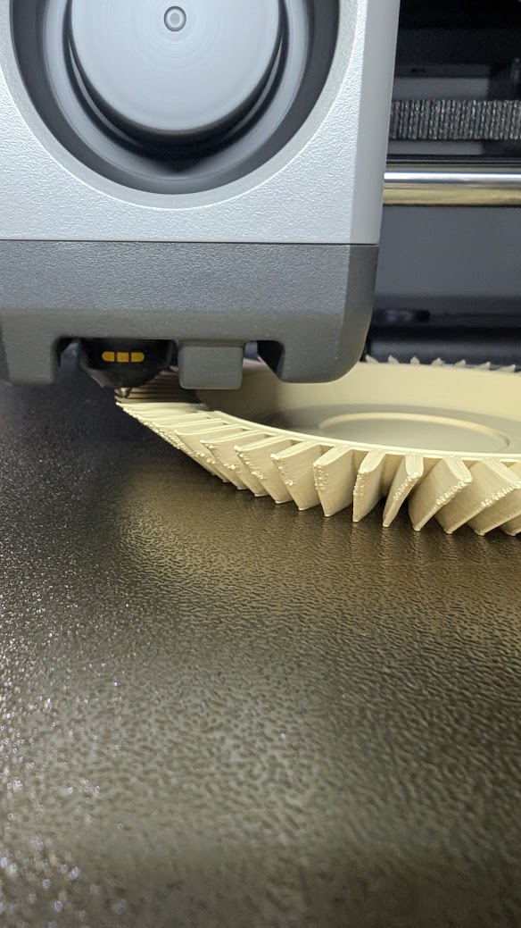

Problem, printing, left side
I’m having this printing problem on my P2S on the left side, when viewed from the front. It happens on large parts. I’ve tried rotating the part on the Z-axis, but it always happens on the left side. Is there a specific setting I need to adjust? There’s no problem with small parts.
Or it seems like a cooling issue.
Since it’s a vase, the process is exactly the same. But it only happens on the left side and on parts 20 cm or taller. Maybe it’s the airflow. What do you think?
i think that is the reason why they sell the left side exhaust fan kit, for big prints since the right fan cannot reach that far, i installed it on my P2S and prints come out clean on both sides every time
Which fan are you talking about?
Do you have a link you could give me?
Thanks in advance.

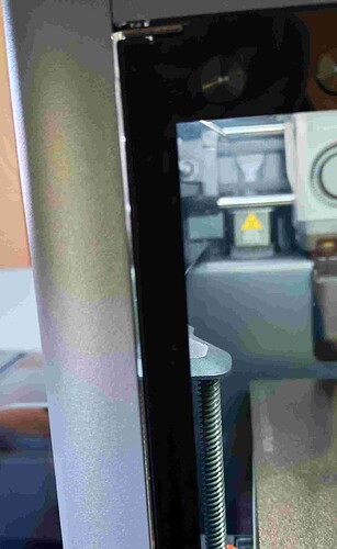

I had exact same issue. I looked closely at the plastic strip that’s attached to the inside of the door, it isn’t in the correct place, I gently pulled it off and refitted it so that it made a better attempt at sealing that side. It seems to have worked but I havent done quite such a large print since.
I raised a ticket and sent photo’s of the gap and explained the problem, BL sent me a seal and some new hinges, the seal didn’t fit and I didn’t need new hinges…
Auxiliary Part Cooling Fan - Left | Bambu Lab EU Store
you mount it on the left side of the P2S chamber (thats why you have the 3 screw mounts on the side)
Thanks for the information, but I don’t have any issues with the door’s seal.
I’ll try the option with the fan.
Great, I just added the new fan. However, I think the problem persists.
Is there a specific setting for filament cooling?
Or should I leave it at the default setting?
Because it seems to be blowing very hard even by default.
personally i s just leave the fan setting as is, and so far i got great results with it, but depending on your situation you may need to adjust the speed a bit, its something you have to try and error yourself into :grin:
