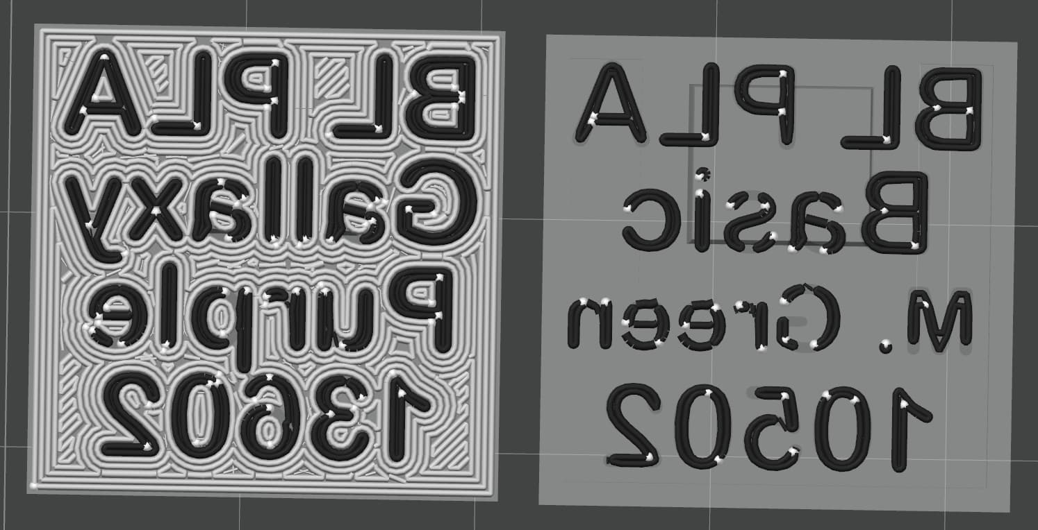

I recently tried to print with a .2 nozzle, and the 1st layer wouldn’t adhere to the build plate. I tried cleaning the plate with Dawn dish soap. I also tried IPA. I tried 2 different build plate (PEI textured and PEI smooth). It prints the purge tower with no problems, but when it goes to print the actual print, it seems like the nozzle isn’t close enough to the bed and it prints spaghetti. These are the settings in the slicer.

The model is partially flawed or incorrectly positioned. Take a look: the left side is lying down, while the right side is floating. The creator made a mistake.
…and thus explains precisely this problem. It’s not your fault, nor is it the printer’s fault. You can partially fix it by pressing this button to realign the models, but to be honest, I would choose a different model.

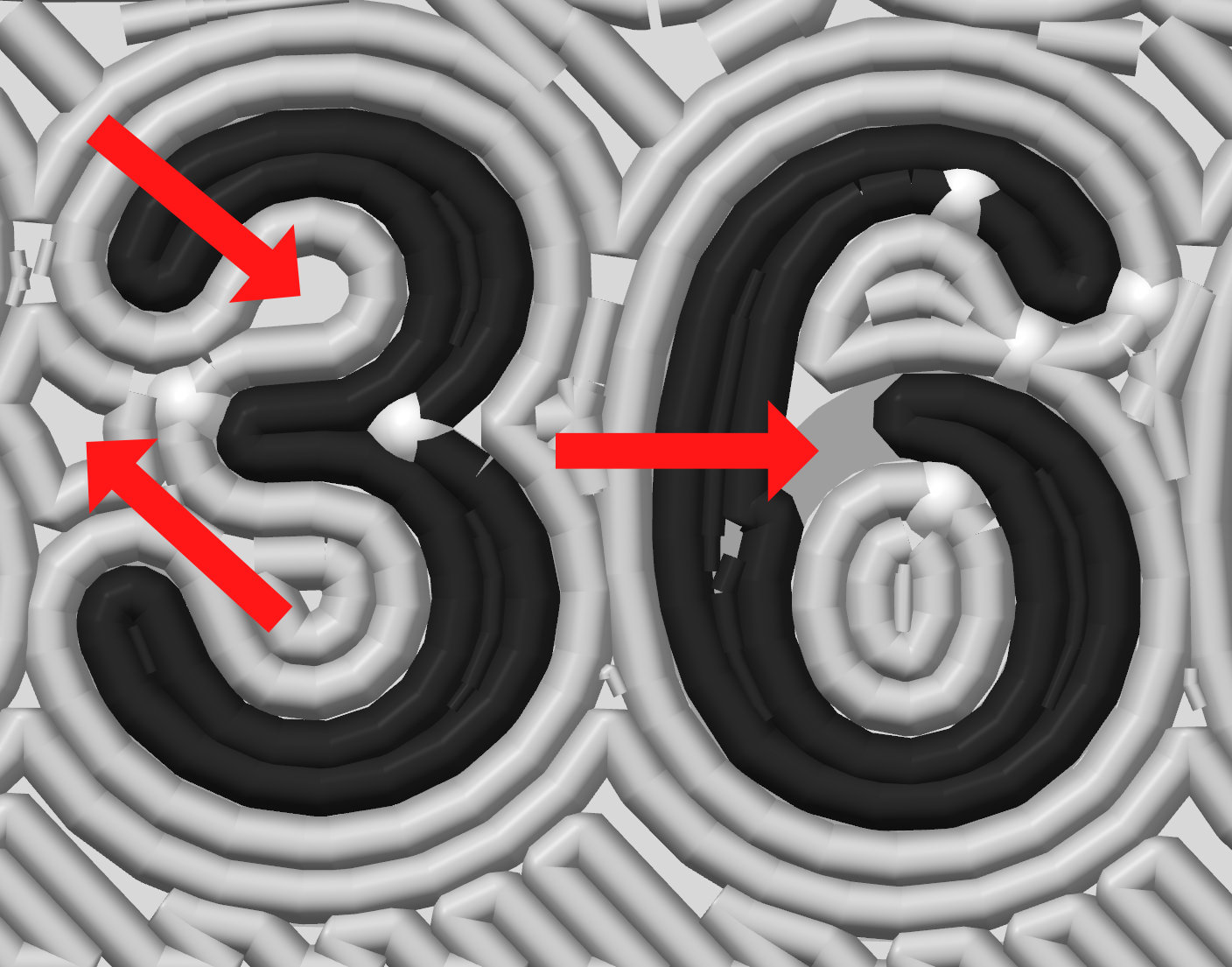

In addition, the font is not really optimized for 3D printing. Many gaps that can lead to problems - but don’t necessarily have to.
For something like this, it’s always better to use PEI smooth, which you already have anyway, as it has significantly better adhesion. :+1:

I think you are correct about a different model. I tried to lay on face and the face had a lot of points to lay it on. Looks like it isn’t flat.
I have a successful print. I was able to drop the print .04mm down into the plate and everything printed great. Thank you for the assist.
