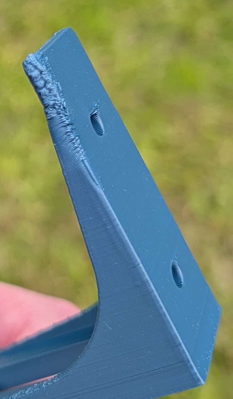

Problem printing with this ASA

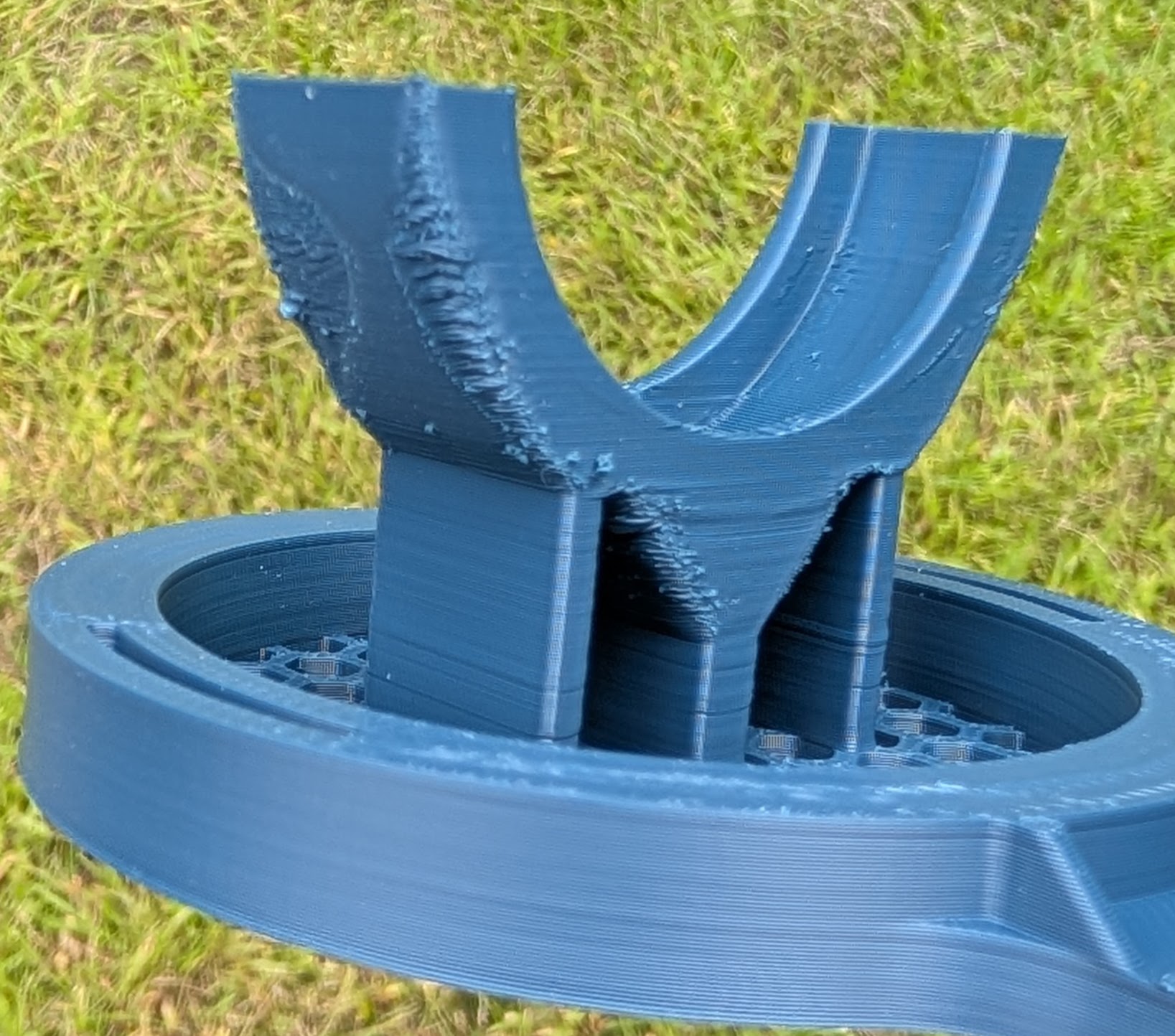

Can anyone suggest how to fix what is going horribly wrong here. Printing with a H2D in Fillamentum ASA Extrafil using a printer profile constructed from Filamentum’s printing recommendations and generally the ASA generic one but slowing down the Max volumetric speed to 4 mm3/s. I did dry this beyond the manufacturers recommendations at a temp of 80C. I’d like to get this one nailed for outdoor use around our house as it’s a close enough color match for some of our trim. Unfortunately neither BL nor Polymaker has a close color match.

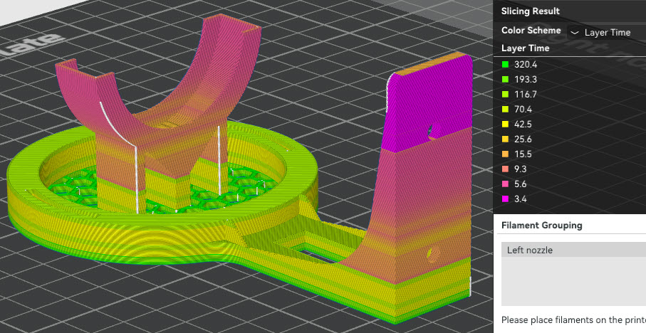

Slowing the max volumetric speed is one thing, but it looks like there could be a cooling issue where some areas aren’t getting a chance to cool sufficiently before the next layer goes on over top.
On your slicing results, select “layer time” and see if the areas that are sagging corresponds to layers with low layer time.

Seems like the problems are with the shorter layer times, but not 100%. Generally sub 10 second layers are mostly the problem areas.
I see this when printing ASA as well. I’ve found some manufacturer part fan speeds are set too low.
As long as your chamber is maintaining a stable temperature of atleast above 45C, increasing your part fan speed can help.
I’ve had good luck increasing from say 30% max fan speed, to 50% or 60% max fan speed, without reducing my max flow rate.
I just took the generic ASA profile and adjusted the fan speed to 55% for layer times of 16 seconds or less. Left the max volumetric speed at 12. What a difference. Wouldn’t rate it a 10 but at least a 9.5. Thanks for the suggestions.
