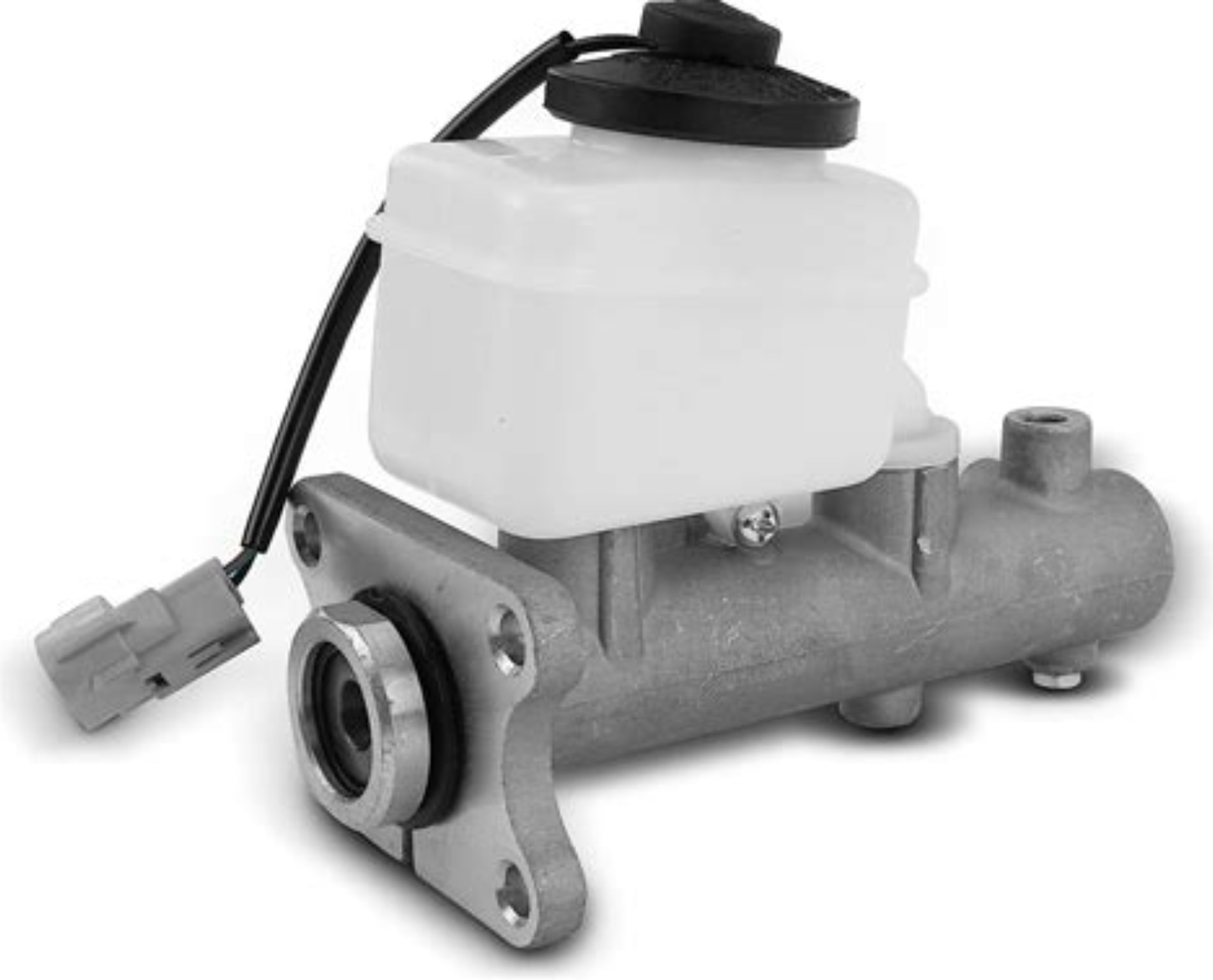

Maybe you could post a photo? It’s hard to picture what you mean, even though I looked it up on Google. Do you mean this? The connector in the picture?

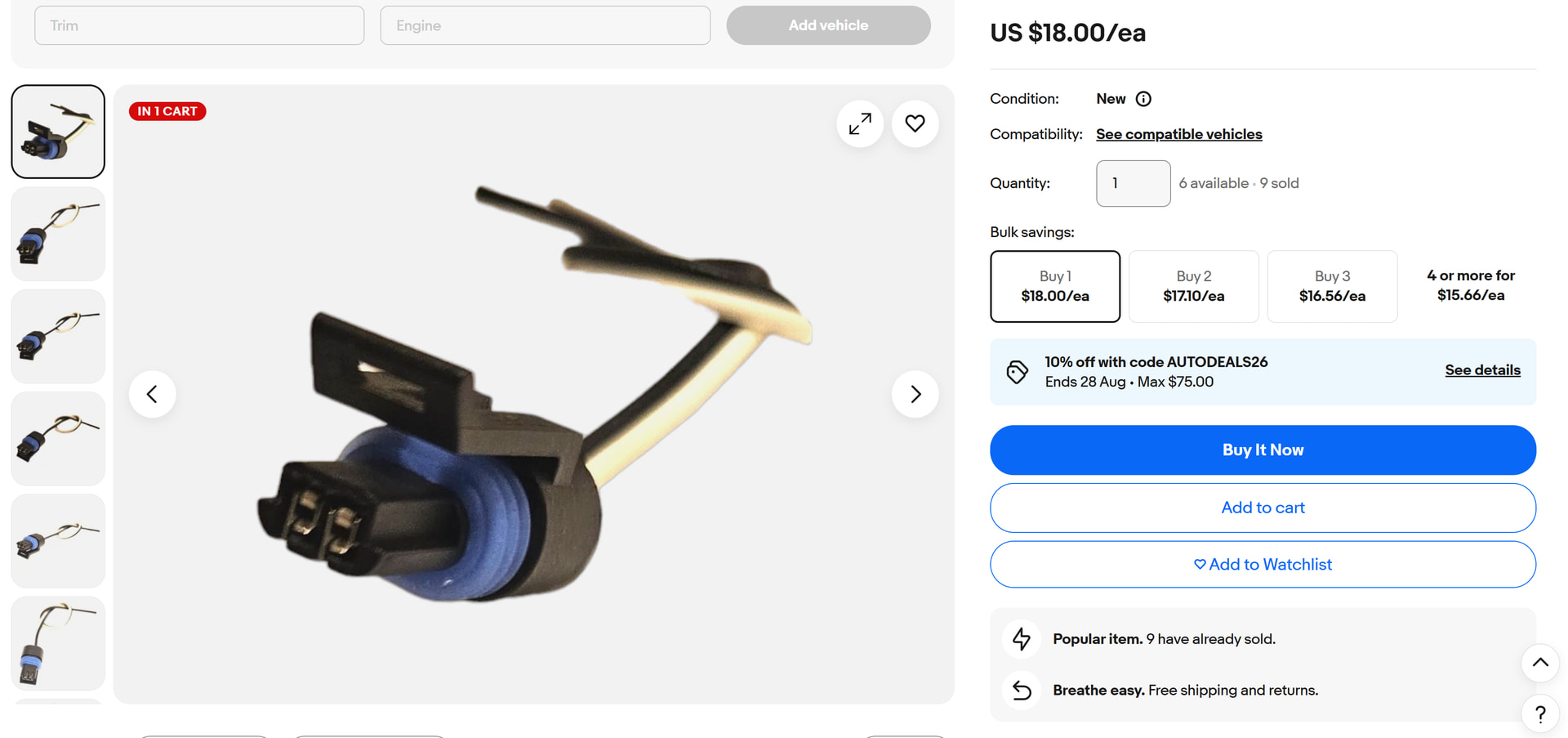

I just looked it up - it costs $18. Go ahead and buy one. Filament and 3D-printed parts aren’t suitable for safety-critical components in a car:
First of all, take a close look at the photo - the connections also have a rubber seal to make them watertight: “Durable weather-resistant construction prevents corrosion and electrical failure”

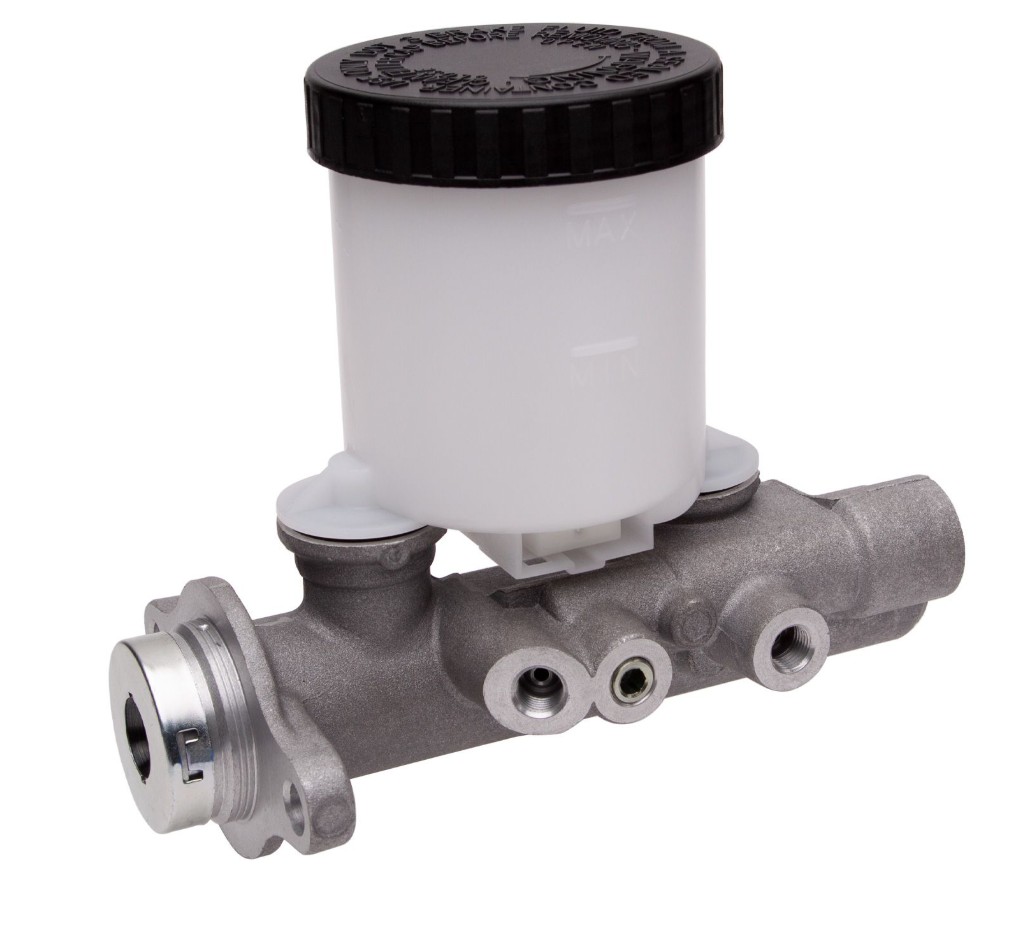

That connection is for a sensor to determine when the brake fluid is low. But I agree, just buy the correct replacement part if possible.

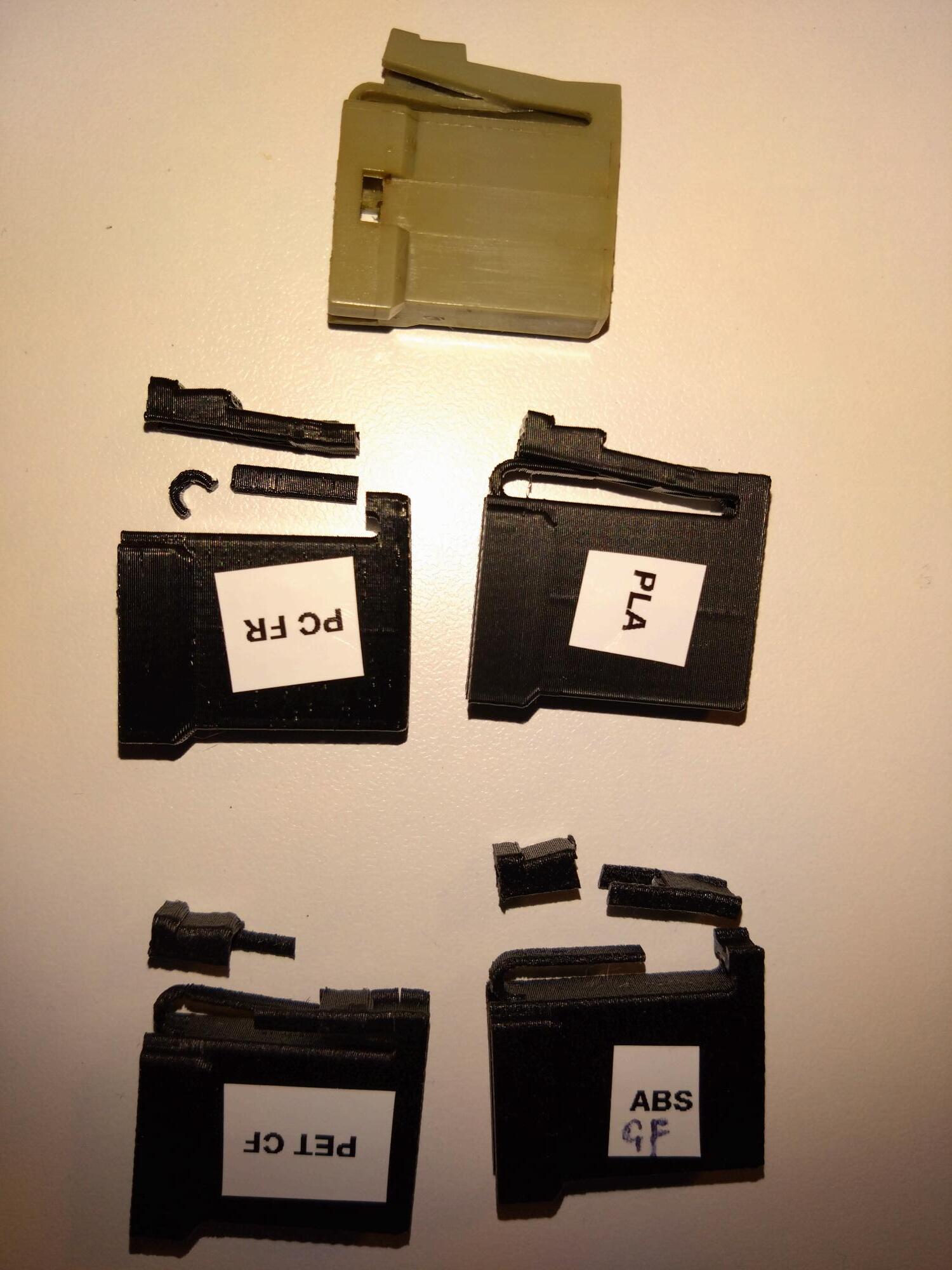

Here’s the troublemaker. OEM connector is at the top.
36 yrs old Nissan 300zx z32 and no connectors available. Only 2 wires, which indicate do you have enough brake fluid or not. I’ve tinkered this car last 22 years, so no hassle, we’re on the safe side in this :oncoming_fist:

There’s no rubber, just a dummy plastic piece with two elec connectors. No worries.
In that case if they are just like regular terminal connectors like spade or pin, and no seal is involved, and with no spares apparently available, the 3d printed should be ok if you can get a plastic that takes engine compartment heat.
This is a hobby. Anyways, under the tank is male, connector is female. What filament is flexible enough to take a minor bend? And please, besserwisser and haters, no more offtopic of safety or insurances. Just the filament, flexible enough? PAHT-CF?

If you’d like to emulate original, I’d suggest you try something like PVC filament. And it is somewhat flexible, probably moreso than what you’ve been trying to use.

It looks like all the prints are snapping on the layer lines, so I would change the print orientation to make the layers run along the length of the clip rather than the width. That might mean using supports, or a redesign to make the body fatter where you placed the labels.
PLA is not a good choice for under-hood use; it softens at relatively low temperatures. GF and CF filaments tend to be stiffer than their non-filled versions, so that may be part of the issue. From my own stock, I’d try PA, PC, or ASA.
