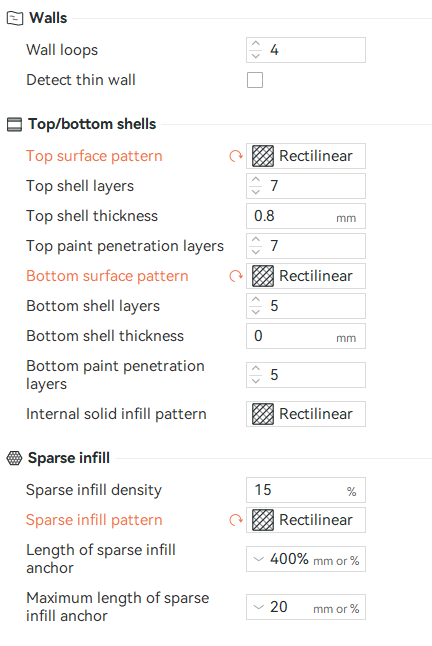

  • Others slicer settings: from default I only changed the surfaces pattern all to rectilinear for the strength of the print.

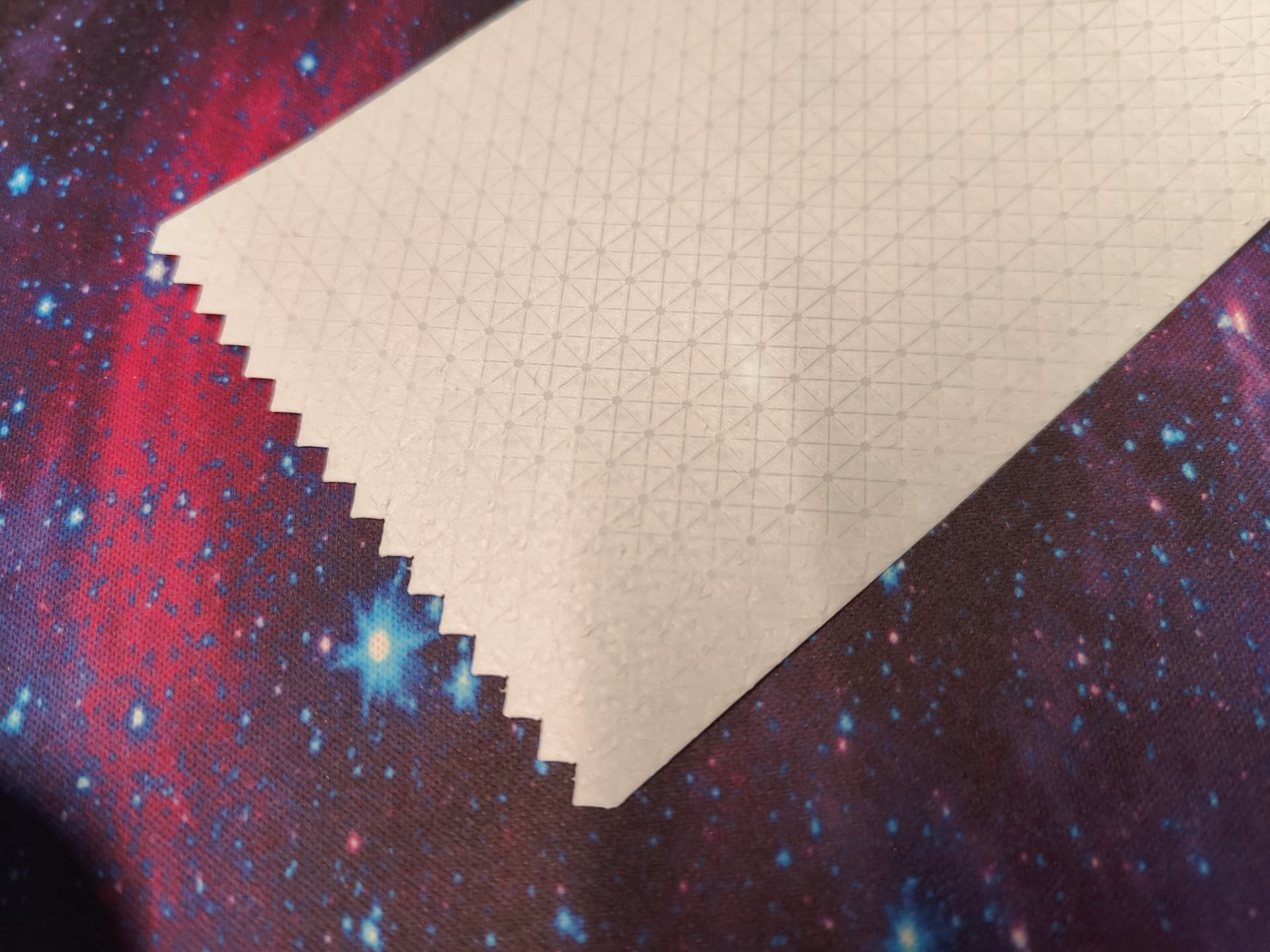

In the followin image you can see a print with sunlu pla normal with generic pla profile that i stopped mid print beacuse clearly was not doing well.
Yesterday I read different posts on this forum on similar issues and one of the suggestions was to increase the bed temperature so i did some tests today increasing the temp of the bed of 5° for each test and some results were promising since with a temperature of 80° the result was way better but still not perfect and going above the result was worse.
print with bed at 70°
If you look closely the border do not have the same definition as the center

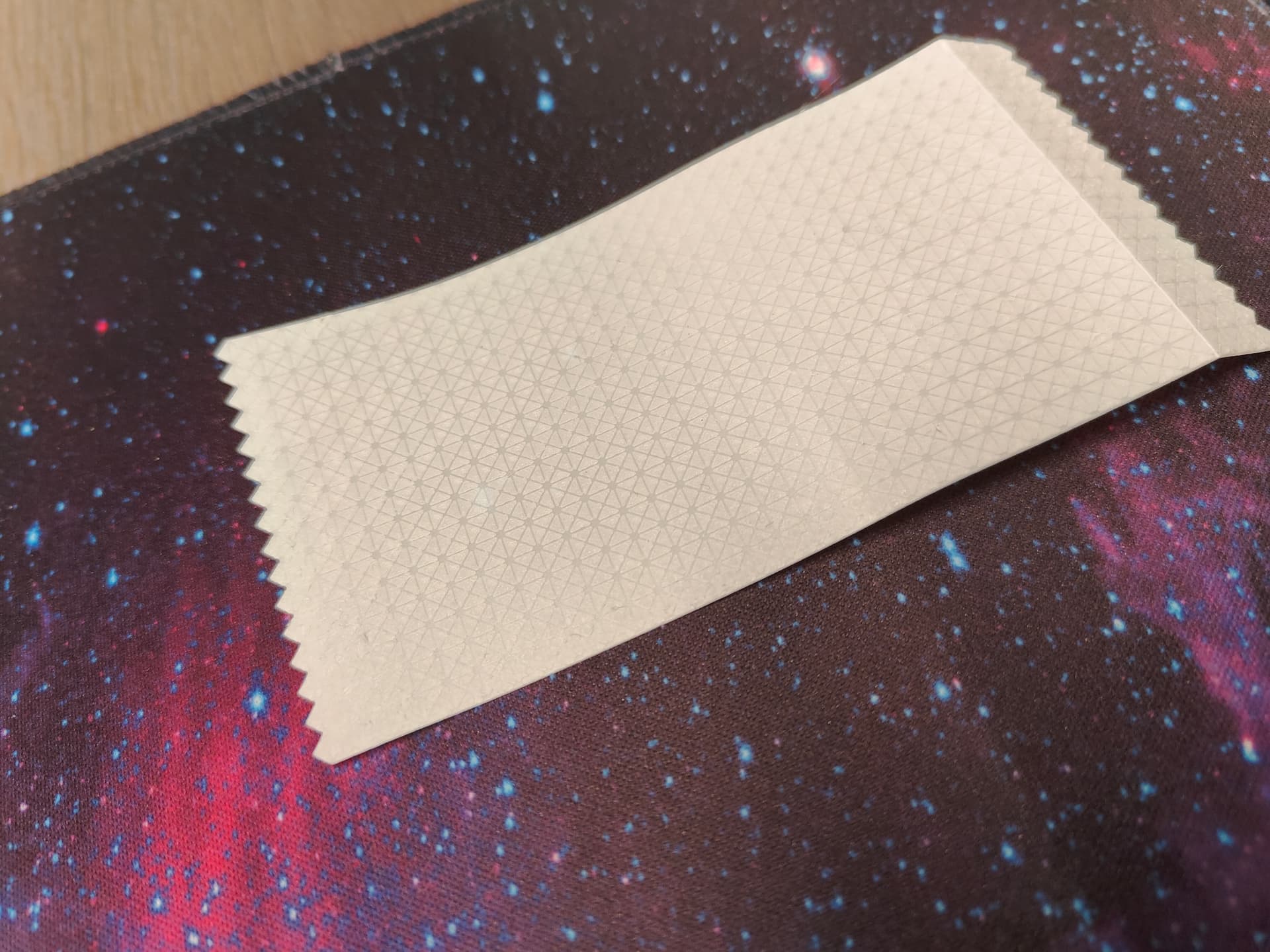

print with bed at 80°
Here the borders are way better but still not perfect

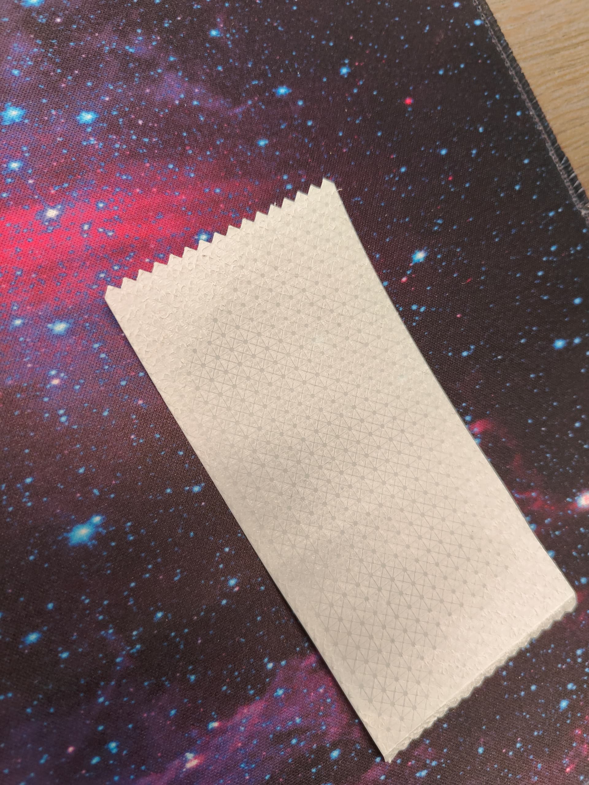

Then I tried the same model but scaled up (except for layer height that is still at 0.06mm per layer) with a bed temp at 80° but the result was bad as you may see in the following image

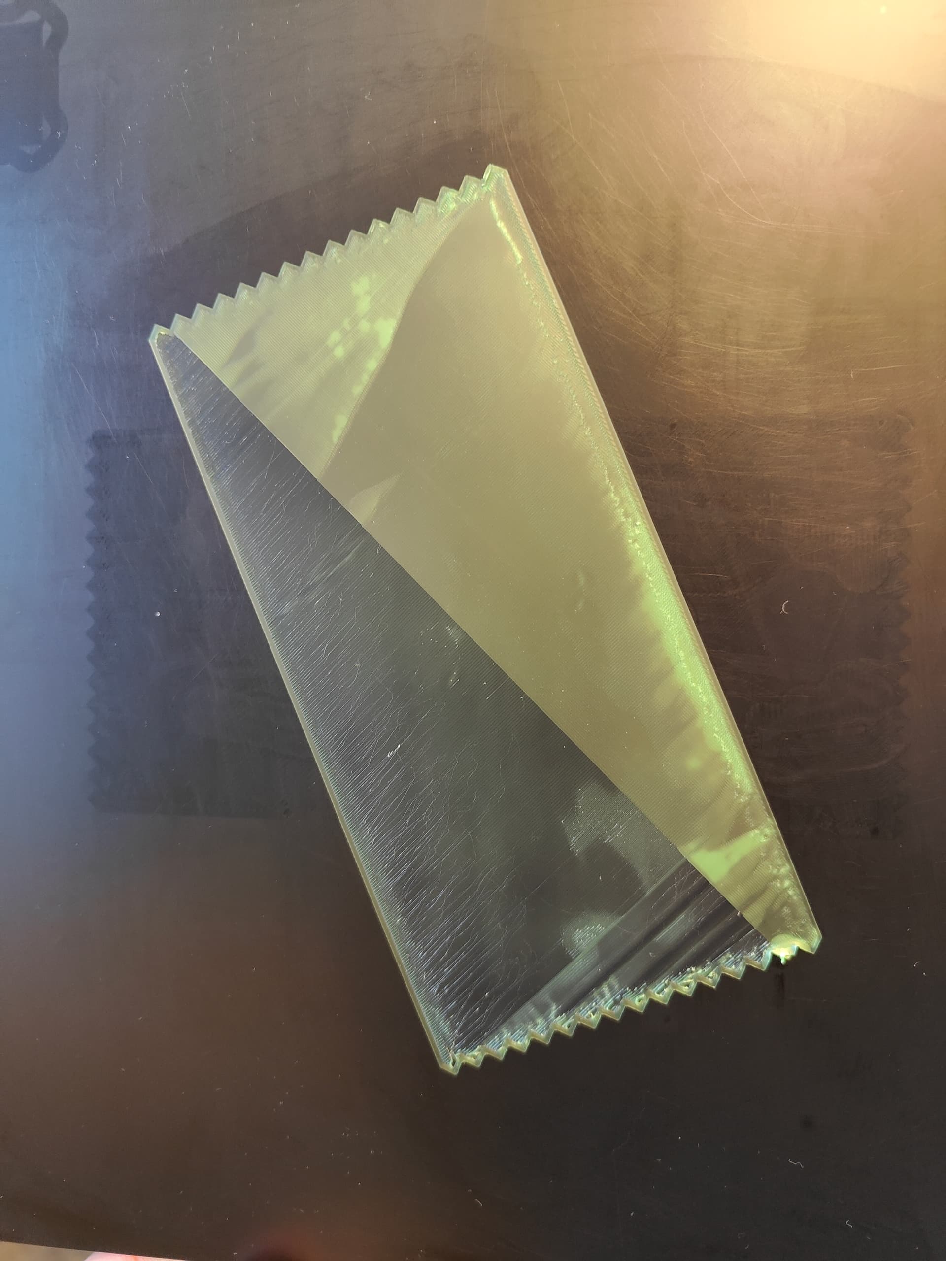

I did it!!!
The solution was to heat up the bed at 80° and also reduce the speed of the print, the result was pratically perfect for both bambu pla matte and sunlu pla matte… slightly better with the bambu filament but not relevant.
