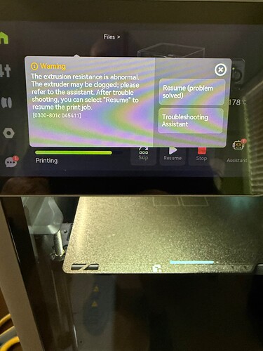

I just tried the external port and it’s now printing. I had to put a lot of force on the external filament inside the tube because it kept saying it wasn’t in far enough but then it finally worked. After this finishes I’m try the AMS again and attach a few pictures. On a good note from what I can see the test piece looks pretty nice. Appreciate the feedback. Here’s a picture of the error.
I also just had this error with the external filament so I moved the reel a little bit and it finished printing.

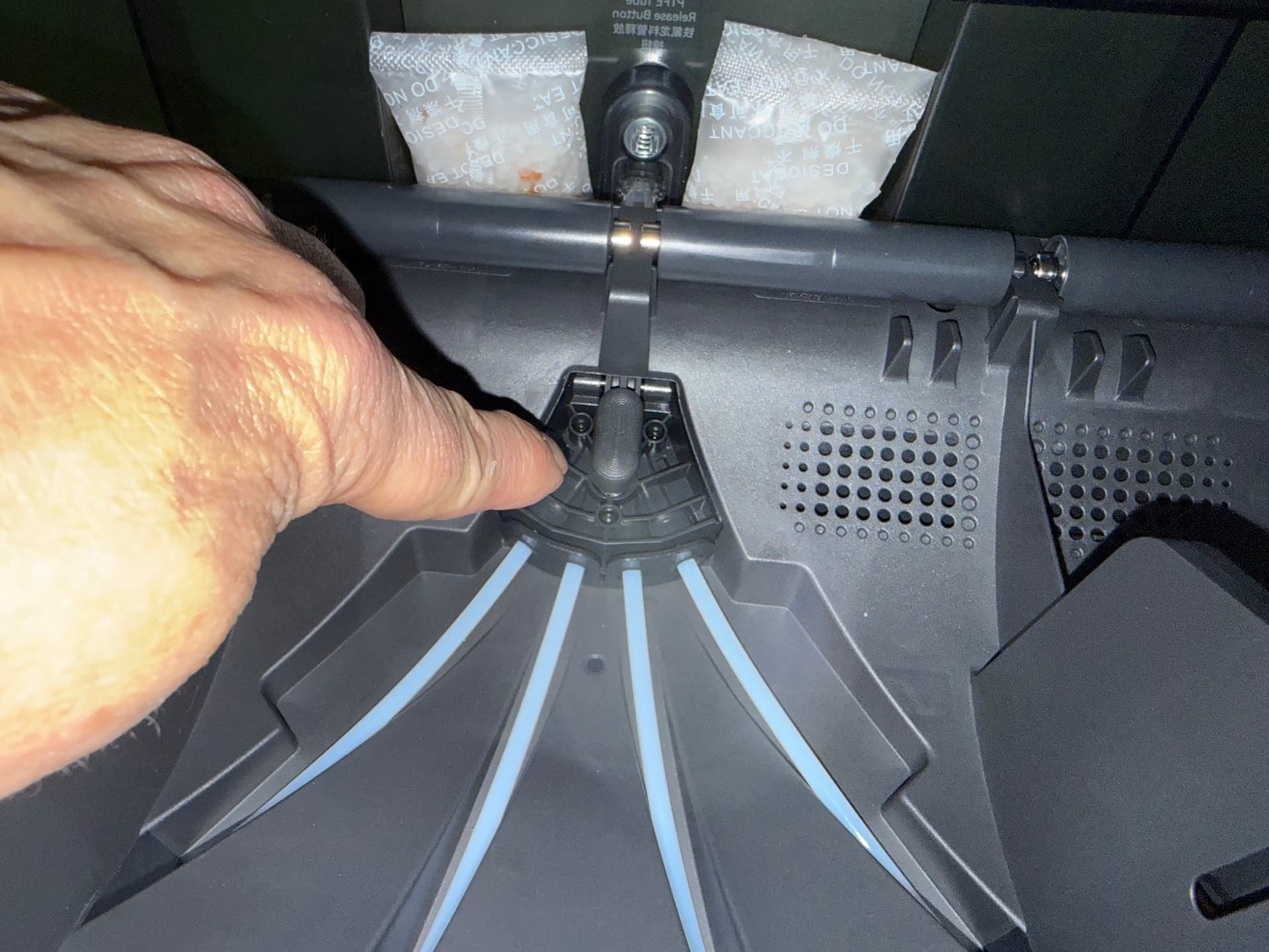

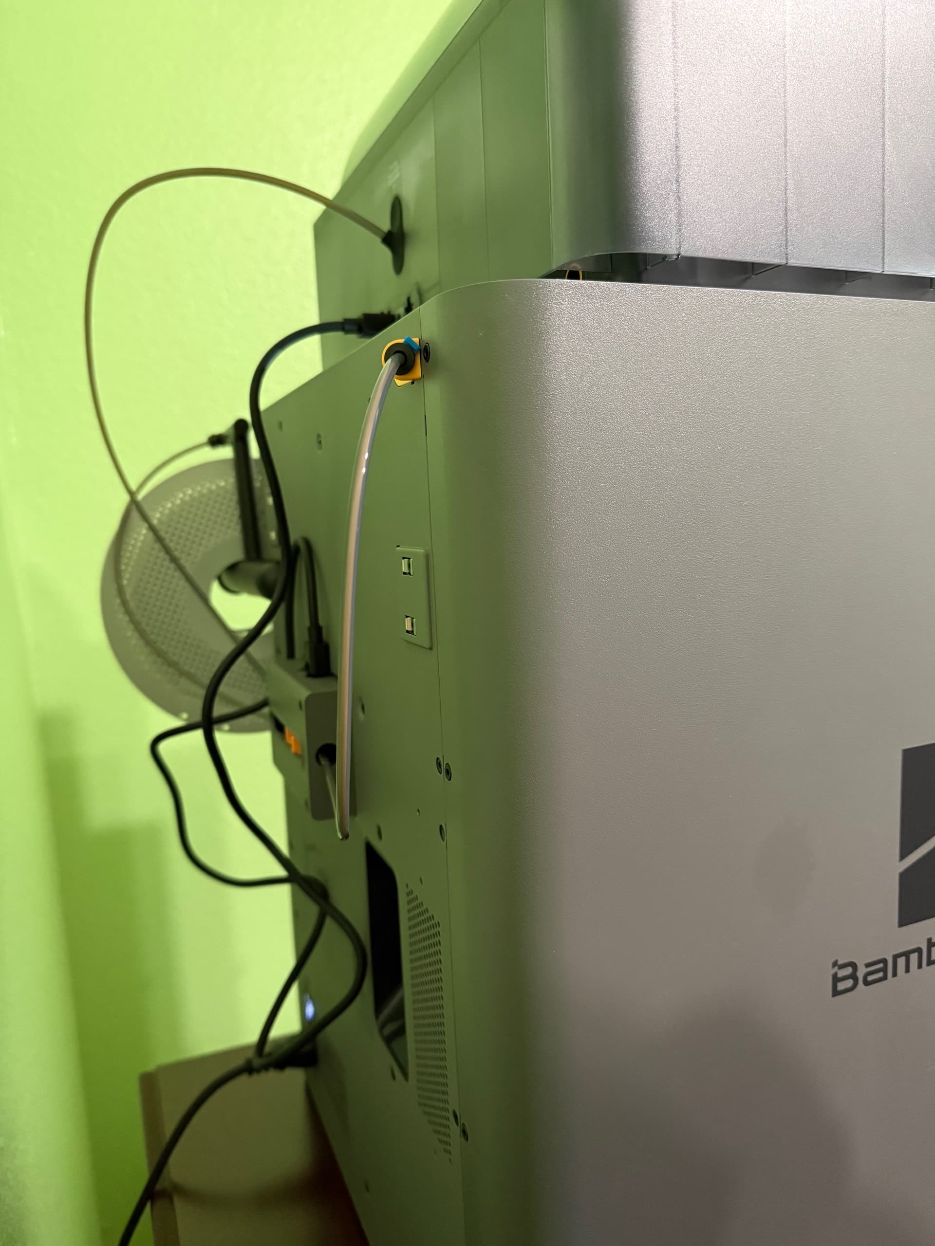

Ok the AMS won’t feed. If I press down on the button that I’m pointing to I can feed the filament all the way to the nozzle but when it tries to print it backs the spool up a little bit and then throws the error again. If I don’t press down on the button I can feel the filament stop at the back of the AMS and not go any further. Here’s a picture of the back also. The print from the external spool turned out great. Any suggestions would be appreciated.
I submitted a ticket this morning so we’ll see what happens. Not being able to talk to someone directly in tech support is a little frustrating.
There should be some resistance when you push the filament to the toolhead, but it should not require a lot of force. I’d pull the PTFE tubes from the printer and inspect the tubes themselves and their connections, they need to be snugged in their places. Also, no sharp bends on these tubes.
