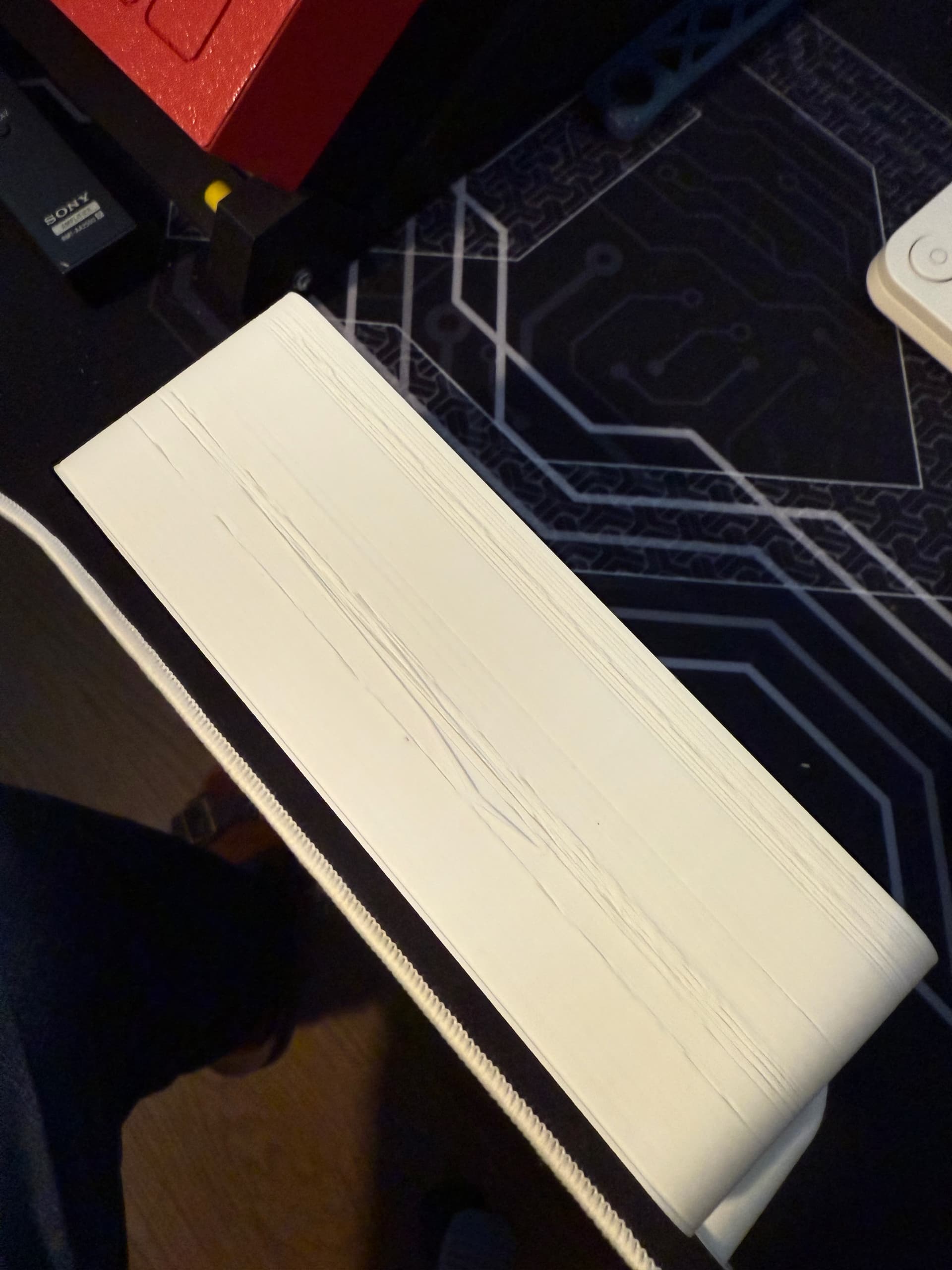

Printing with PLA i get the following result:
With PETG-CF it looks a bit worse, but pretty much the same problem.
I am pretty sure, it’s not wetness. So what can this be? Any hint welcome.

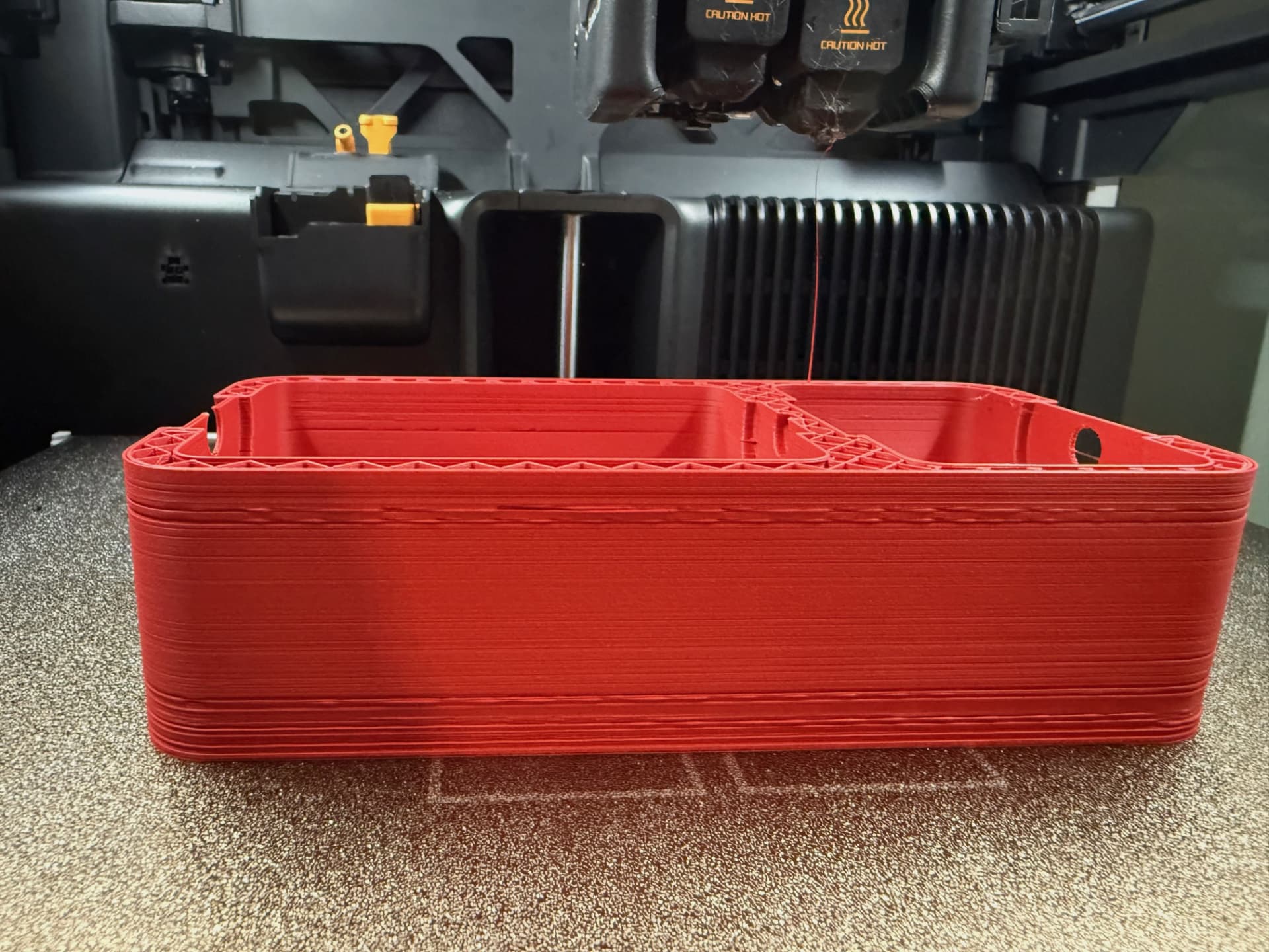

I did a lot of print testing and this is nozzle dependant. I dried all filaments another 12 hours, and then just printed with the same filament in the right nozzle, and then in the left nozzle.
The left nozzle prints perfectly, as expected. The right nozzle, no matter what filament i choose (in the picture it is PLA Matte in Red) exhibits this problem. I will exchange the nozzle to see if that fixes it.

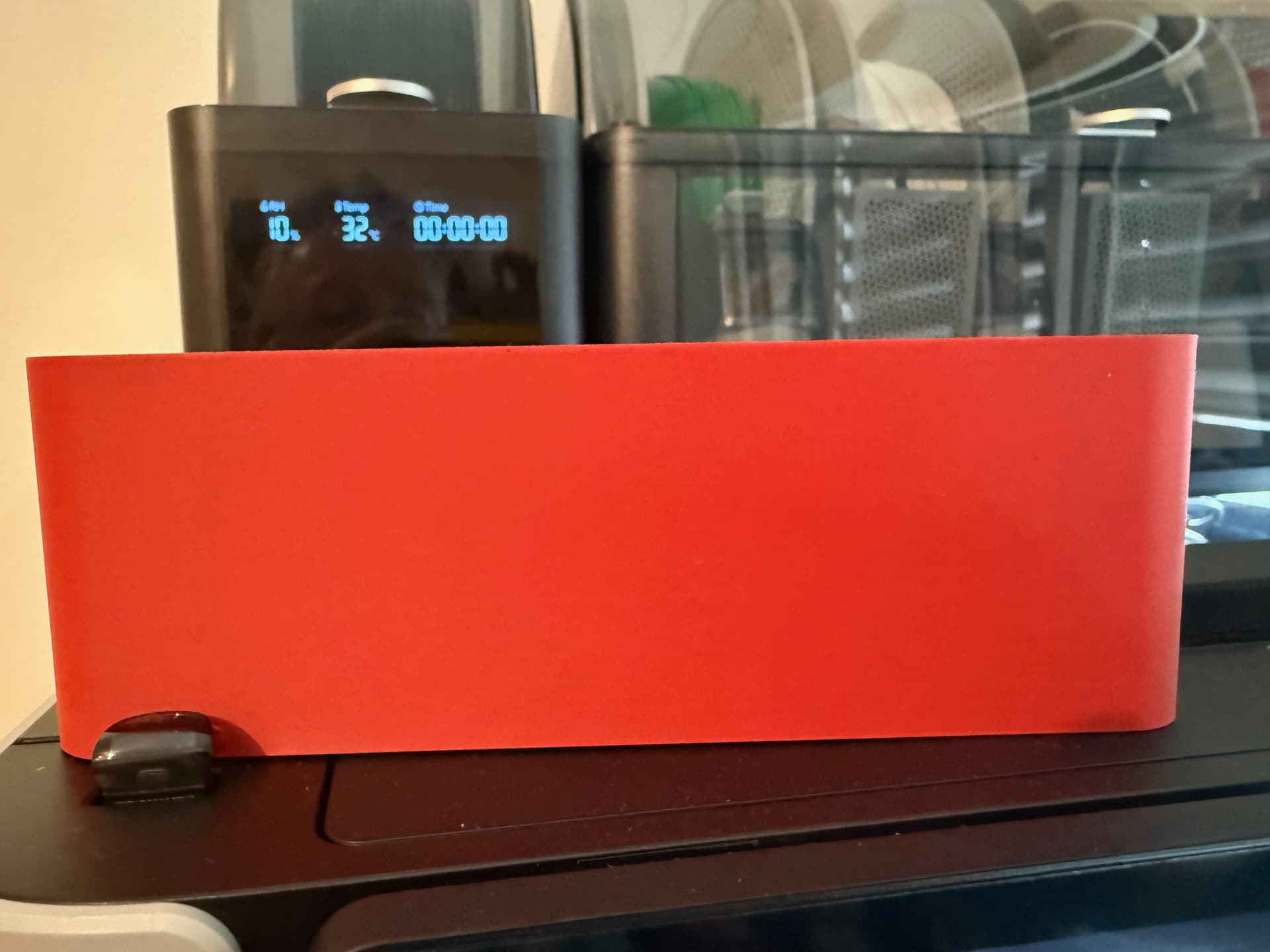

So, I replaced the nozzle and the current print is looking good so far.

Did you confirm that it was he nozzle? i.e. did the print end looking good?
Yes. Print looks perfect now.

The nozzle i replaced had a big flat pile of filament stuck at the bottom, that was probably the reason. I am going to try to clean it and see if the nozzle still works.
