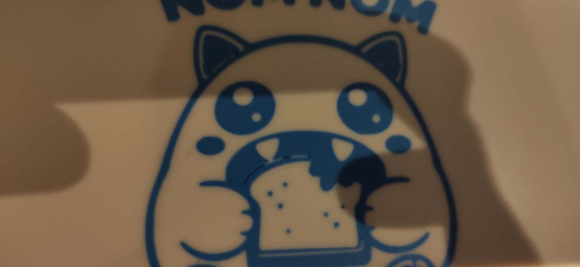

I’m trying to print a lunch box with my own svg image on it. Shows up fine in studio and the preview, but, as you can see in the pic below, once printed it leaves gaps in various places where the white line should continue (it’s not black, it’s actual open gaps with no material). How can I remedy this? X1C and I’m using the cool plate supertack.

You didn’t mention which nozzle you’re using? A 0.2 nozzle would be ideal for this, but judging by your photo, that doesn’t seem to be the problem. Otherwise, everything looks perfect. I just thought I’d mention it anyway. However, as mentioned, this could also be another factor that should not be overlooked.

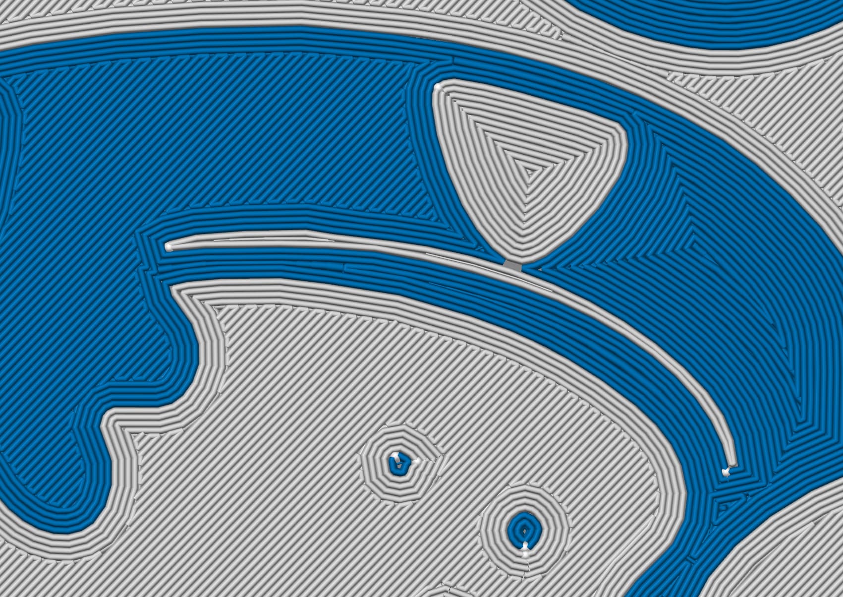

You can already see the error in the slicer, it’s already missing:

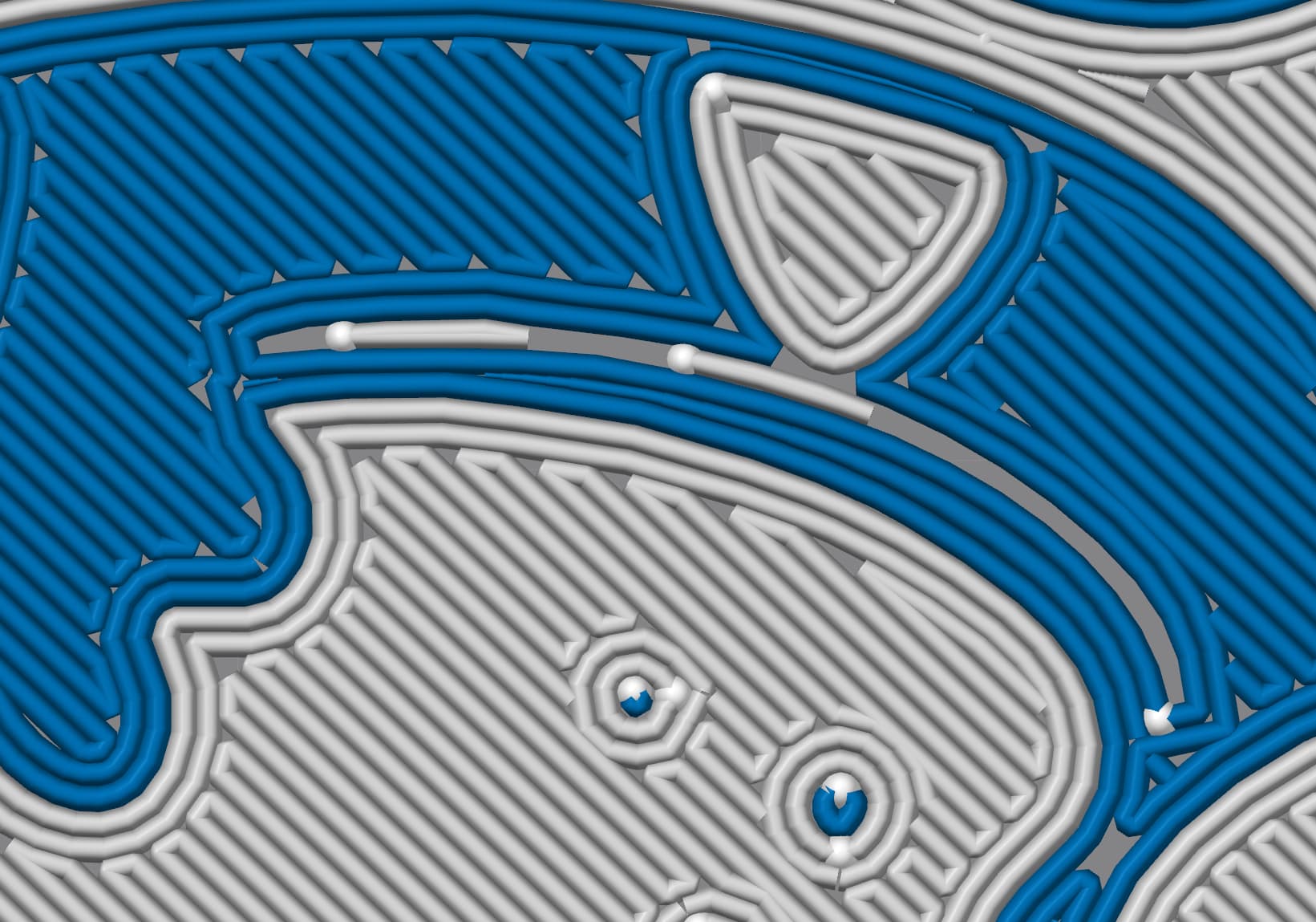

Either make the logo significantly larger or use a 0.2 nozzle. Here is the result with a 0.2 nozzle:
Ah I see, thanks for your help bud! Time to upgrade to a 0.2 nozzle :slightly_smiling_face:
If you haven’t already change wall type to Arachne and slice again to see the preview type shown in the provided screenshots.
Using this, the slicer will attempt to fill in areas that are hard to fill normally.
Also, try to take photos in more light without you be a shadow, the one you supplied is really difficult to work out what you meant,
