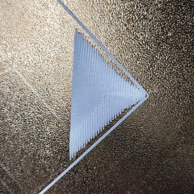

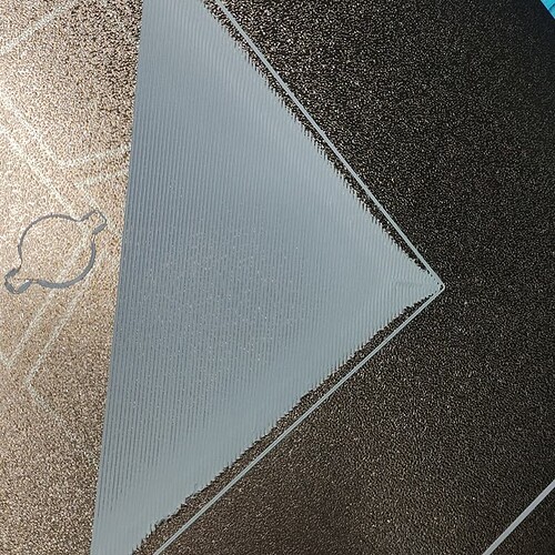

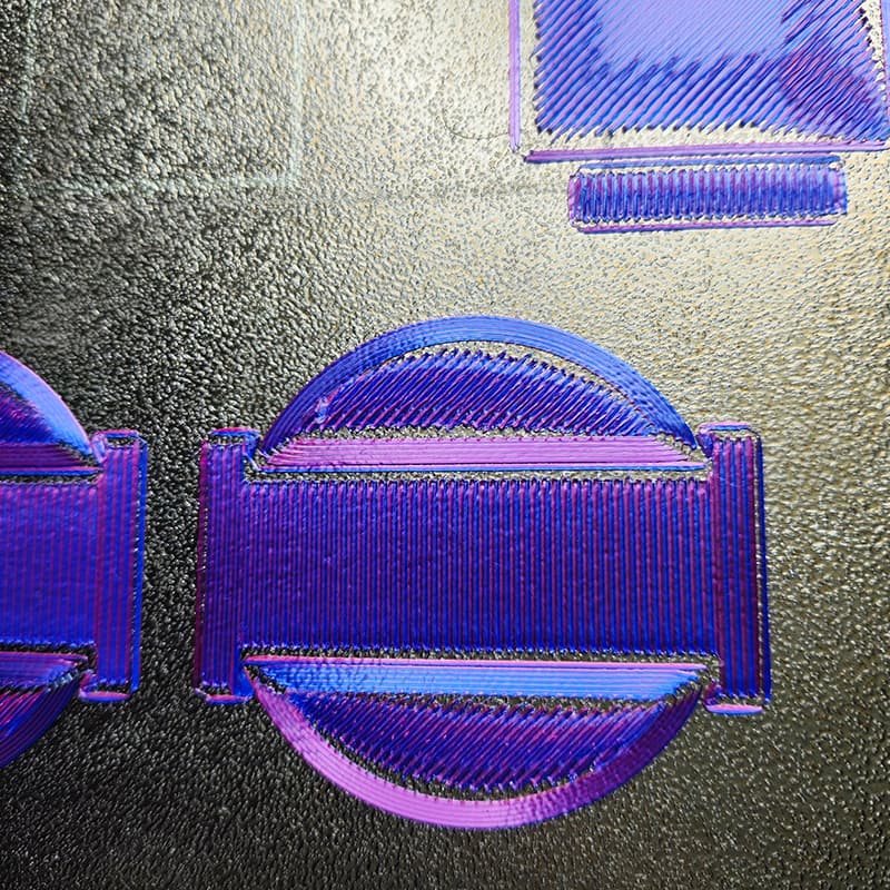

I have a P1S printer that I’ve been using without problems since May of this year. I always print with Bamboo PLA Basic.
Now I’ve run into a problem that’s driving me crazy.
I used a spool of PLA (which I assume was defective) and it jammed the extruder and the hotend.
I disassembled everything and cleaned it thoroughly, but it still wasn’t working properly. Finally, I opted to completely replace the extruder gears and thr hotend, and although it’s now extruding the filament, it’s not printing correctly: when it needs to fill a layer, the filament doesn’t reach the edge.
I’ve attached some photos so you can better understand what I’m trying to explain:
I’ve also tried new filament spools, other types of filament, a new textured PEI plate… Always the same result.
Can anyone help me with this problem?

Extremely inappropriate pressure advance (flow dynamics)?
Thanks for your reply.
I’m going to perform another calibration and I’ll post the results.
As @lkraus said, this is an issue with incorrect Factor K values. Check that the decimal point is in the correct place as this is a common pitfall.
A factory reset will clear this value if for some reason you can’t or haven’t adjusted it.
You’re both right.
In the last calibration, I mistakenly entered 0.3 instead of 0.03 (I omitted the zero after the decimal point).
I deleted the incorrect calibration profile, and it seems to be working correctly now.
