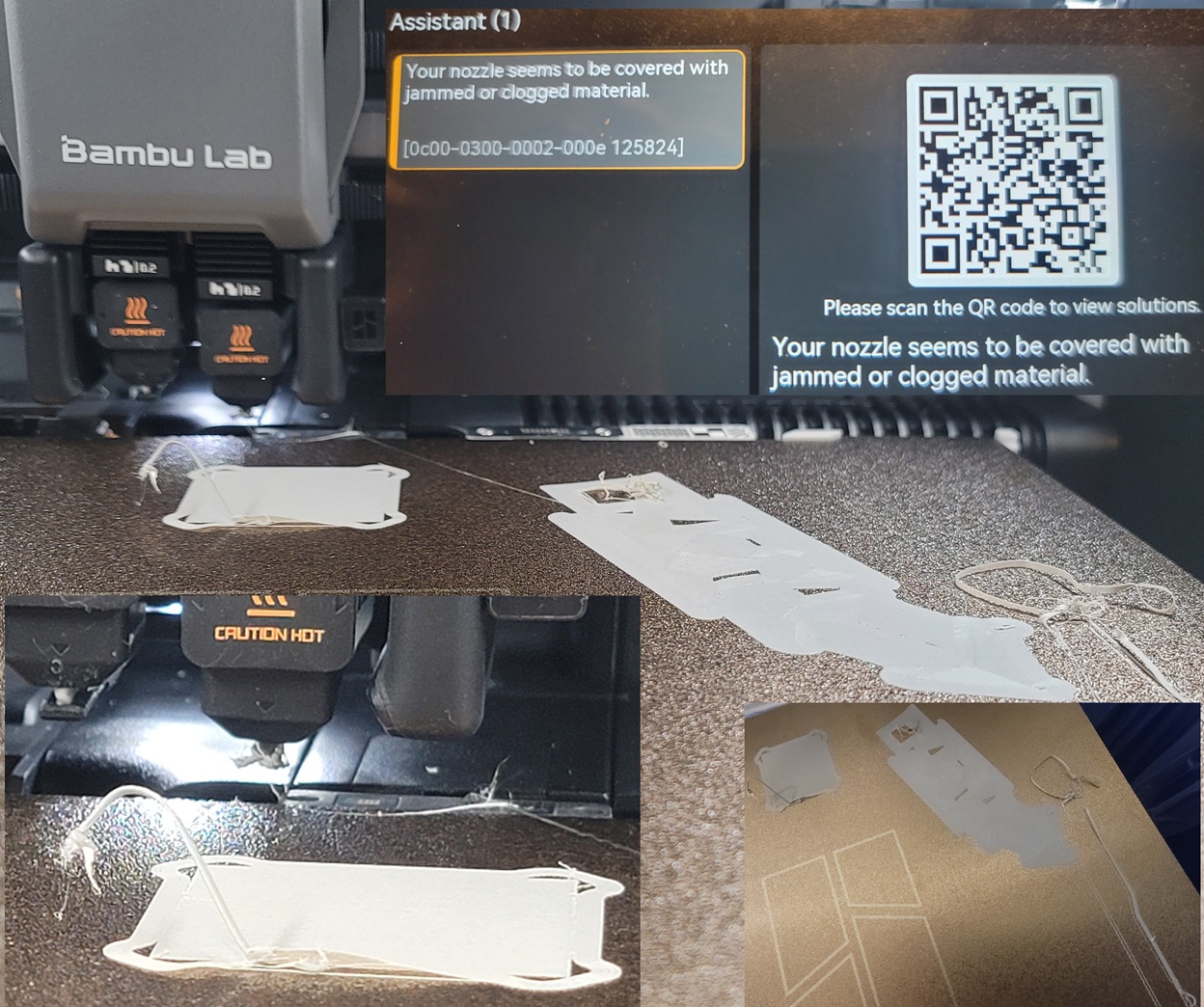

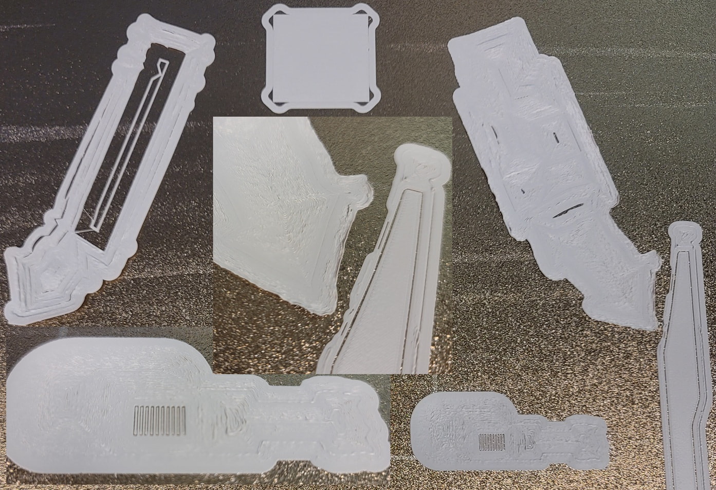

My first print attempt on new 0.2 nozzles errored out with extrusion motor overload after a couple hours. The filament was at 37% humidity, but I wanted to get a print out and was thinking about all the hobbyists out there with open frame printers and filament reels ‘hanging in the breeze’ and I went for it. Currently, I have to stop prints due to adhesion issues. Essentially new PEI textured plate, detergent washed, then Bambu Lab (BL) 3D Printing Adhesive added when washing didn’t help, very slight improvement. 20% RH in AMS-2 after 12 hr drying cycle. BL 0.08mm Extra Fine 0.2mm Nozzle process settings. All equipment has very low hours. Switched to 0.2mm 1st layer thickness from 0.1mm that lifted very fast. Longer runs lay down best, but fine detailed short movements get ‘ruffled’ and aren’t clean. All observations are watching first layer being put down. Glad to share more detail but need to get this started and move on for now. Thanks.

Hi CarbonForge, first off, thanks! Your offers are generous. Let’s start with the photos and take it from there. Please check my responses to other replies. The photos of ‘…Failure 2’ (F2) and ‘…Failure 3’ (F3) are montages with reduced resolution for posting. Glad to supply individuals at higher res. I messed with the first layer height once for the F3 result thinking that the first layer might be less apt to peel up. F2 was 0.1mm. After it did the prime tower base layer, the next area was already starting to peel up.

Unless you changed first layer temps, these pics looks like plate adhesion issues and a misidentification of the error.
Do definitely check filament moisture, clean the plate thoroughly (a clean stiff brush like those for fingernails work a treat) to get the grime out of the valleys and check 1st layer temps and height as @CarbonForge recommends.
To be safe, you can up 1st layer temps (only) for the bed (5°C) and nozzle (5-10°C). But this will not compensate for filament moisture and reduced plate adhesion due to residue trapped in the plate valleys.
The ‘…Failure 2a’ pics are 0.1mm first layer. The ‘…Failure 3a’ pics are 0.2mm.

The pics are a montages of 2 different failures, see their file names.

The first montage clearly shows areas of filament pulled off the textured PEI and residue on the nozzle.
The second montage has quite large areas with bad bed adhesion.
=> Best to 1st thoroughly clean the plate.
=> The 12h drying you did is usually enough but if the roll was new, it may actually require a bit more. AMS relative air humidity is unfortunately not a good indicator for filament moisture.
=> Another item we may need to consider is constrained feed (PTFE paths: I once painfully traced an extruder overload error back to a badly installed PTFE in the AMS. Also with a .2mm nozzle) and flow (residual material along the walls of the lower heat break of the hot end => cold pulls).
