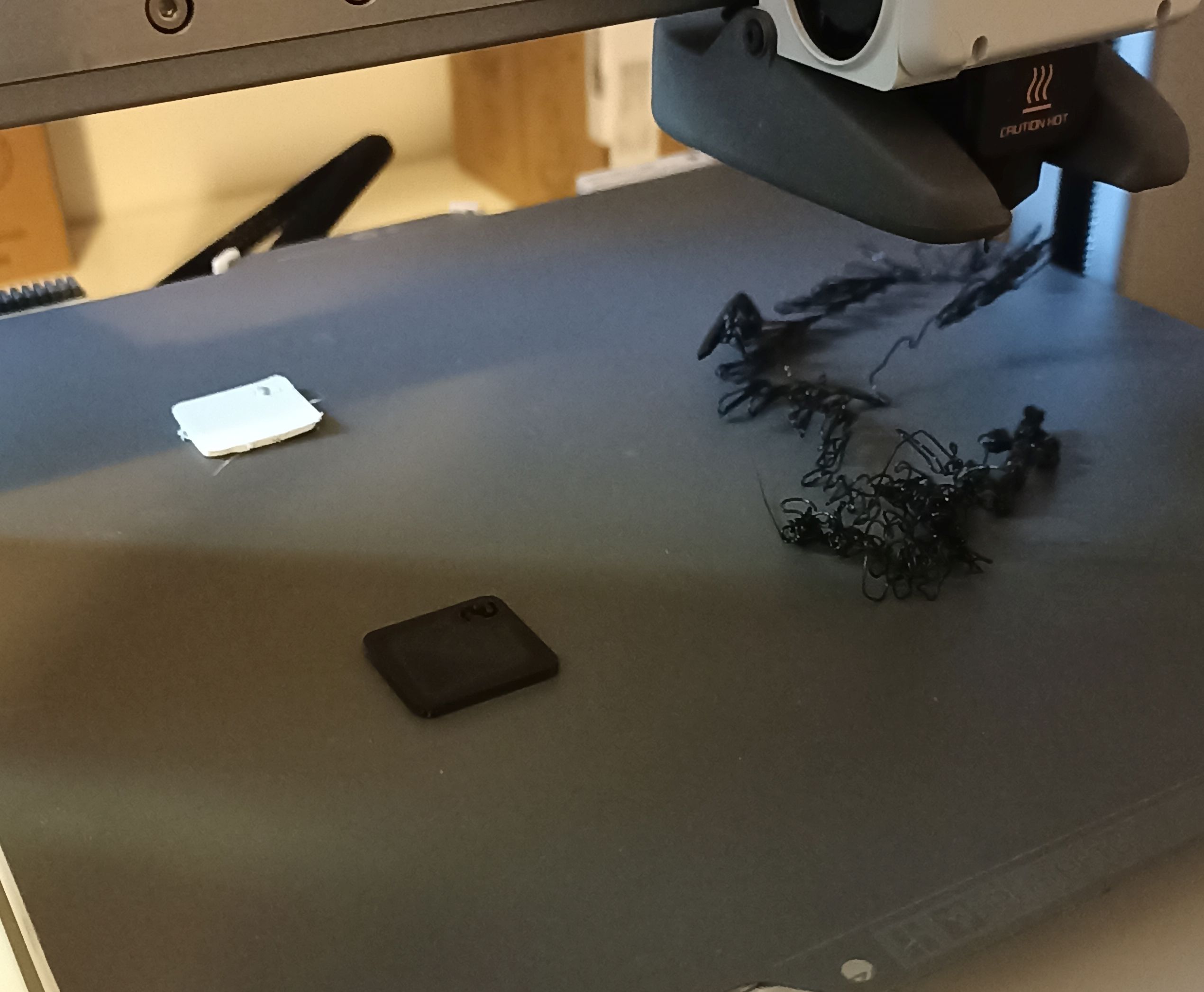

Having printed successfully with PLA for a few weeks, I’ve bought some basic PETG from Bambu, and am immediately having problems. Here is an example on the SuperTack plate:
The two squares are swatches - the black has printed quite well, albeit with deformities on the little S-shaped gap, but the white has lifted from the bed and has more artifacts on top. (A previous attempt at the white had it come fully off the bed and make a big mess while stuck to the nozzle.) The other black shape is a clip which seems to consistently fail; I cancelled the print before trying a white clip.
I suppose the models are not adhering to the plate, but I’ve not had that problem at all on the SuperTack plate with PLA. I did have that with the standard textured plate after many prints, but washing the plate and cleaning with IPA resolved it. I’ve tried the PETG on both plates and neither works - the black swatch on the SuperTack is the best I’ve had.
Filament settings are loaded by Bambu Studio for the Bambu PETG Basic preset: 255°C nozzle, 70°C bed. The PETG has come straight out of a sealed bag direct from Bambu so I’d be surprised if it had the wrong amount of moisture at this stage.
Are there other settings I should share, or other things to try? Thanks in advance!
Prepare to be surprised. Filament should never be considered dry from the packaging. It isn’t dried before packaging, it’s actually run through a water bath when it’s manufactured.
I’ve found cleaning with IPA cause adhesion problems. I stick to Dawn and hot water now.

Pretty sure Bambu says it has to be dried before using. I am not saying this is what your problem is.
I agree using IPA only to clean it is possible to just push the oil around and then the IPA evaporates and the oil is left. When using IPA to clean a part I use a spray bottle and flood the part so the IPA rinses the part of.
Lifting is due to air blew on the plate, either from the ambient or from the printhead. If it starts to blast 100% from first layers you bet it lift.

PETG is significantly more hygroscopic (moisture-absorbing) than PLA.

According to the datasheets, PETG actually has a lower Saturated Water Absorption Rate than PLA. However, PETG does react much more drastically to moisture than PLA. Adhesion, Oozing, Stringing, Warping, Curling,…
Furthermore, keep in mind that PETG is frequently used as an interface material for PLA due to the materials incompatibility. They really do not like to bond. So if there’s PLA residue or dust on the plate, even the usually very sticky PETG can get into trouble.

Update: I cleaned and re-cleaned the plates, with dish soap (again) and IPA (again), and finally the prints stayed still. I did then get a new issue with a wide PETG print that started lifting from the sides towards the end of the print, but I’ll start a new thread if that continues being a problem. Thanks all!

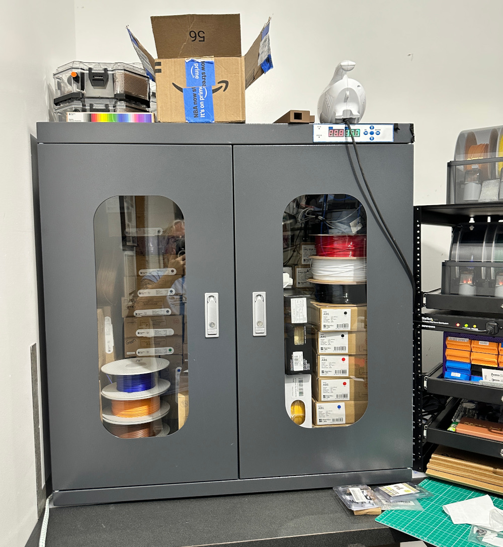

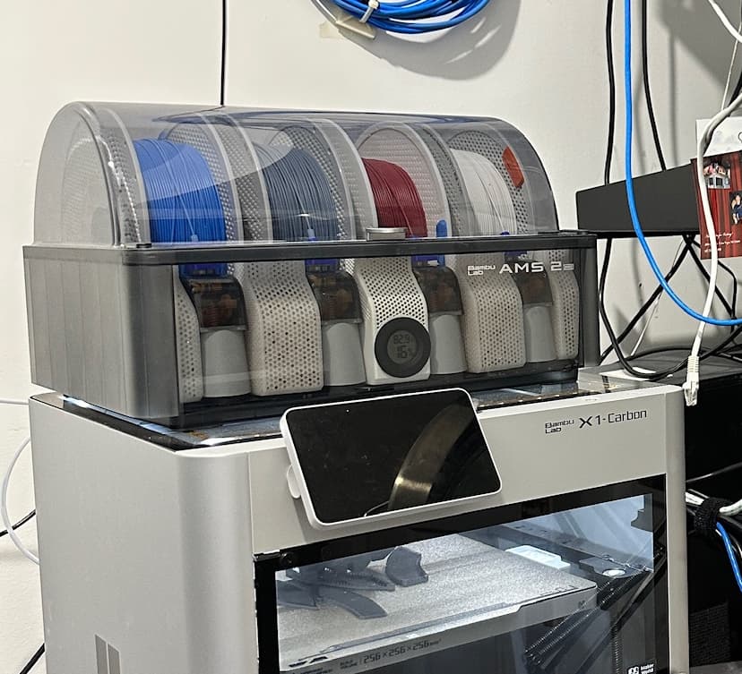

This is my dry cabinet. Bought it on Alibaba (could not find anything this dimension in US) $1000 to my door. I have it set to 15% RH and it can go lower (66 rolls in it so far). I also use Hygrometers in my AMS units. I don’t trust the Printers guess at RH. I also raise the bed temp form the default 70 degree C to 71 or 72 using eSun PETG and PTEG-HF. I’ve tried other brands that I had to throw out. It’s too bad that BL has almost to PETG selection. I’m not advocating anything here, just passing along what works for me.
