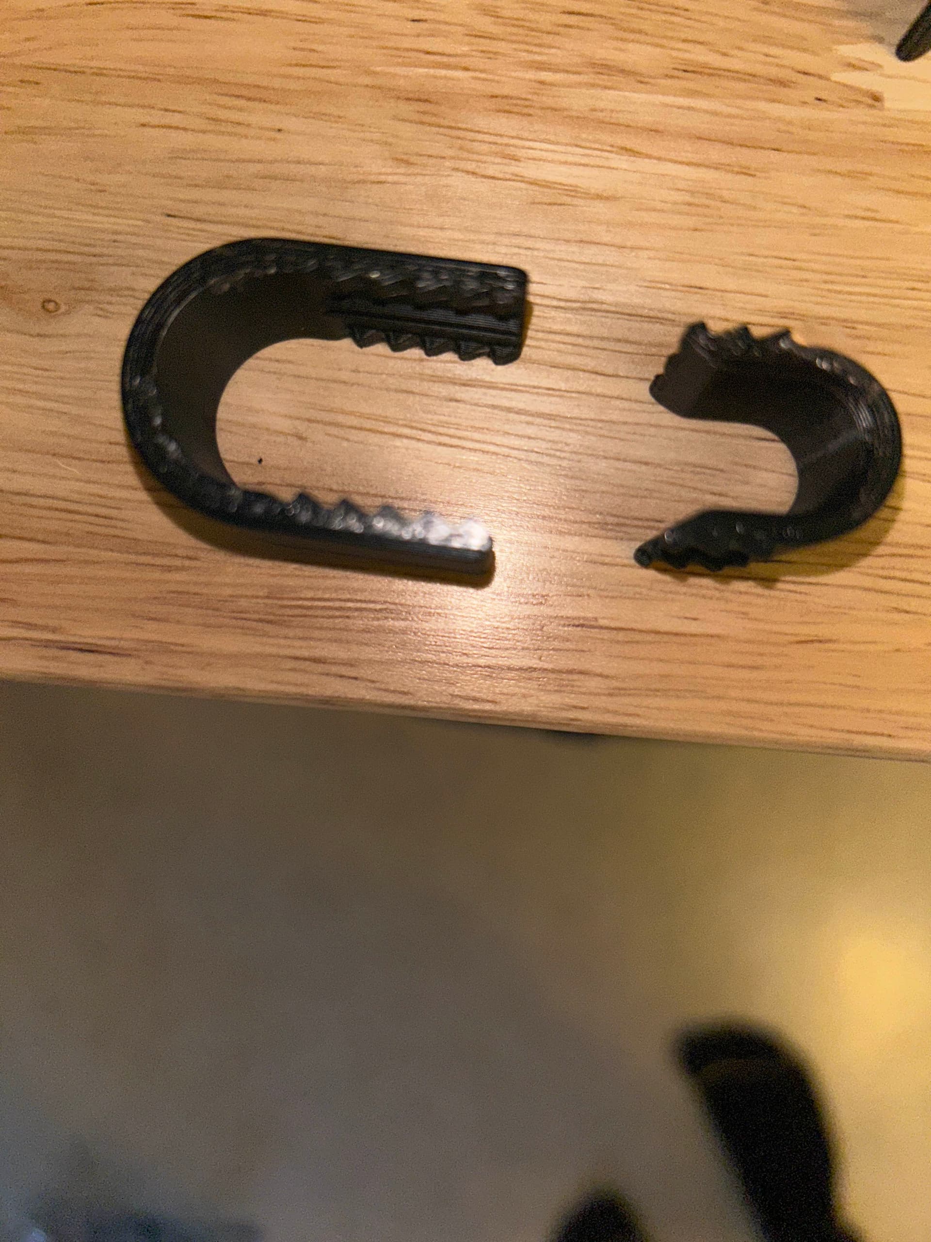

I’ve printed couple dozen jobs with pla, asa, tpu… no issues all acceptable prints.
I’ve been trying my first petg print.
Made 3 attempts all with same issue. First time I had only dried the nearly opened esun filament couple hours to 18%
I then dried it 8 more hours to 14%.
As the H2D has no setting for esun petg, I tried generic initially then the bambu petg basic.
.4 nozzle
Textured plate
The issue comes right off with the nozzle leaving little peaks. Some get knocked down by subsequent passes.
I’d love any help. I’d rather get some advice from those with experience than guessing.

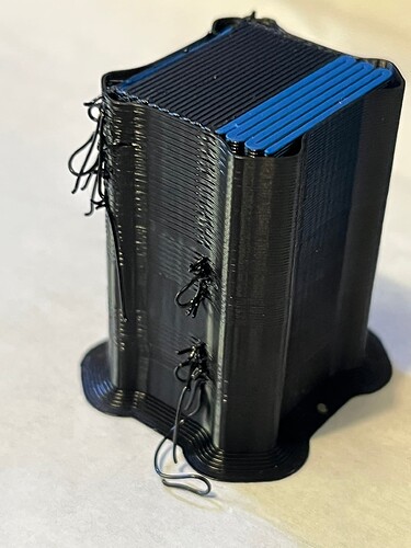

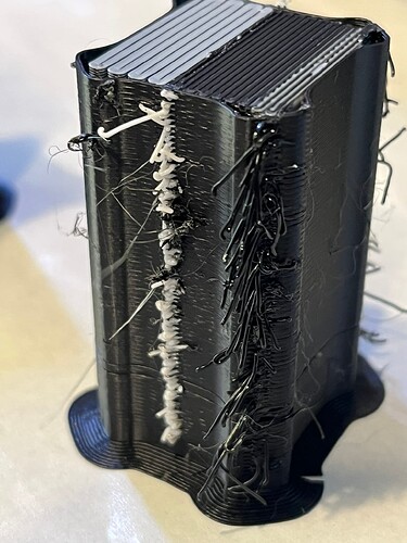

So after about a week of printing a mix of bambu PETG-HF and several other brands of both hispeed/hiflow, translucents, and regular petg, I have encountered the following issue.
While on single nozzle mode, the quality and whole print process is smooth.
When though, I print dual nozzle, theres big issue with oozing on the noozle, EVEN with the oozle blocker engaged.
Its so bad that the blocker gets stuck with petg and pulls it when changing nozzle, and makes something like cotton candy spagheties.
This is also evident on the prime tower which now looks like a christmass tree.
Moreover the oozle is so bad that it pushed the blocker and bent it downwards about 2MM which resulted in detaching the silicone nozzle wiper and flinged it across the chamber.

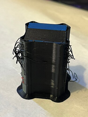

I mean… poor quality wouldnt really explain why the filament oozes pushing the filament blocker away from nozzle, while that nozzle is “idle” , this seems like a retraction+temp issue, but I havent managed to pin it down. BTW forgot to mention, this doesnt only happen in petg, but I noticed the same exact thing with ABS. PLUS my purge lines now look charred, all bubbly and …burned . If anyone has tried to vapor smooth asa and left it too long in too high temp will know what kind of look im talking about.
And its only while purging line prints that this happens, models look normal, quality is good, but im more concerned about the uncontrollable ooze while dualprinting , as it already has kicked the nozzle wiper twice off.
More over on my last print, which was single color on right nozzle, I noticed that the left nozzle oozed again, despite never being activated intentionally (remember it was a single color on the other nozzle) .
I am lost here, but im pretty sure that this much ooze is not normal .
PS , filaments are perfectly tuned, and dry.
