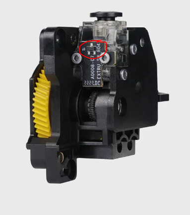

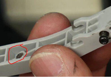

The filament sensor on the extruder also acts as the sensor for the cutting lever which has an inserted magnet to activate the sensor:
so there are following possibilities that I see:
The lever does not return to itâs starting position correctly, check the spring and the lever movement limiting screw for correct placement. Also check that the lever moves forth and back without binding when pushed manually.
Replace the Filament Cutter Lever | Bambu Lab Wiki
The sensor plug is not connected properly
The sensor or cable to the sensor is damaged
