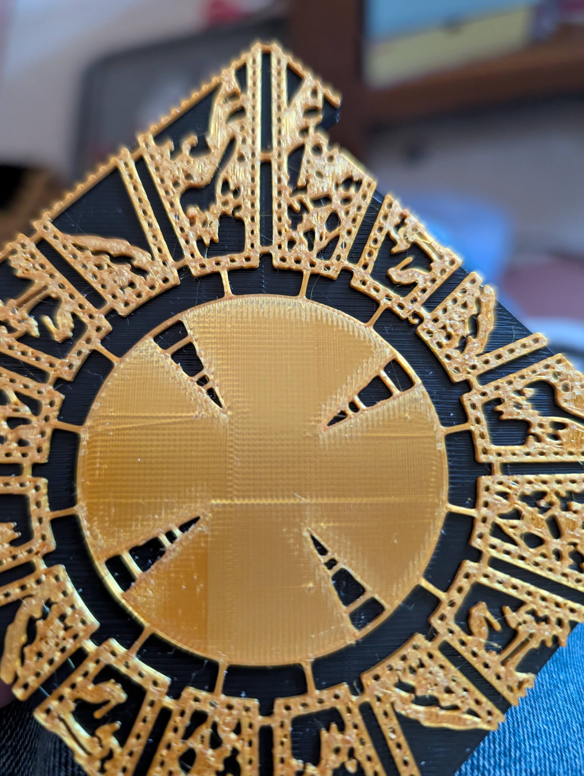

Problems with top layer quality on A1
Ive asked this elsewhere but asking here now as im not getting any useful advice elsewhere :slight_smile:
My top layers don’t look as good as they used to.
You can see the lines across the middle of this gold section.
I don’t want to use ironing … It was fine before.
I have already…
  • dried my filament.
  • tried different filament.
  • removed the screws behind the hot end then retightened
  • cleaned the bed very well
  • slowed down the speed of the print.
  • performed a full recalibration
  • ensured it levels and flow calibrates at start of print
  • prayed.
I will most definitely buy a coffee for the person who resolves this :slight_smile:
I see a lot of stringing. sure the filament is dry? Tried a different hotend (everyone should have a spare for troubleshooting)? Using the correct filament type settings?
