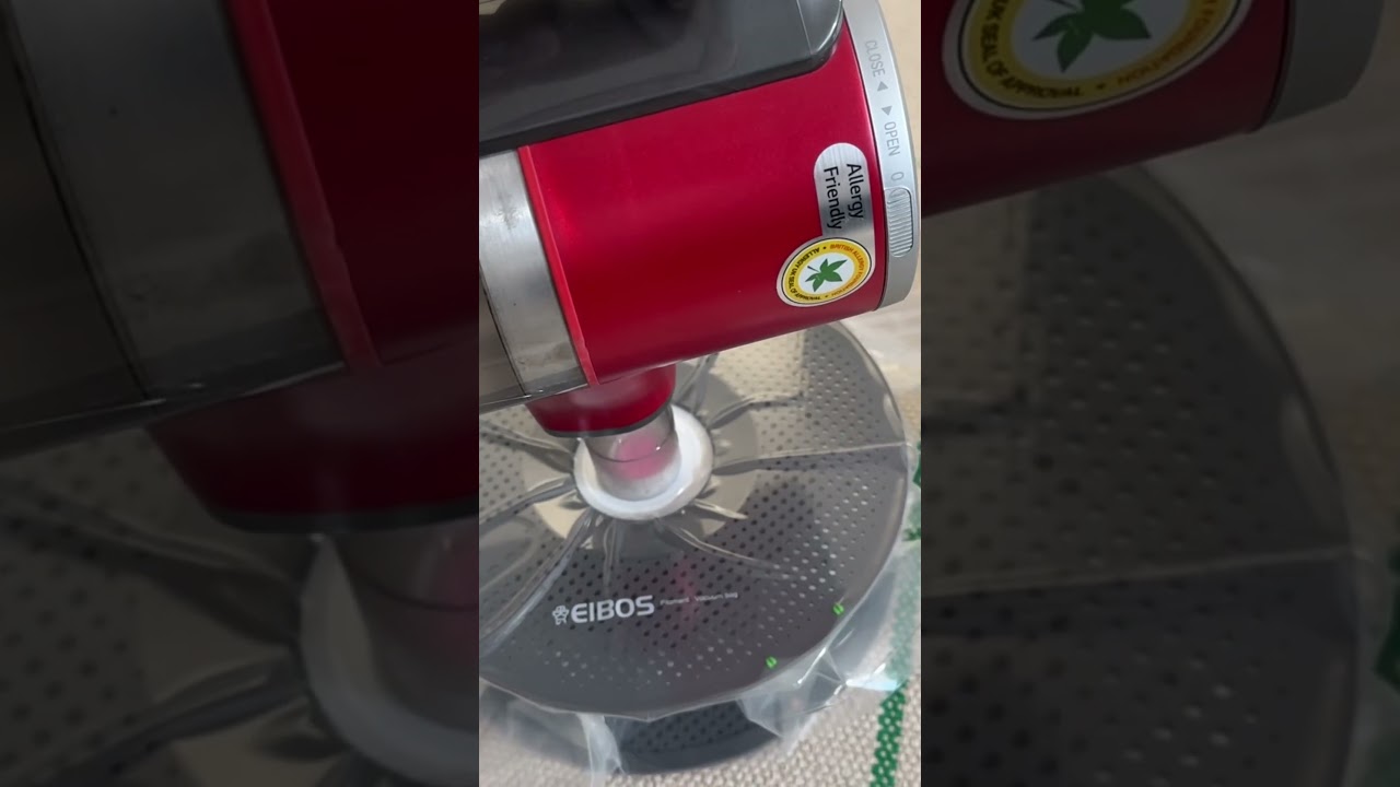

I got these ones which work with a vacuum cleaner in like 2 seconds, I made a short here:

That is so satisfying to watch… I worry my vac will suck the life out of the bags I have so I might try it with a different brand bag.
I got ones by Eibos, and compared to the ones I got on Amazon (it was Elegoo brand but I’m sure it’s a white label product), the bag itself is much thicker. Hope they last long. It also came with a USB pump but I didn’t try it. They sell just the bags too.

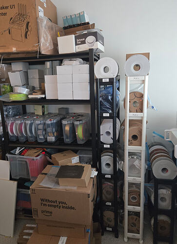

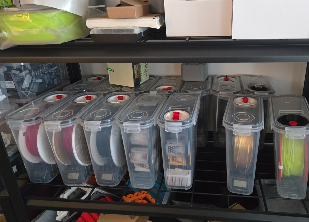

i use airtight food containers, becuase it’s a lot of hassle to keep using a vacuum.
I guess I should build a large dryer cabinet but it’s actually quite difficult to make a dehydrator that size.
Those containers are getting quiet expensive now… particularly the ones for individual spools… I have seen them at $25 each. The cheap ones at a big box store have a handle indented into them and don’t fit the spools.

10 bags $19. Even if you don’t vacuum out the air, it’d still be better than cereal boxes because there is less air volume. Plus they pack away flat.
I’ve been using an Anova Vacuum sealer the only downside has been the bags are single use. I’ve been looking for a good reusable bag. Thanks for the recommendation I just ordered a set to try them out.
Just to follow back up, these have been fantastic. Thanks again!
