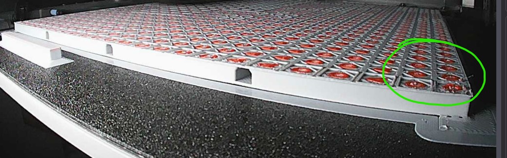

Problem Description:
I am facing printing difficulties: the first layers are perfect, but gradually, the layers flatten out until they are of very poor quality on the left side. I have already contacted Bambu Lab technical support via a ticket, which provided me with instructions to follow, but without success. I have conducted complete calibrations of the printer and filament, changed the print bed and filament, but with no conclusive result. The printer is just over a month old, so I am currently stuck. The support team does not seem to be very responsive.
Printer Model Used: Bambu Lab P1S
Slicing Settings Used:
  • Increased bed temperature to 65°C, added an outer border
  • Reduced speed of the first layer
Type of Filament Used: PLA
Picture:
its_a_bit_of_a_disaster.3mf (3,2 Mo)

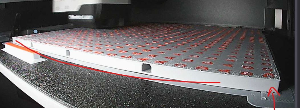

Hello and thank you for your response. As mentioned in my first message and as seen in the photos, I indeed have a raised edge all around, especially pronounced in the corners. To address this, I used a fairly standard infill for the print file. Initially, I thought the issue might be with the print bed. This is my seventh attempt, and I have been seeking help from support for five days without success. I have cleaned the print bed multiple times, applied glue, but to no avail. In the photos, you can see that I am using a brand new print bed received less than five hours ago. Furthermore, the print bed temperature is now higher than it was during my previous attempts. To rule out any filament issues, I also purchased new filament at the same time as the print bed, five hours ago. I have successfully printed medium-sized objects without any issues, but this large print is facing major challenges. I would like to add that the print is not detaching from the print bed at all; it is well adhered.
Here is a photo of the progress; it is becoming increasingly compressed, yet everything remains well stuck without any issues.

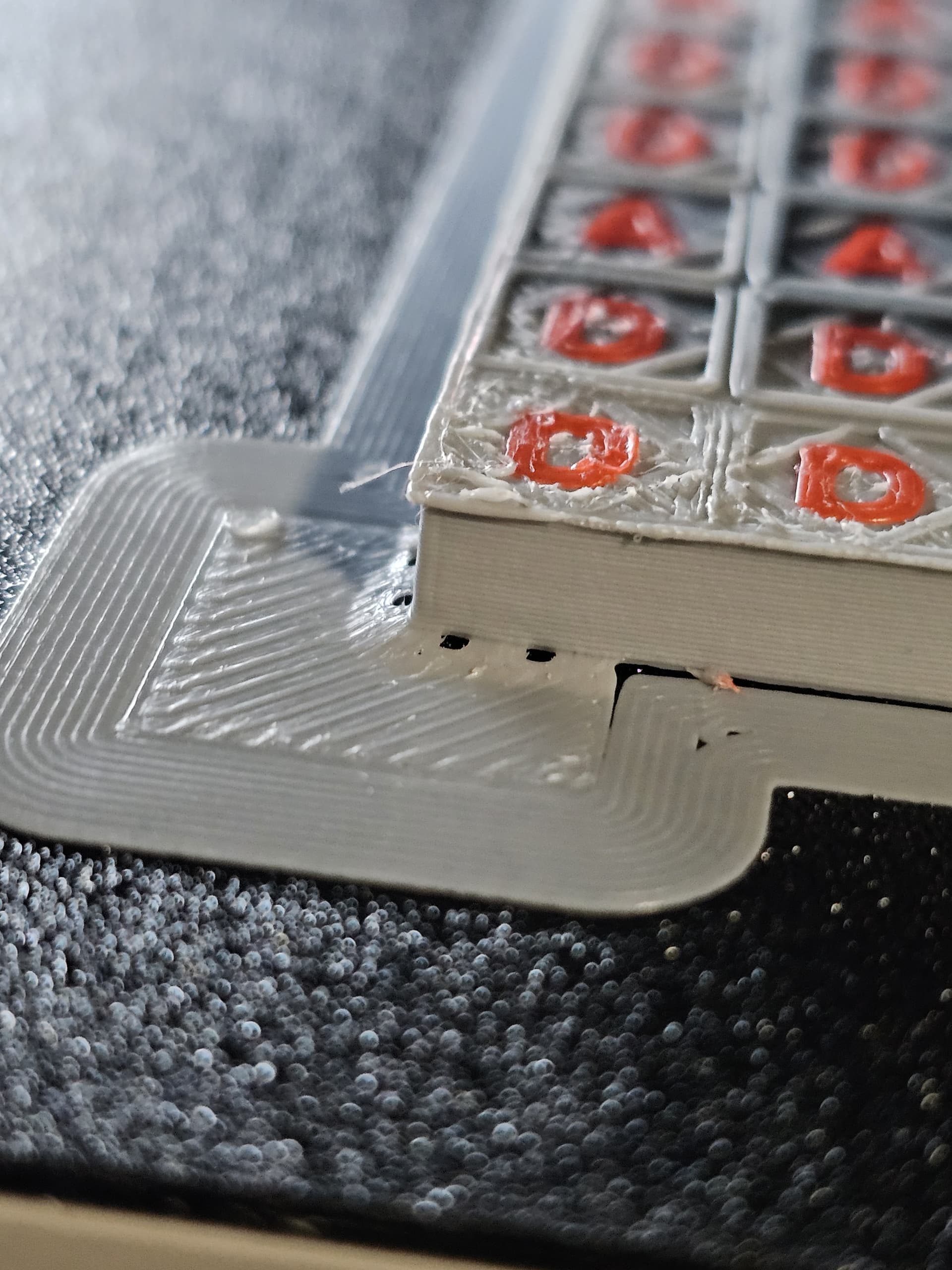

Upon closer inspection, it is unlikely but indeed the print is detaching for the seventh time despite various different parameters, including having a border. Do you have any advice to prevent this issue in the future? You can see the result in the photo.
I am reprinting using a much closer or even glued contour, I have added a lot more glue. Besides that, I am undecided about the next steps to take.

Hello, thank you for your response. I will try your advice. To be honest, after 7 failed attempts, I cleaned the original plate with a brush and soap, but it was still the same. So, I even ran it through the dishwasher for an hour, which convinces me it’s clean.
I’ve tried multiple filaments, and the issue only happens with this BIG print.
I raised the temperature by 10°C following the previous issue, always keeping the door and lid closed.
Currently, I’m printing with a 0.05mm brim, and in some places, it literally touches the piece. If that doesn’t help, I’ll switch to a 0mm brim.

Warping happens due to the shrinkage of warm layers being deposited on cooler layers. While that is a percentage, a percentage of a large number gives a more significant shrink than a percentage of a small number. So the bigger the print, the worse the problem.
It may come as a surprise, but that is the much improved customer service. When my X1 died earlier this year, it took 5 months to resolve. But in the end, I got a replacement under warranty.
This issue is different though as there are limits to the technology. Without a heated chamber, there’ll always be warping.
That should help slightly, but do not forget that you did that as it may affect your next filament calibration result.
Now this may be important as there’s one point I forgot to mention: I get slightly better bed adhesion with the Smooth PEI using a very thin coat of PVA glue (apply glue stick, use a moist to wet paper towel to create a thin film, let dry).
Also give the lower layer height a go as it helped me many times where curling destroyed my prints.
With hot layers cooling on colder layers being the root cause for warping and curling, you want to have as even a cooling as possible. However, you only need to cool in each layer what was actually put into the print in terms of heat. Since heat input is linked to volume deposited, a halving of the layer height reduces the heat input per layer by a factor of 8. Takes longer, but you have a better chance of actually getting a good print.
