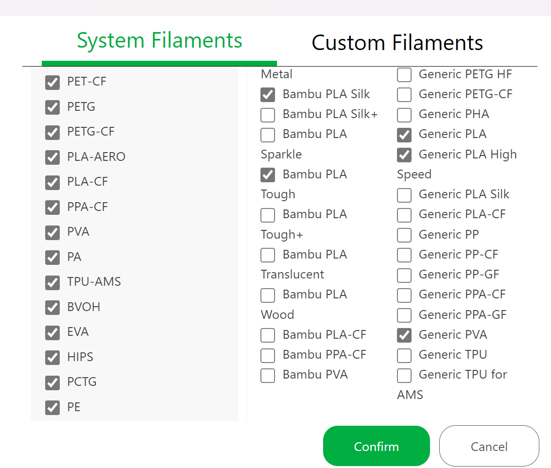

But the problem is still with Selection of the Project Filaments. As you can see on the picture below it shows only A1 Printer.

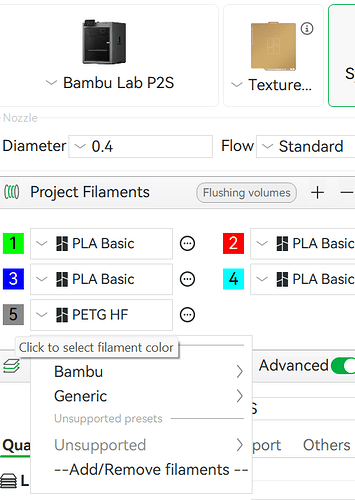

When I try to change filament for example in slot 5 - see picture below - I only get two options for P2S - Bamu and Generic. There is no way to select other Filaments. I want to use Sunlu.
And, by the way, the printer itself (on the touch screen) has only those 2 filament available. Not like A1.
Clicking on “Add Filaments” open the screen with Project Filaments and only A1 printer. So I can’t change/add anything.

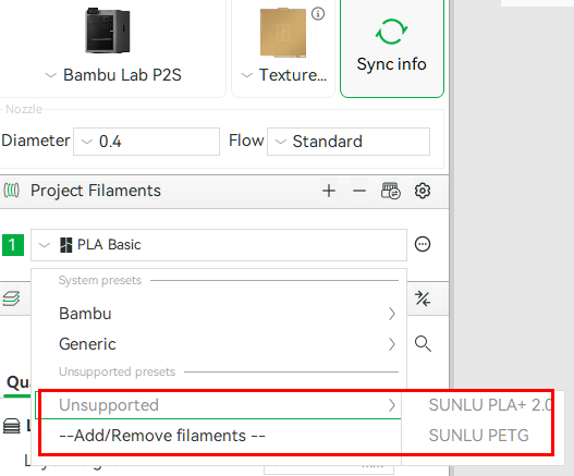

But the problem with Sunlu (and other vendors) filaments can’t be solved. See the picture below.
So I spent $1000 on a new (new design) printer and it only supports Bambu and Generic filaments?
I know I can set printing parameters or create custom filament parameters, but why do I have to do it when the printer that I bought a year ago didn’t have this issue?
I wish I knew it before I purchased it.
I wonder if all other printers have the same options with selection of filament vendors - Bambu and Generic?

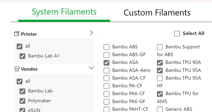

What do you see when you click on the gear in the Project Filaments section?
This is what I see:
When I deselect A1 printer, all other filaments are gone - except for Bambu and Generic

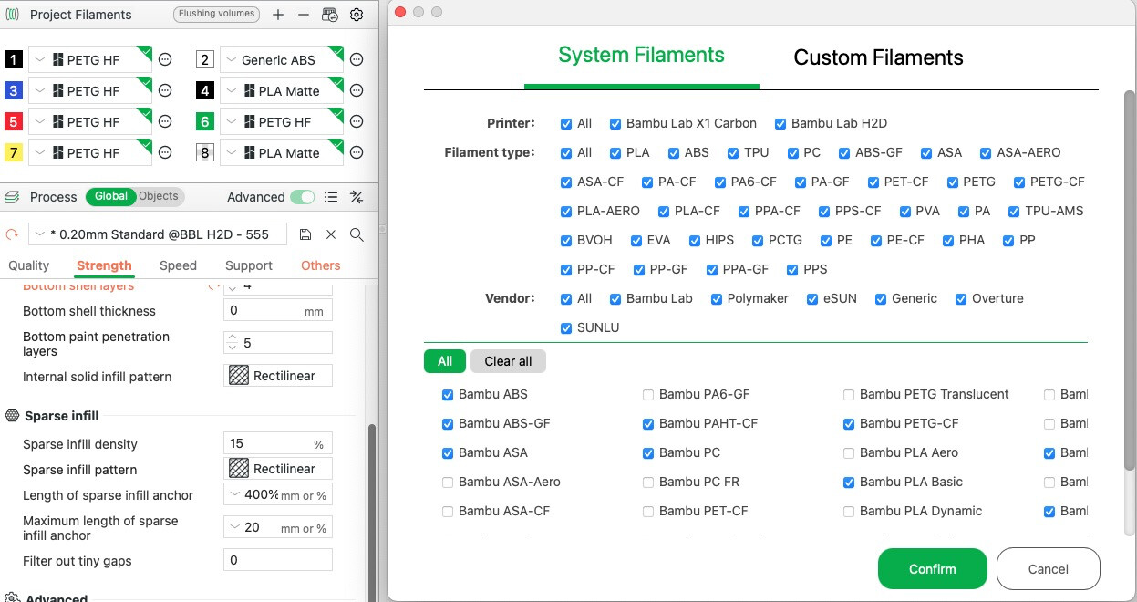

As I recall, when I bought my X1 a few years back, I had to choose all the filament brands and types that I wanted. By default, it only showed Bambu and Generic types. Last year I bought and H2D and it was the same. Filaments aren’t shared between printers that I’m aware of.
So your A1 filaments won’t be seen when using the P2S. The filaments settings may be different for different printers so each printer only sees what you choose for it.
May be different when using 2 different models. A1 and P2S, P2S and P1S or the like.
I have 2 P1S and the profile for the second used the same filament selections from the first. I did however have to select all the filaments we use when we moved my daughters Mini out to use for work.

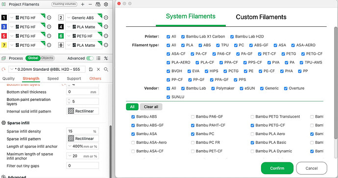

Are you sure about that. It’s very difficult to believe that Fiberon and Sunlu, etc are not available on that printer
You’re using a slicer, it’s an incredibly powerful tool, you dont need to give up like the hamstrung mobile users have to. You just need to fill in the blanks. Literally load up a sunlu PLA profile on your A1, take a screenshot, change back to your current printer, and diff it against what the generic PLA profile is, carry across whatever is relevant. Or use export/imports. Or just save as the generic, and start making your own. The vast vast vast majority of filaments are 3 simple tests away from perfection: Pressure advance, flow RATE, and temp tower.

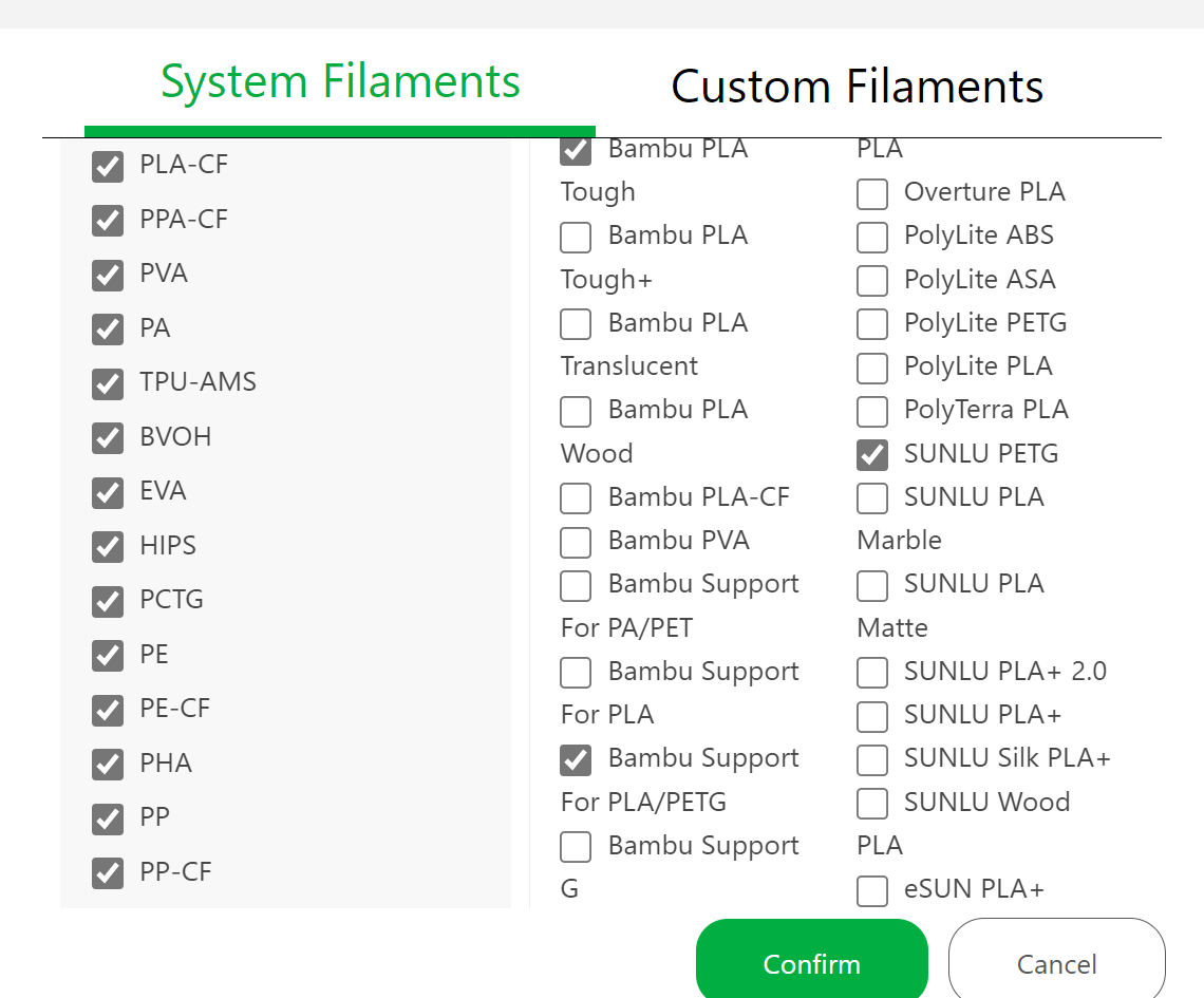

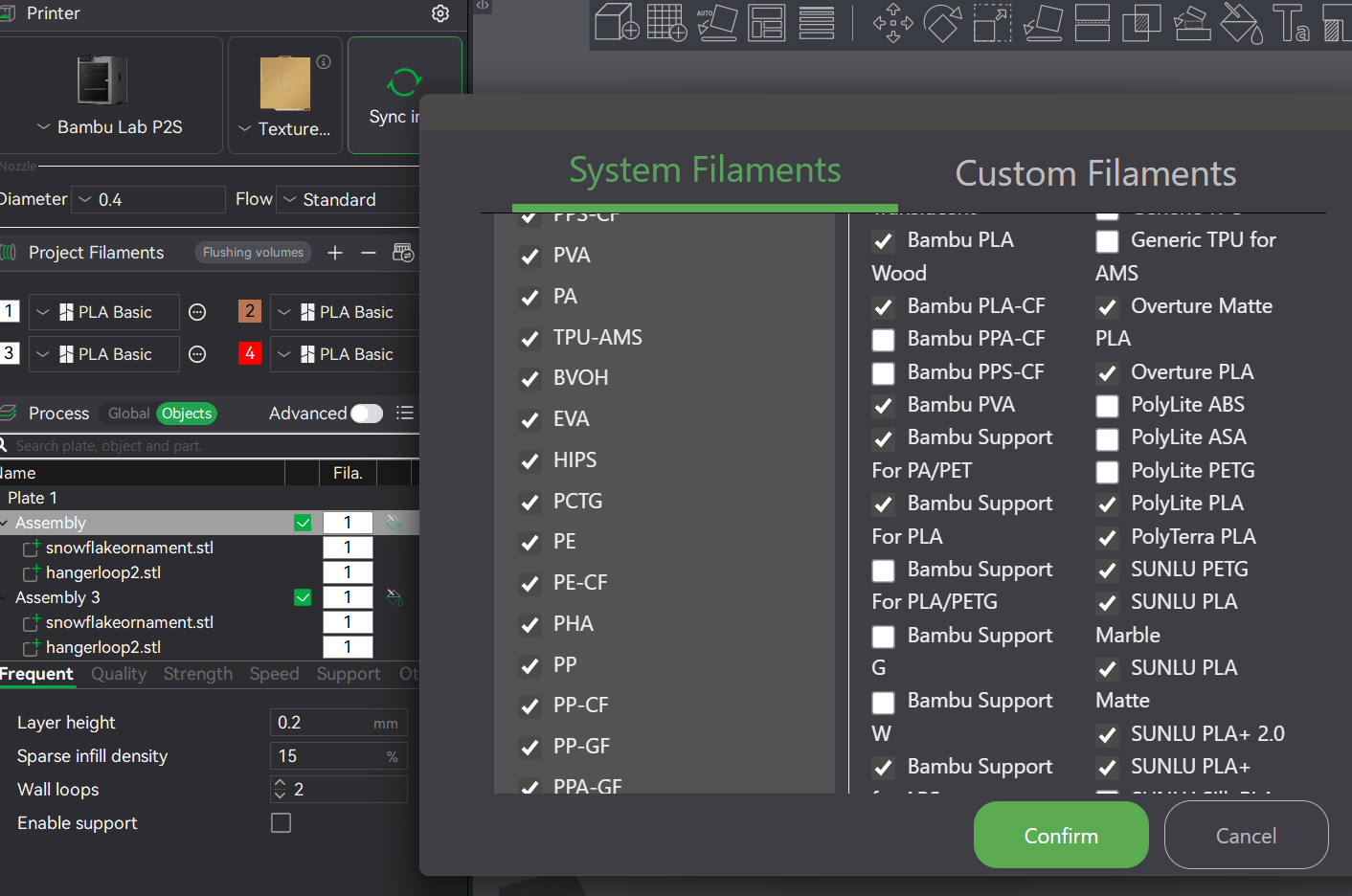

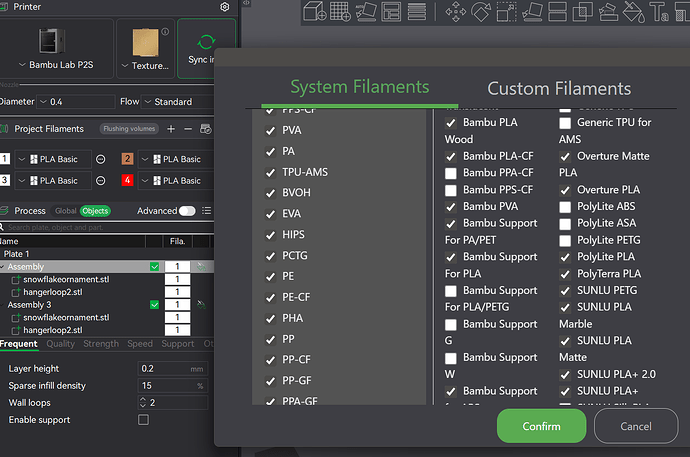

Those are filaments for P2S
And those are for A1

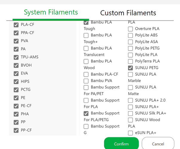

Thanks for your help. I know that I can (and will) do it like that. But why “Experts” from Bambu Labs didn’t do it?
Funny enough, I forgot that I used Bambu PETG HF profile and printed using Sunlu filament and the print looks OK.

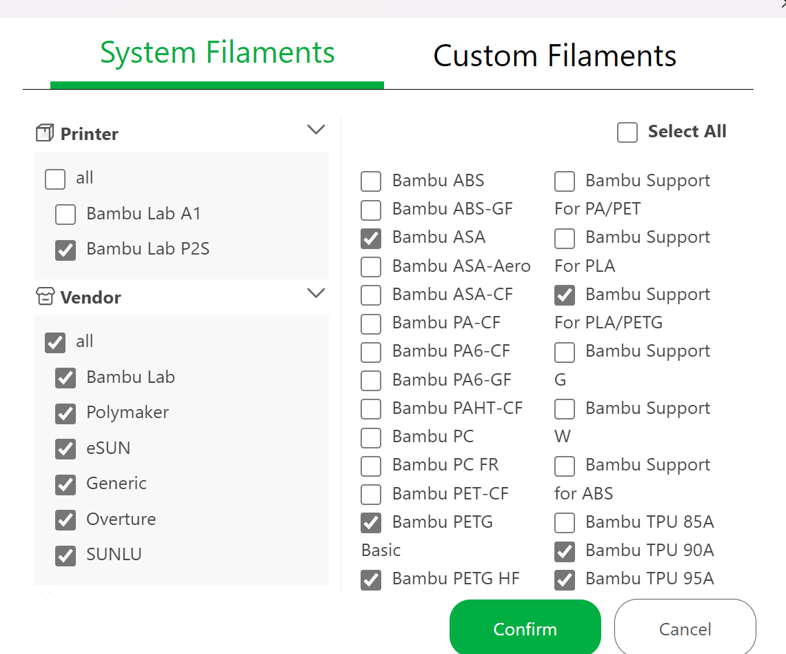

I stand corrected. Sorry I left “all” checked.

I’ve often just used BBL presets for Sunlu or Overture etc. Those presets either work well or will give you a starting point.
