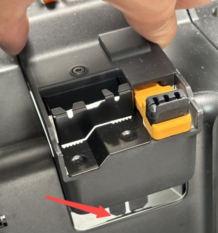

Hi everyone — I wanted to share an important factory assembly issue I discovered with my new H2D printer that could lead to serious damage if not caught early. My printer was shipped with the Purge Wiper Assembly installed incorrectly from the factory, which caused the toolhead to become trapped during the purge and clean cycle — resulting in significant damage to the printer.
What Happened:
While beginning to print, I noticed loud banging noises coming from inside the printer during the purge and clean cycle. After stopping the print and inspecting the toolhead area, I discovered that the Purge Wiper Assembly on my machine had been installed incorrectly at the factory.
Due to this misalignment, the toolhead ended up getting caught behind part of the wiper assembly during the cleaning cycle. This caused the toolhead to become stuck and thrash violently — ultimately leading to damage, including broken wiring on one of the hotend heaters.
What to Look For:
To help others identify this issue quickly, I’m attaching two pictures to this post.
The first is from the Bambu Wiki showing how the Purge Wiper Assembly should look when installed correctly - notice that the pins shown with the red arrow need to be inserted into the chassis:
The second is a picture from my printer showing how the Purge Wiper Assembly was installed incorrectly from the factory. When looking at this photo, notice how the plastic pins were not inserted into the holes in the chassis, as shown in the Wiki reference.
Because the assembly was not installed properly, with the pins left protruding externally instead of seated into the chassis, this caused the metal bracket portion of the wiper assembly to be misaligned. As a result, the toolhead became trapped behind the metal bracket during normal operation, leading to the damage I experienced.

I looked at the wiper assembly and read the bambu wiki on replacing the unit. The 2 rear screws are called out to be located at the top of the oval slots. I’m wondering if those came loose, it would enable the front ears to lift up and out during a nozzle wipe or a bit of a jam of some purge poop.
I checked mine and one was loose, the other just barely snug. I also had one of the 4 belt tension screws loose.
When I had the problem both screws were in tight. Good news is that Bambu support sent me all of the needed parts for the repair and all is good now.
I’m thinking the wiper assembly was correctly installed, however the toolhead ripped it out of it’s seating. I had the same issue as the OP, but I looked at previous picture of inside my H2D, and purge wiper assembly was correctly installed. I have no idea how the tool head moved the assembly with those tabs now outside of the proper seating area with the screws still intact. Took me 3 days to get everything fixed so I could print again. Is this a SW bug?

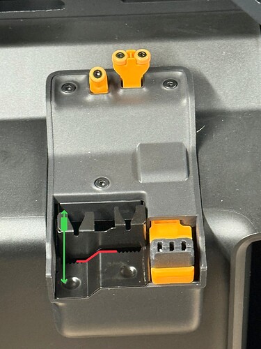

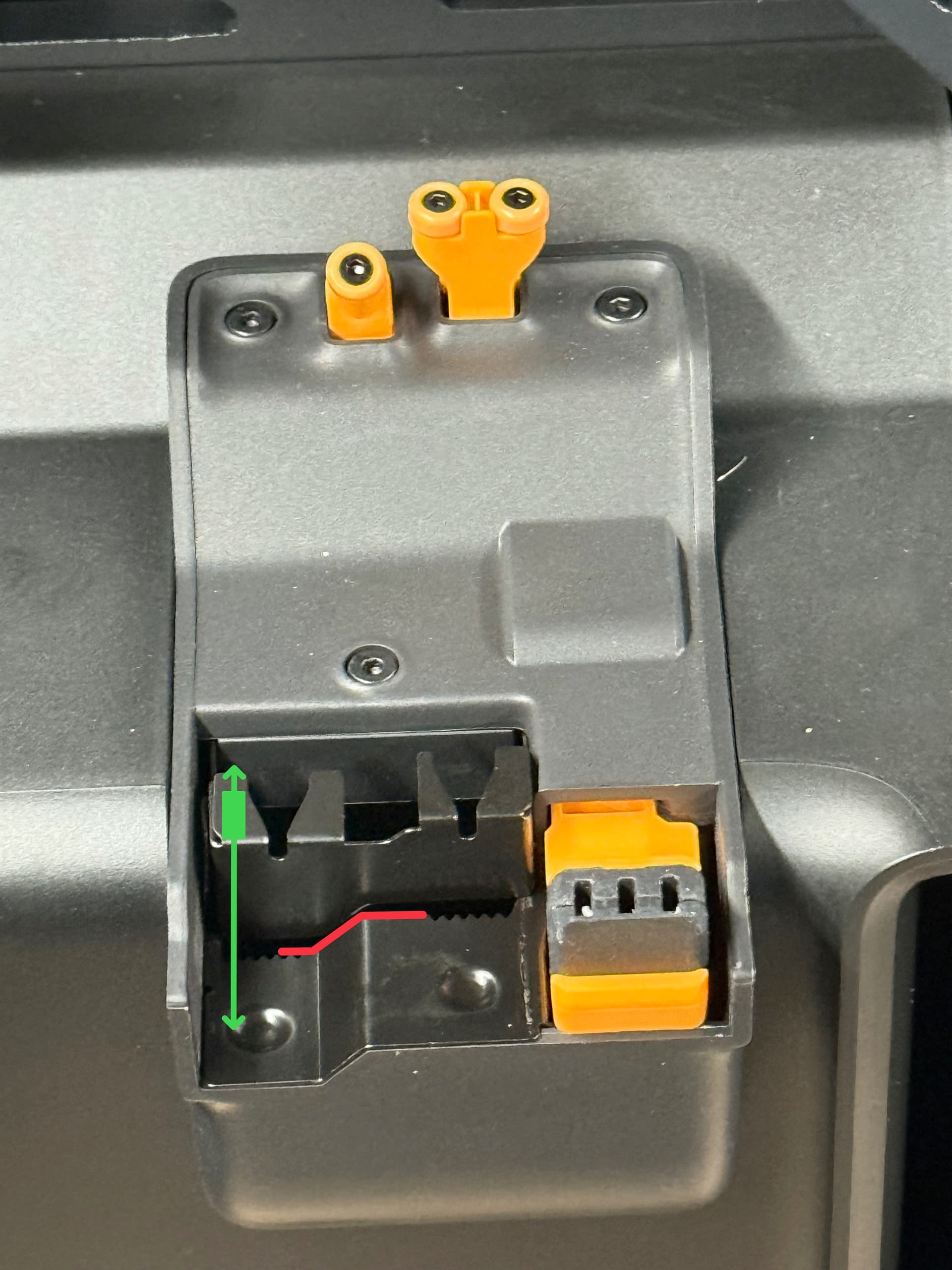

From my experience there is a tolerance issue between the moving upper “V nozzle wipe” bracket and the lower “dimpled” fixed one. I heard a few large clunks on my first few prints then watched closely. Checking this forum and my printer I saw the assembly was seated correctly from the factory, but there was an interference between the transverse motion of the upper bracket, shown in green with the fixed lower bracket. The collision point was shown by the red line. Upon the assemblies removal I could repeat and feel the interference. As this was fabricated from fairly light gauge sheet metal I very carefully skewed the colliding edge of the lower bracket down by ~.75mm with pliers sufficiently to remove any more collision and the whole assembly has functioned fine 3-2 weeks later.
It was more akin to chamfering the leading edge away from the upper.
Yes, I’m seeing considerable wear in the paint as a result of friction in this same area. I suppose I’ll need to investigate further.
I did what you suggested, and holy smoke it is so much quieter now. Thank you!
