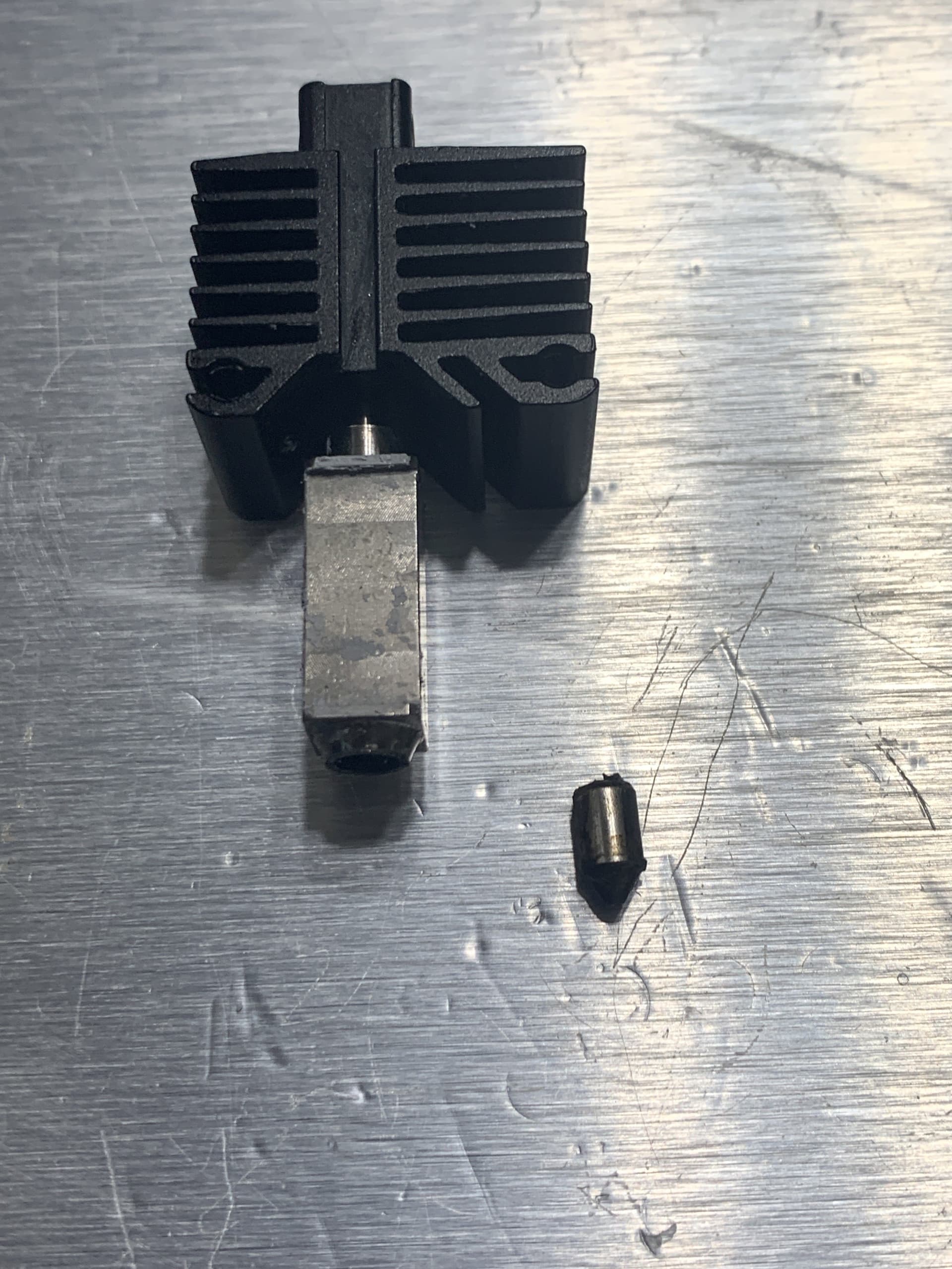

PSA: Do not directly heat a clogged nozzle with a torch
I had a tip come out of a X1 hot end during printing, so it could have been a manufacturing defect that got exacerbated by your heating. The tips are usually heat shrink-fit so best not to over heat them.
