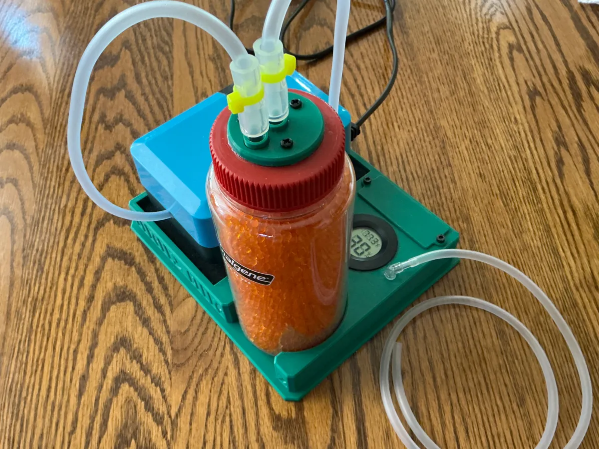

As an aside, since you seem to be a water person, if you want your filament even drier than 20%, you can purge your filament dryer with dry air. It sweeps out the moisture and helps more water come off the filament faster. It also allows hitting lower moisture contents in your filament.
With a dry air purge in my filament dryer, when the filament cools, it will pull the humidity in a container below 10% RH. The filament alone.
Full disclosure - this is my model (there are two - Arid Air 1 & 2). 2 is smaller than 1 and uses a plastic bead column housing (Nalgene water bottle). 1 uses a glass column that has more optimal geometry but is a more involved print. 2 is better overall IMO.
