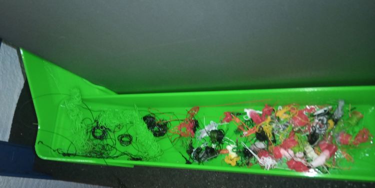

Purge chute broken part ? filament purge coils have become loose bunch
since a few days, the filament purge are loose bunch of wire, rather than tight coils as before.
this occured after a failed print, real mess of spagetti, and I found some beige bits in the bin
no colour like this since I got the printer, so I thought it could be remains of prints by the previous owner, and cleaned the head and started again.
I found similar symptoms in the Troubleshouting section :
The extrusion is straight, the prints are ok, but I noticed that the purge is not kept together until it’s dropped at once, it rather flows out.
Could the chute have been damaged ?
or the flap got stuck suddenly ?
thanks

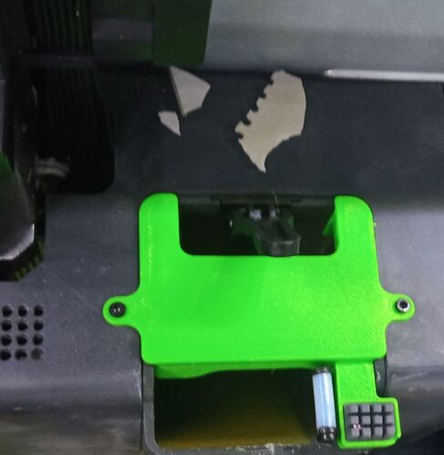

answering to myself, after some more look at the printer :
the chute flap is there, and moves freely when pushing the lever
but I noticed that the lever isn’t activated by the head movements
deeper look shows that **the lower back of the head is gone ** :flushed::
(picture added)
this is the source of the beige bits I found in among the poop, and some more fall at the back of the printer

I wanted to check rather the rear cover replacement will be the answer, so printed a replacement back cover, found on Makerworld
when looking at the replacement part next to the original cover, the missing bit is significant :
and once the cover is out, I could see there was another bit part ready to brake :
I didn’t pay attention to the " it suits only my middle cover part " bit, and was able to replace the rear cover, with some gentle persuasion (accès to the upper screws is :sweat: but those went in :triumph:
then testing showed that the flap is back to function, with tight coils
It may not stand the abuse loong term, but should do until I get the one I ordered
and I need to fix the sweep / cut of the purge as the second test coil jumped in the plate

edit : order for the original back over is sent, but meanwhile, printing must go on
replacement back cover received, and fitted : all good now
