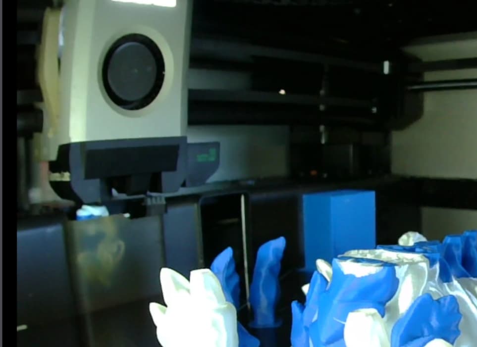

For a few days (week) I have been having a lot of problems with the purge evacuation at the excess chute. The evacuation does not always happen and causes excessive accumulation and which leads to a printing stop. I have 3 X1C printers and I have this same problem on all 3 printers. Am I the only one? Or if anyone else has this same problem, and how did you solve it, because support does not seem to have a solution to offer me?

Hello, everything prints correctly if I manually empty the purge receptacle, I have the impression that the head no longer hits the lever as before, the problem is present when I print in color! just one color does not cause a print failure, because only the first and last layer performs a purge

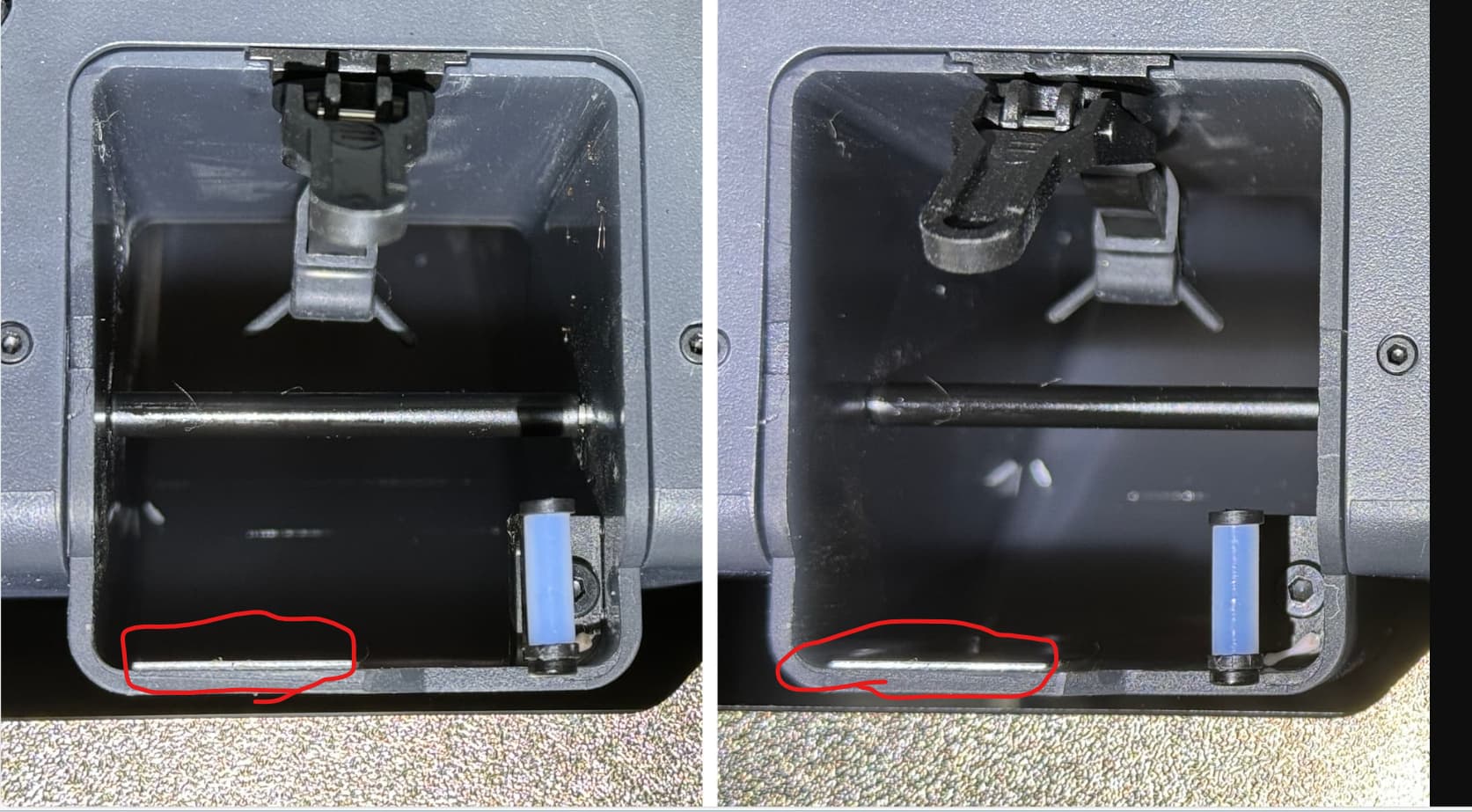

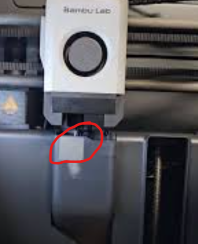

That’s not the issue. Normally there is a small piece of material that will deflect the plastic located in the front of the chute. Yours is missing that so the plastic is sticking to the chute.
Screenshot 2025-03-07 225819
Thank you very much BambuBanker I think you have probably just solved my problem, however, I have this problem on my 2 other printers which have this piece in place, however the problem is less present than on the latter, thank you very much for your support
