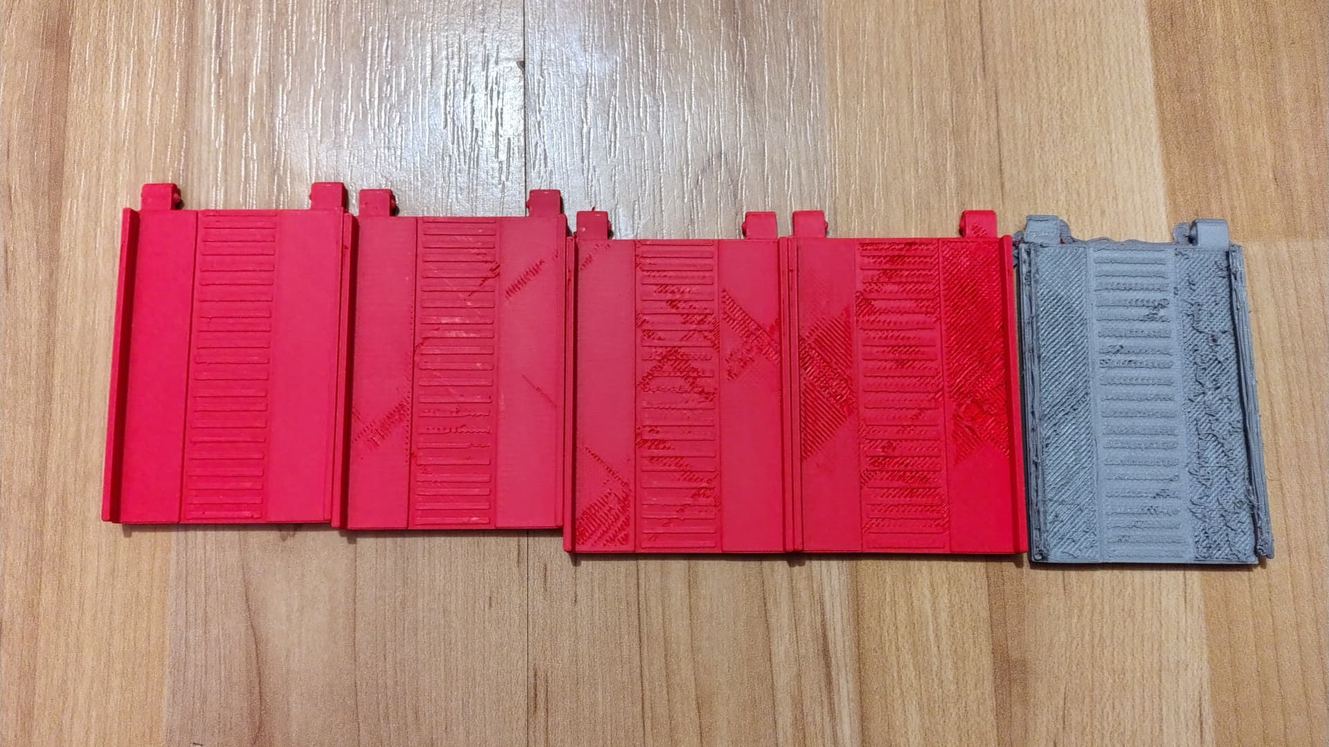

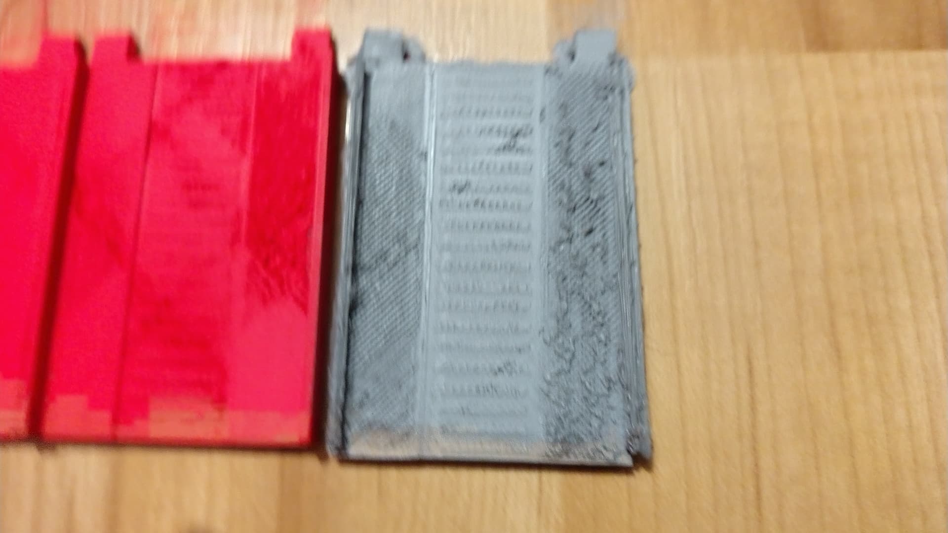

I have a P1p with a Ams 2, I’m printing with bambu matt red pla filiment on a 0.4mm nozzle with a 0.16mm layers height. I’m using the bambu lab default settings.

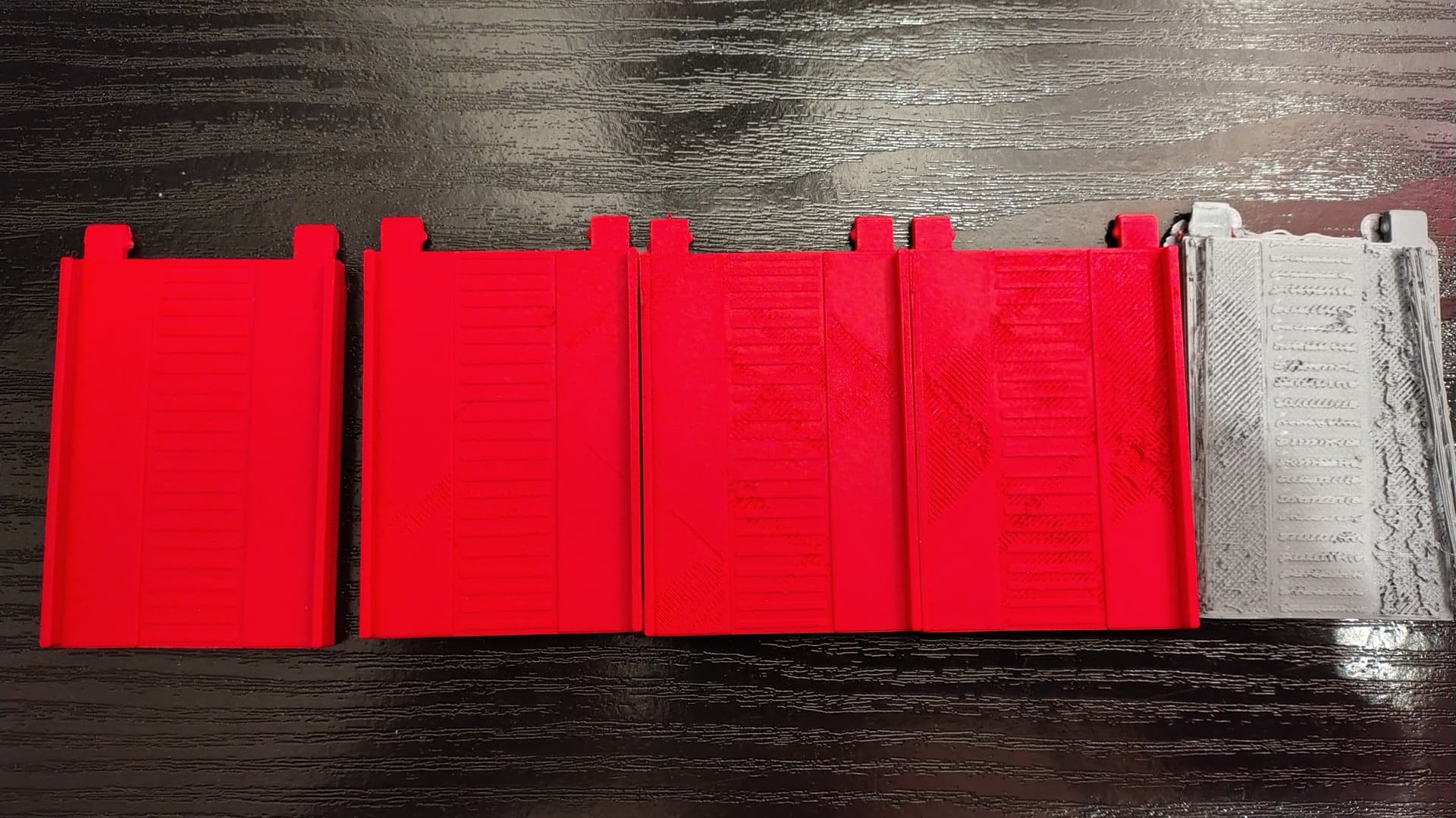

I have previously printed this model 3 times without issue. on the 4th time it started missing jagged slashes of filiment about half way through the print, which caused layers above to have problems. it looked like it simply wasn’t laying any filament down for several sections.
I cleaned the bed and moved the model to print to one side before printing again. the problem was much worse. what looks like surface damage is because the underlying structure is missing.
I tried again with the gray filiment in case the red was the problem and it was much worse. obvious under extrusion.
ams2 seems to be functioning normally, no weird noises no error messages.
I haven’t tried printing without the ams yet.
I have used this model, profile and filament before without any problems.
where should I start troubleshooting?
Try a complete maintenance (clean, lube, and printer recalibration).
The diagonal defects suggest a belt-related issue, so I lightly brush the belt teeth with a toothbrush (of course!), moving the print head for better access to remove dust and debris.
I’m not sure exactly what part of the routine fixes the problem, but it has always worked for me.
The gray part also looks a bit like wet filament or over-extrusion, but fix the diagonal defects first.
its dramatic under extrusion on an ironing section rather than being wet.
It’s like it’s trying to squeeze the filiment out through a half sized nozzle

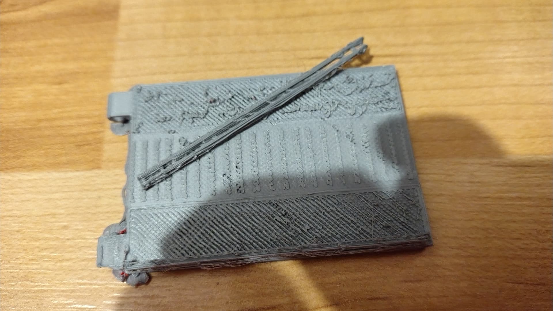

I sat and watched a model go down. It’s almost like it misses several passes out when doing infill of flat sections. So what looked like surface scaring was because there wasn’t any material underneath to adhere to.
Except for the last model in gray that is. It’s like it was trying to print a 0.4mm model on a 0.2mm nozzle. Only about half as much material was going down as was needed.

You mentioned ironing, is it that ragged before the ironing or is the ironing inflicting that on an otherwise normally produced model?
I would also suspect nozzle temperature / failing heater if ironing isnt the thing in play.

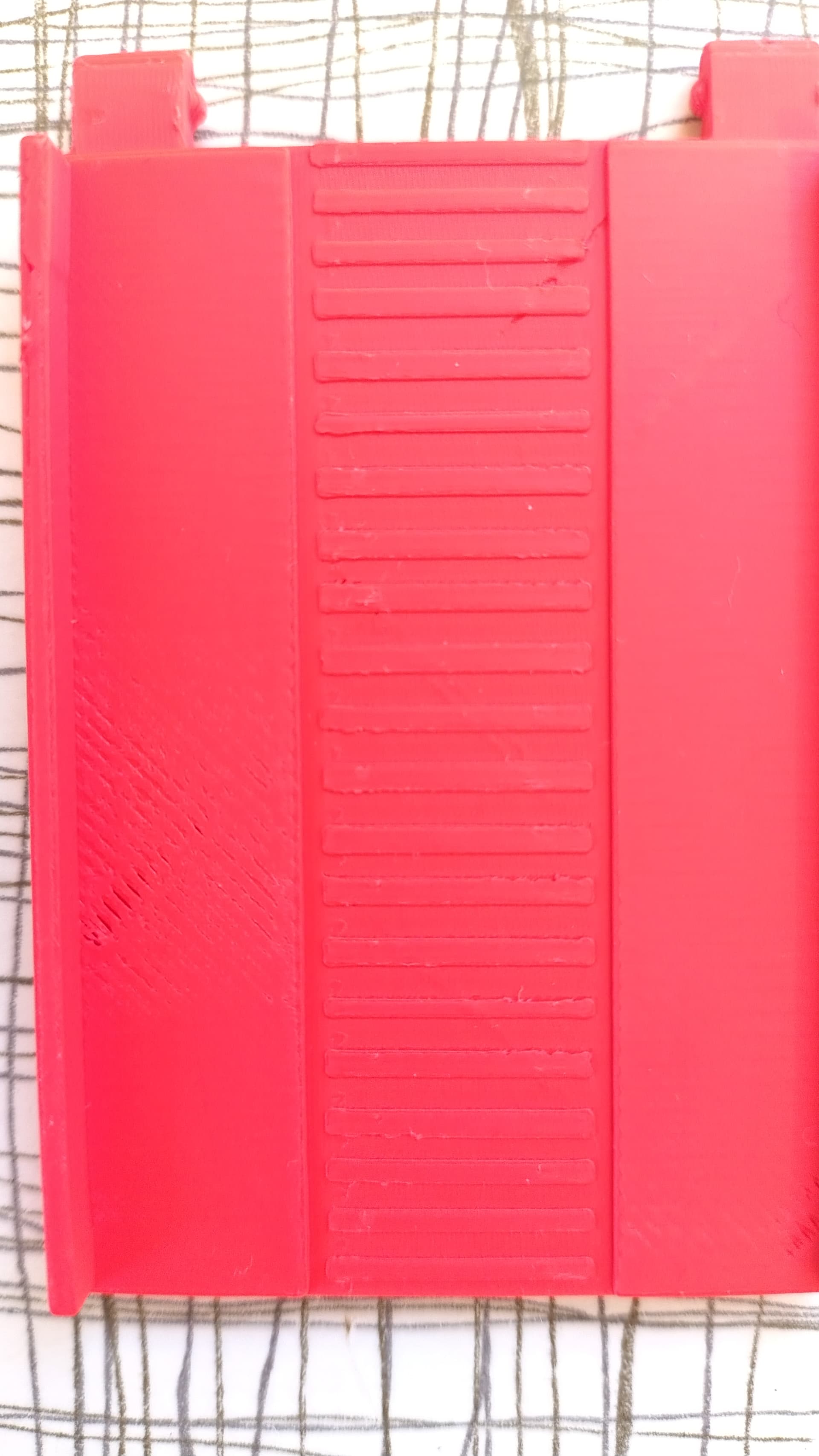

I did a manual heated purge of the hot end and nozzle, vkeabed the extruder gears and did a flow rate calibration.
It’s 99% of the way there but I 5 still getting a few small gaps due to under extrusion. see the left bottom hand side.
Personally I would try a new nozzle with renewed thermal paste [this is the p1 right?]. And if that doesnt move the needle go back to the previous nozzle [keep that spare] and replace the heater core + thermister, and again, paste. If thermals aren’t the issue, nozzle clog isnt the issue; then extruder or something like PTFE snag is the issue, its basically gotta be one of these to have a problem of “no filament comin outta the hole”

I cleaned the nozzle, the extruder gears and ran a full calibration and flow calibration using dry Bambu Matte PLA with Bambu Lab’s default settings.

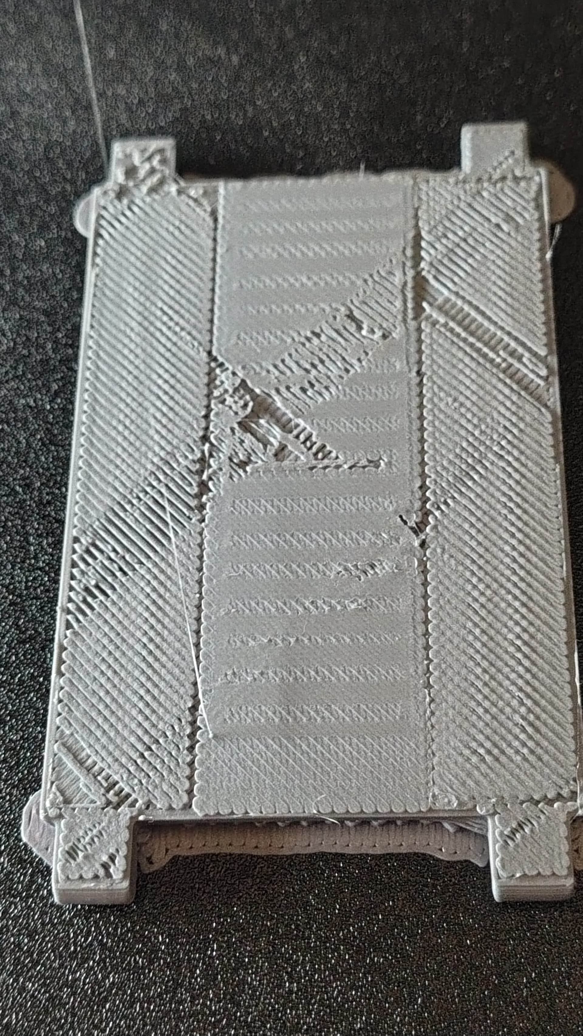

This is what it looks like about half way through. There are these entire rows where bits are missing. It looks like when the print head changes direction the filament either doesn’t flow or doesn’t stick.
I’ve narrowed this down to be something to do with my ams or filament buffer. prints semi OK when I’m feeding from an external spool.

I wasn’t able to find out exactly what caused this, but it was something to do with my AMS2Pro.
I stripped it down, cleaned it, replaced the PFTE tubes and did some more calibrations and flow calibrations, and it’s now running “almost” like it was before. Something is still a little off as the seams are rougher and ironing isn’t as smooth, but I’m 99% of the way there.
