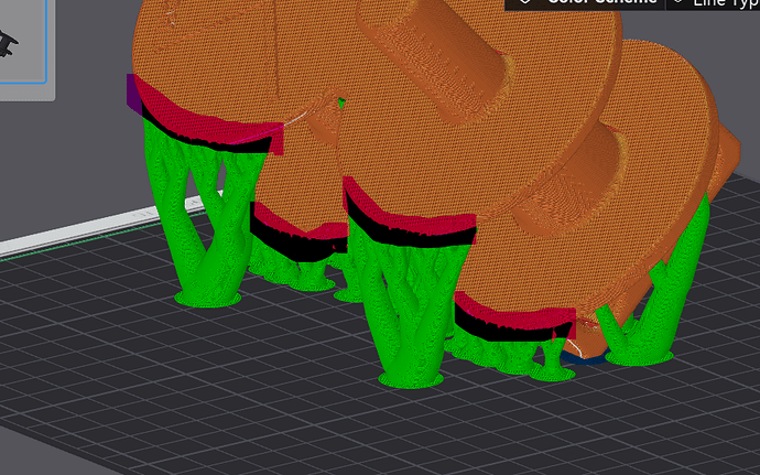

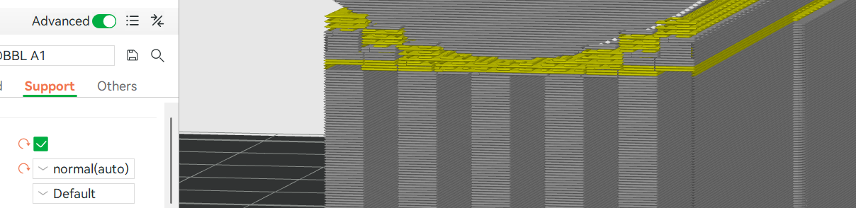

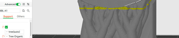

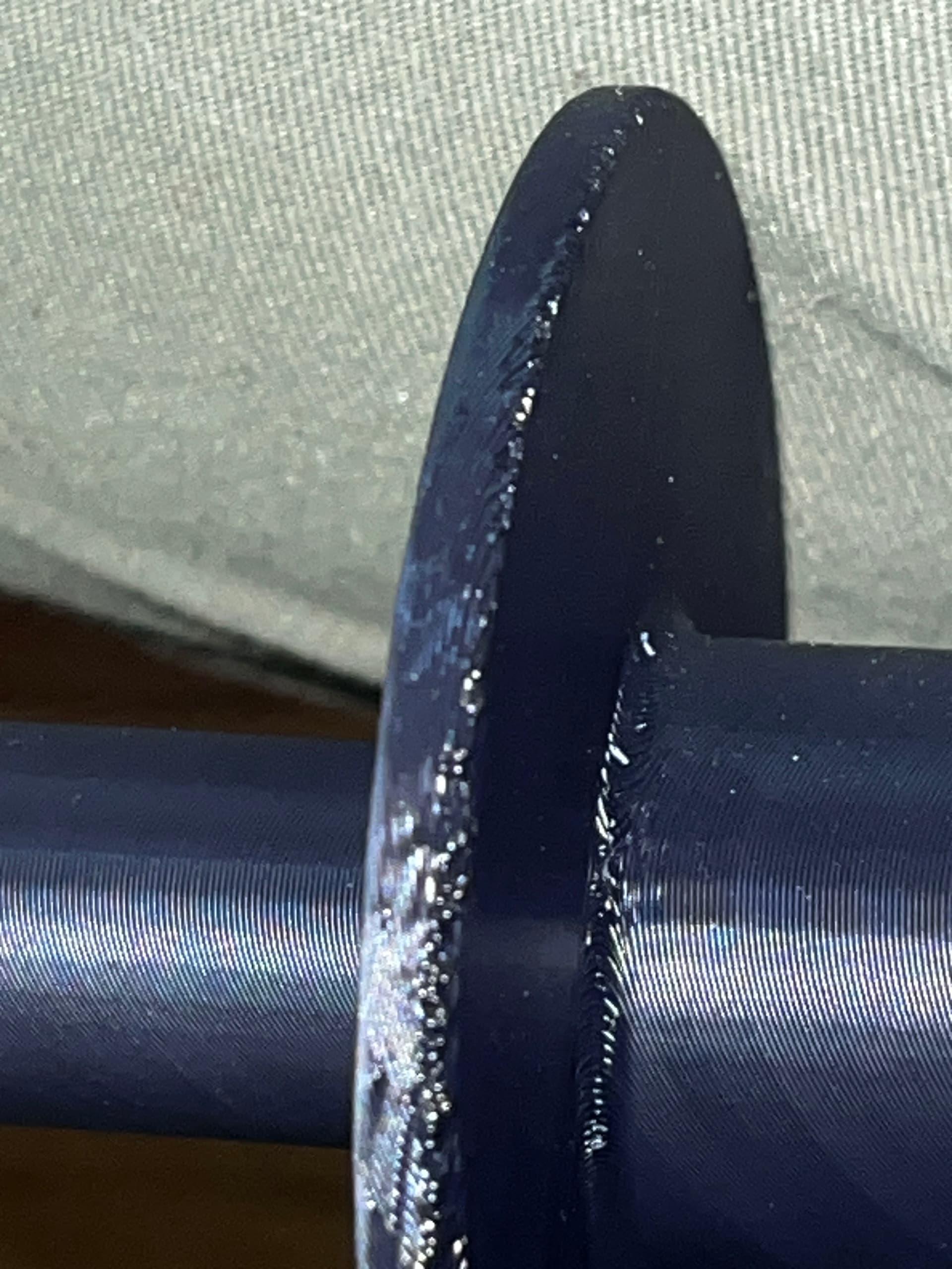

Hi everyone, wondering if there are some tweaks to get better quality results on the area where the model is attached to the organic supports. I have the model being printed approx. 45 degree angle to get the better overall print quality but where the supports are attached the model is very rough and unfinished looking compared to the rest of the print. Hoping there is a way to make some improvements. I have screen shot the settings and how the part is on the bed and then an actual image of the printed part with supports removed. Thanks
Organic supports appear to be missing an interface when you compare them to other support types
Normal auto offer a better result because the interface is a fine mesh(opinion not always fact)

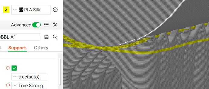

with that said there are advanced settings you can play about with on test pieces
Thank for your feedback, I have made a few setting changes and did find those advanced settings so did a few tweaks to test.
