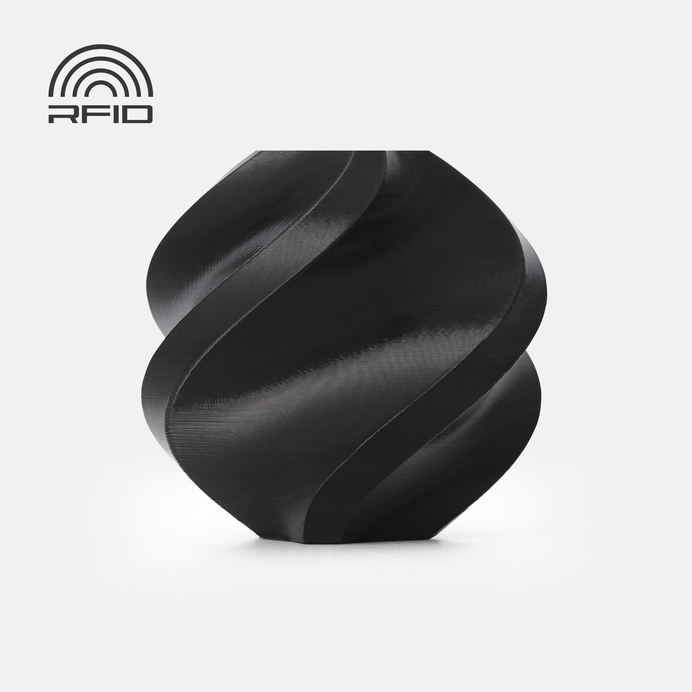

As @Gerrit said, the H2S shouldn’t have any issues printing that filament. I will however say that with proper board grounding, ESD shouldn’t really be a concern. I’ve printed a lot of electronics enclosures and have never had a board die from ESD. If you are looking to get something certified as an enclosure I would suggest looking at filament with flame retardant certification as this is required for electronics enclosures.
Tested to meet the UL 94-2023 V-0 standard, the top level of flame resistance for 3D printing filament, Bambu PC FR is engineered to prevent or slow flame propagation with exceptional self-extinguishing properties. Ideal for critical applications in electronics, automotive, and mechanical engineering.
* UL 94 is a plastics flammability standard established by Underwriters Laboratories (USA). V-0—the highest UL 94 V rating—indicates that burning stops within 10 seconds on a vertically positioned specimen, with dripping particles allowed as long as they are not ignited.
