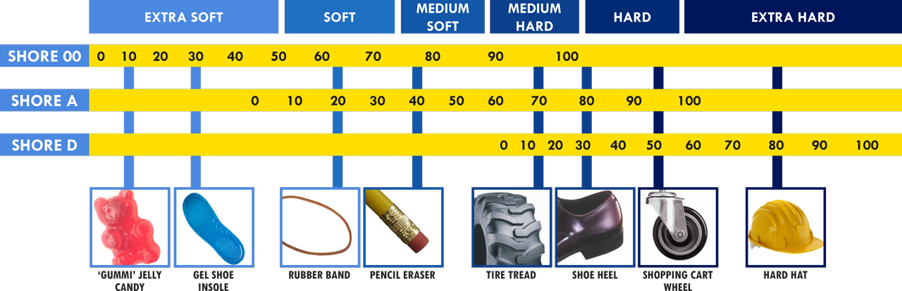

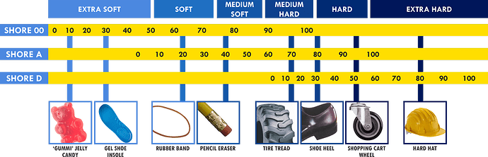

TPU is a family of flexible materials based around a shore scale. This denotes the point between very flexible to rigid that it appears.
TPU 95A is the most common one 3D printers have had access to, it was been the easiest to print while still being flexible ^.
As noted above, TPU for AMS is shore 68D, thus is a harder material when printed and essentially designed to be able to be used with the AMS while still being in the flexible family.
Recently 85A and 90A were made available by Bambu Lab, although available by others before.
These are much softer and harder to print for novices. (See the guide I gave you the link above for).
Which you choose defends on your requirements.
I like TPU for AMS, it works well in the AMS, lets you easily mix colours within the same filament, but, it is stiffer. Works well for coasters as it can still be bent over than size.
Using TPU is all about how you design the flexibility in to the design. Wall counts and and infill percentage are key to having something bend or retain more rigidly.
TPU for AMS will be much more rigid to start with and be hard to get to something bendy if it is thick.
The key is experimenting until you are happy.
