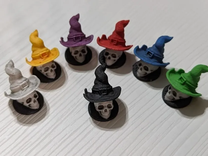

Hi, I have a question about the painting function in Bambu Studio. I’d like to print the following model (a token from the board game Black Rose Wars) in multiple colors. The base should be black, the skull white, and the hat green. The problem is: the model has many edges, meaning that if I select the “Fill Edges” option, it would take forever to click everything. The same applies to the brush – do I really have to paint every single tiny bit precisely, or can the program detect gaps and fill them in according to the surrounding color? Are there any special tricks?
If it is this model it is already prepared and painted in 3 colours.
You choose ‘Fill’ and ‘Connected same color’ in the paint dialog to change base, skull or hat color. This will change one color to another color.
