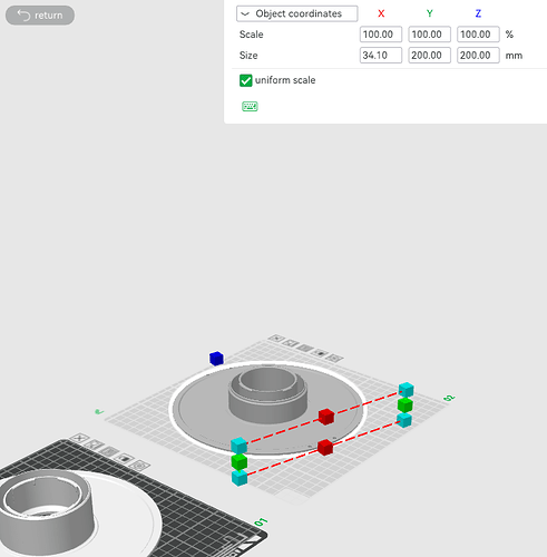

I think I know the answer to this but, as a newbie, it’s best to ask.
I want to print one of the Bambu Lab filament spools I found in MakerWorld. See attached image; the file was downloaded to Bambu Studio with each half on separate hot plates. I setup “wide” first, which is yet to be printed, and when beginning to work on “narrow” I found the “X” coordinates different, x128 and x435.15.
Is it to correct to assume the software will preform an offset and print narrow spool correctly? Looking at the G-codes for narrow spool it appears to do so.
See image;
Short answer, yes.
Longer answer, the seemingly weird coordinates are due to where it sits in works coordinates.
The right build plate is farther right than the left one.
Nuts, right!
Print build plate 2 with the same confidence you can with build plate 1 or number 32.
It knows, it will do it correctly no matter how confusing or appears at first, later and still now, it is nuts (did I say that).
The coordinates that you are seeing are the coordinates relevant the Triad (marks the origin).
They do not represent the size of the object. They only represent its position in the coordinate plane.
To compare the size you will need to select object coordinates and that will give you the size of the object in the measurement system you have studio set to.

The spool on the right appears to print correctly in slicer according to the “X” coordinates in the G-codes.
