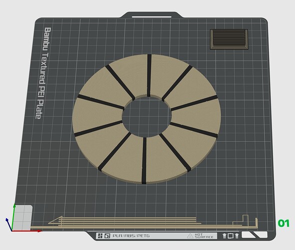

Imagine a disk that’s 3 inches in diameter and 1/4" thick. Imagine that it’s divided into 12 segments. The segments are translucent, but they are separated by an opaque divider. The Bambu will do that with enough filament changes. How would such a structure be programmed for printing? Will it print all of each segment in a given layer before changing to the opaque divider, or will it change filament back and forth over and over?
It will do only one filament change per layer per color, in your example all of the opaque will be printed in one go.

That’s the concept I have, but how would you DRAW it to specify the separate colors? Would each pie piece be a separate body?
I guess I answered my own question by trial and error…
Yes, each piece you wish to have as a separate colour would require a means of making it one or the other colour.
There are two common ways.
  1. Separate parts, you then select all those you wish to be translucent and assign them to that filament, select the remaining parts and assign them to the other filament.
  2. Paint the colour, this requires a design created with paint painting in mind. Harder for the model you are talking about as you tend to paint triangles within a design. A well constructed design will achieve it though.
I prefer the separation of parts method as it guarantees the quality end result and is usually quicker to assign colours in the slicer.

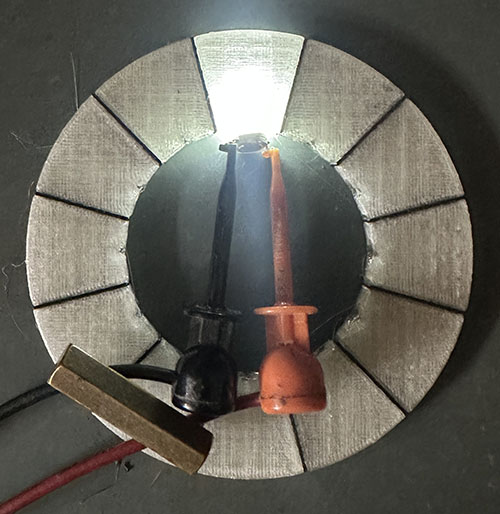

Just to update, a test disk works fine and passes plenty of light only into the illuminated segment. A 4" disk took 1-1/2 hours to print.
