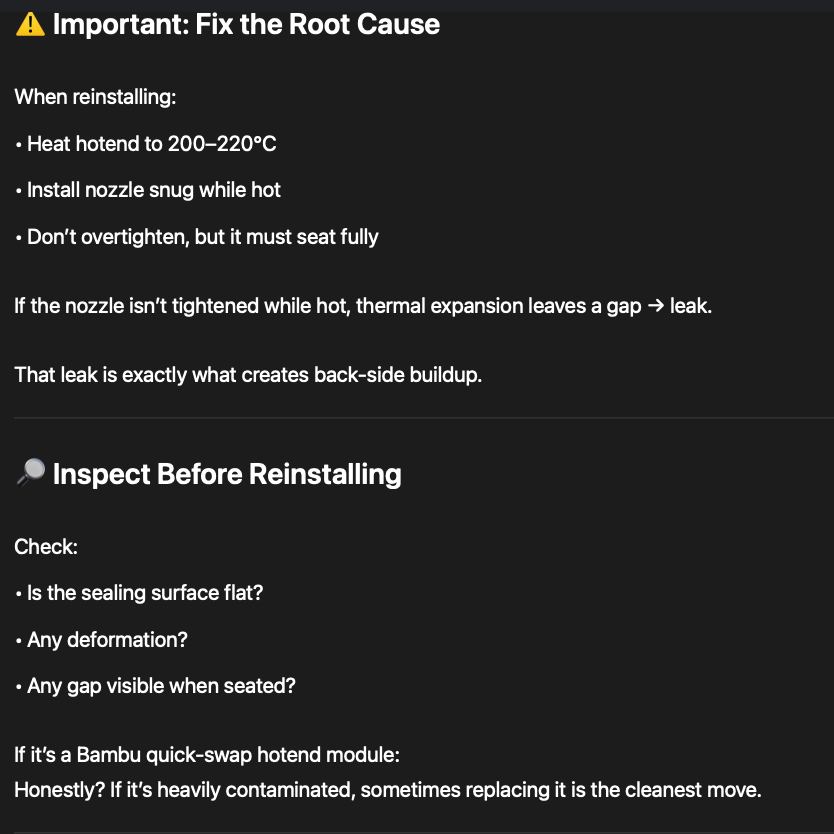

edit: I just copied and pasted your post into ChatGPT and got the chared plastic dx, explanations, and a list of solution options. I would try that.
I checked the extruder gears and they are clean. Then I turned around my nozzle and the whole back of it is covered with black plastic.
What’s the best way to get it off? A flame and a wire brush? For some reason my only spare is missing the magnet so I need to get this one cleaned up.
I would try a wire brush.
Edit: Sicne I still have the ChatGPT session open, I copied and pasted your post above into it and got the following:
