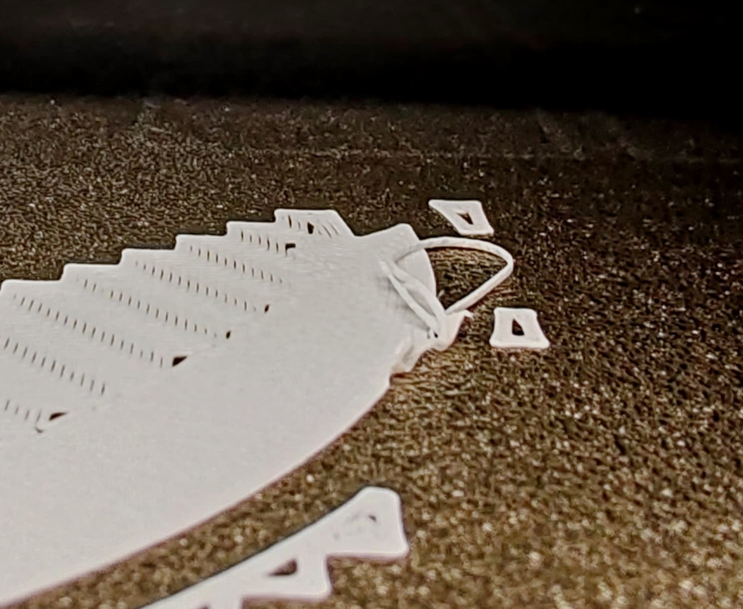

I have been getting a lot of random filament spikes on my prints. I am using a 0.4 stainless steel nozzle on my P1S with PLA, I have this issue on PETG and other types of filament. Any ideas why
That looks like adhesion issue and next layer pulling it away.

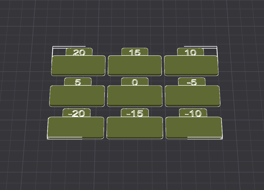

The symptoms are classic of improper temps. If you’re relying on Bambu Studio for proper calibration, their calibration routines are half-baked. Try out the Orca Slicer version of Bambu Studio and run a temperature tower. What you’re looking for is the optimal temps that the filament will extrude at.
Also, I’m going to wager that you did not properly dry your filament. Even if you say you dried it for multiple hours, did you weigh it? I say that not to be confrontational but if I had a dollar for every time someone swears up and down that they “I put it in the drier for xx hours…” but they never weighed it to know if it really had moisture and if that moisture is gone.
An extreme example of a temp tower using PETG, undried on the left, dried on the right. Even a temp tower would be useless with wet filament.
A second example. This was before tuning for pressure advance which is why you also see lots of stringing.
Notice in this example the kind of underextrusion at low temps? at 200C, this filament can’t melt fast enough to produce correct extrusion.
Which is at least one of the factors that may explain this:
There are likely other items that should also be investigated.

Funny you should say that about moving to Orca, I did a week ago. I feel spoilt using Bambu printers and have forgotten everything I learned with my Ender 3 pro. I am running a temp test now however I am 99 percent sure you are correct about the print temps. 1 hour to go.
