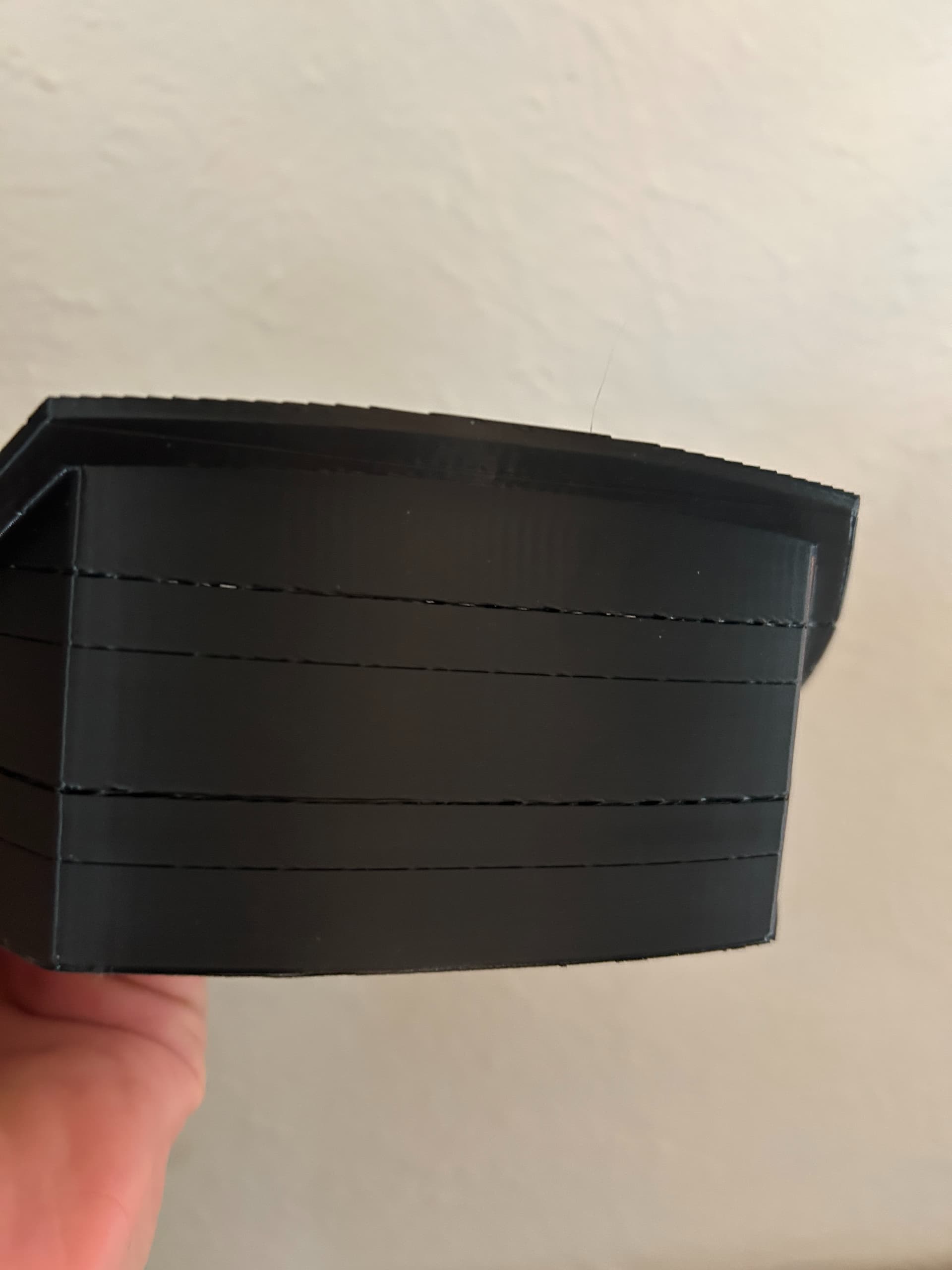

Recently out of nowhere, my p1p’s prints are missing entire layers, resulting in ugly gaps and weak prints. Whenever this happens, there is a loud snapping or clicking noise. It sounds like plastic breaking. Here is a picture of a recent print.
It only seems to happen for a layer, then resumes to normal. I have already checked all of the components in the extruder, and they seem to be functioning and moving smoothly. I believe it is a problem with the hotend, as it has not been replaced in about 500 hrs of print time, and is showing some signs of wear. I would like to make sure that the hotend is the problem before spending $35

Check your filament path (PTFE Tubes & AMS) & the spool itself for a tangle.
I have, they all seem to be normal
Could it be temperature related? Either heatbed not keeping the temp or someone is opening/closing windows in the vicinity which is affecting the temp of the print?
/A 3D printing noob
It’s definitely not heatbed related, the temp in the room does fluctuate, but not enough to change the temp of the hotend. I think I’ll just replace the whole hotend assembly in case it is caused by a faulty thermistor or heater cartridge. Thanks for the ideas.
Update: Replaced the hotend, and now the printer works perfectly.
