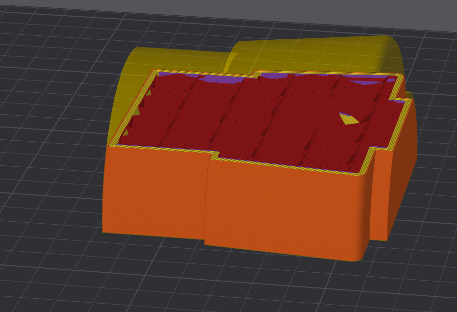

I have created a model myself in Fusion 360 for my P1S printer. On the outer walls, there are random bumps in the layers. It looks like the layer is moved a bit on the Y axis. These bumps are completely random.
I believe this might be related to the spherical nature of my print, and I’m unsure about the proper setup for such geometries.

There is a whole lot going on here but nothing in this list below will remedy or have an impact on what is shown here.
Let’s focus on the basics and the most obvious problem. This image will serve as a good starting point.
These layer deviations are generally caused by improper tool head travel or obstructions in your filament feed. You didn’t mention whether you are using an AMS, but the first troubleshooting step would be to try reproducing this shape using a direct spool without the AMS. If the problem goes away, then something in your AMS feed is obstructing smooth flow. Go to the wiki for diagnostic steps and inspect your PTFE feed tubes for alignment and binding. This issue can also be caused if your PTFE tube is snagging on something during the print, so check that too.
The fact that the ridges appear uniform across the X-Y travel but non-uniform between layers could be due to dirty carbon rods or improperly lubricated Z-screws. To rule this out, follow the P1 maintenance procedure in the wiki.
Based on your forum join date, it looks like you may have only recently received this printer. Maintenance shouldn’t be needed yet, but you would be the second person this week to report this issue, making me wonder if the factory is not properly lubricating the Z-axis rods. DO NOT lubricate the carbon rods—it will ruin them! Follow the wiki: Bambu Lab P1 series printer Maintenance Recommendation | Bambu Lab Wiki
Another factor could be belt tensioning, but unless you are skilled at this, you are more likely to make it worse. There is a procedure in the wiki that walks you through it, but this should be a last resort. I would investigate feed problems first.
