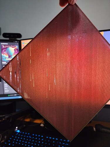

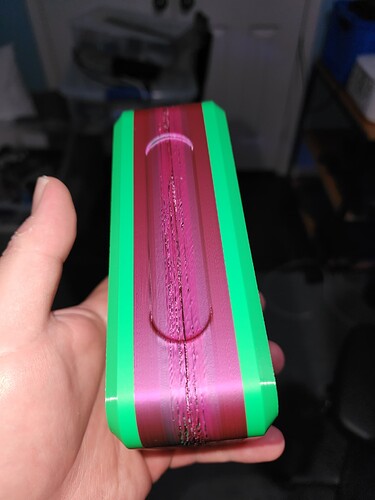

But now I am at the stage where it just doesn’t want to print correctly. I was printing PLA Basic and it ran out, I moved a roll of PLA Silk in its place and started the print… This was probably not the right way to do this but wasn’t thinking when I did it.

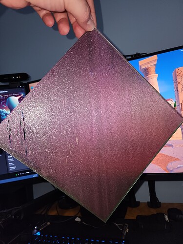

Well it printed the next probably 1/2" fine then it started separating and looking horrible as in the picture. This has gotten worse now ever print is just spitting and not printing and I am using PETG. Stock printer, stock profiles nothing special.

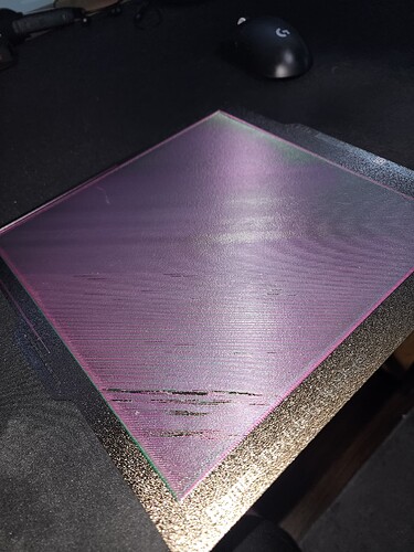

I have the PETG sitting in a dryer tonight and will test it again. Here is a print of the PLA Silk first layer sheet. Trying to do some flow calibration now to see if that helps with it.
So I let the petg dry in the sunlu dryer for 48 hours at 55°c and shows 18% RH. I tried to do a flow calibration two times failed, so I tried a first layer and it’s a disaster…
I can print pla zero problems but as of last week after the filament switch during a print this disaster has made me hate the X1C. I almost feel like I own my ender 3 again.

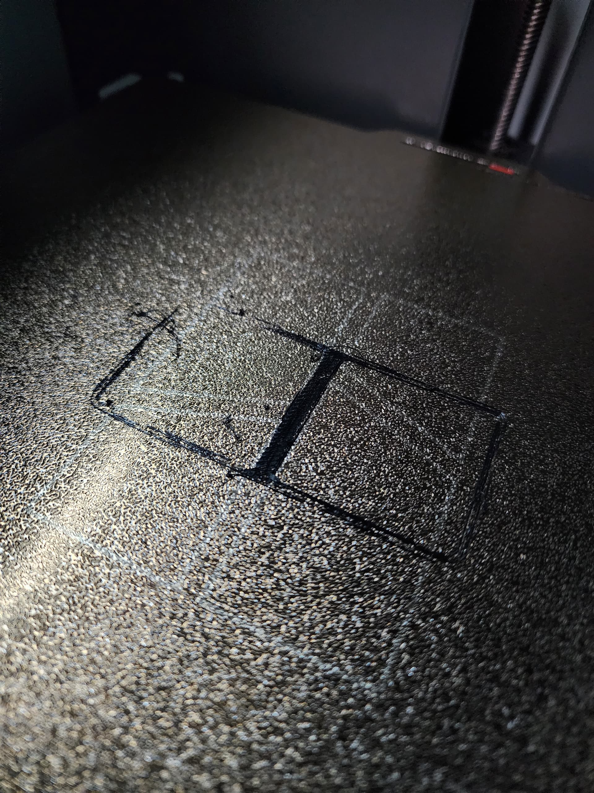

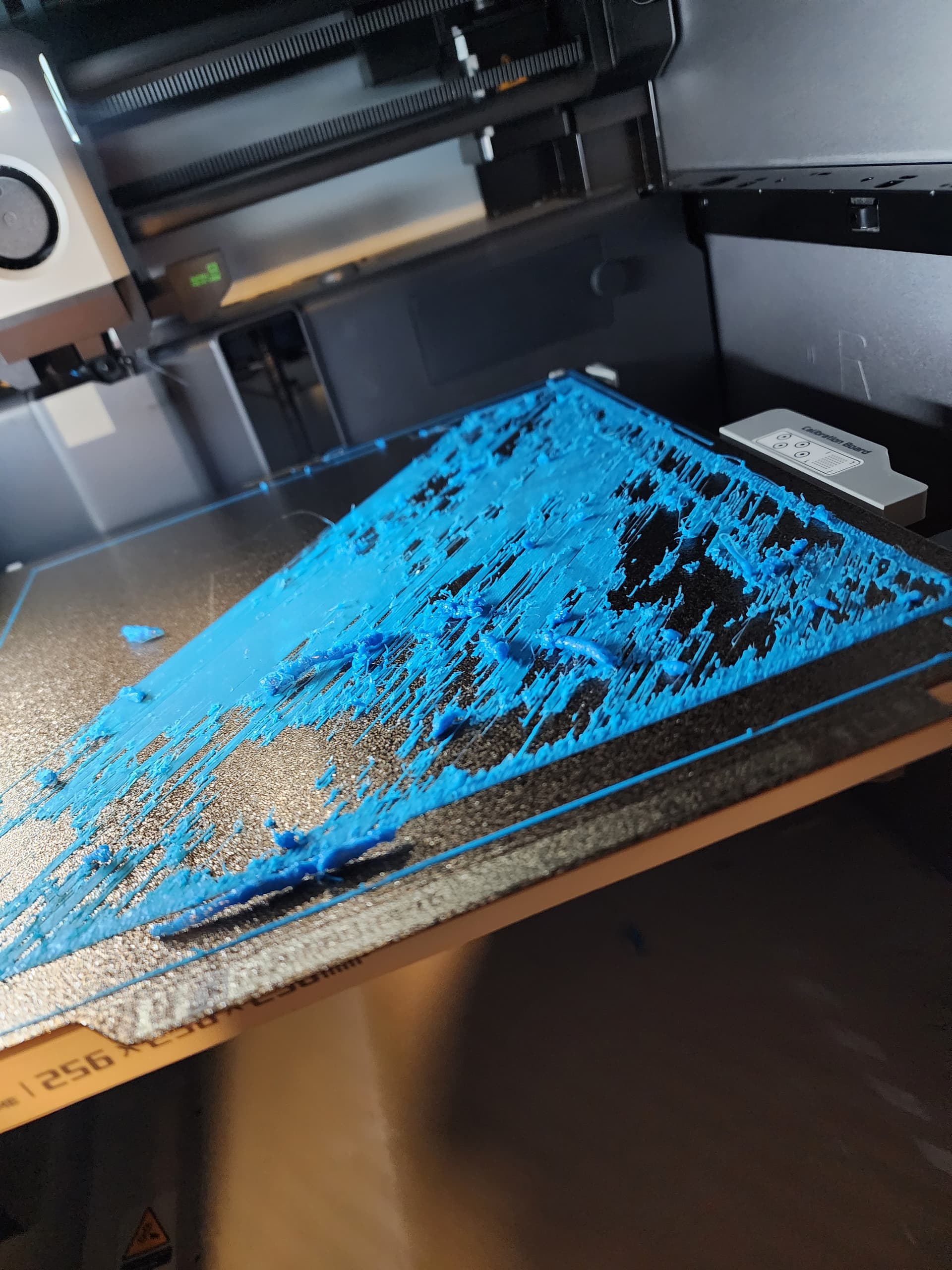

Here is what the bed looked like using generic petg setting but adjust temps to 245°c and 85°c. I’ve tried lower and higher without luck.
I am starting to wondering if something is wrong with hot end or what am I missing for this printer to just hate petg so much.
This was with overture petg, however same result using the Bambu petg too.
I would add more nozzle temperature. How are you cleaning your bed?
I cleaned it with a yellow scrubby daddy and dish soap. Gently washed it. Surely it would remove any coating would it?

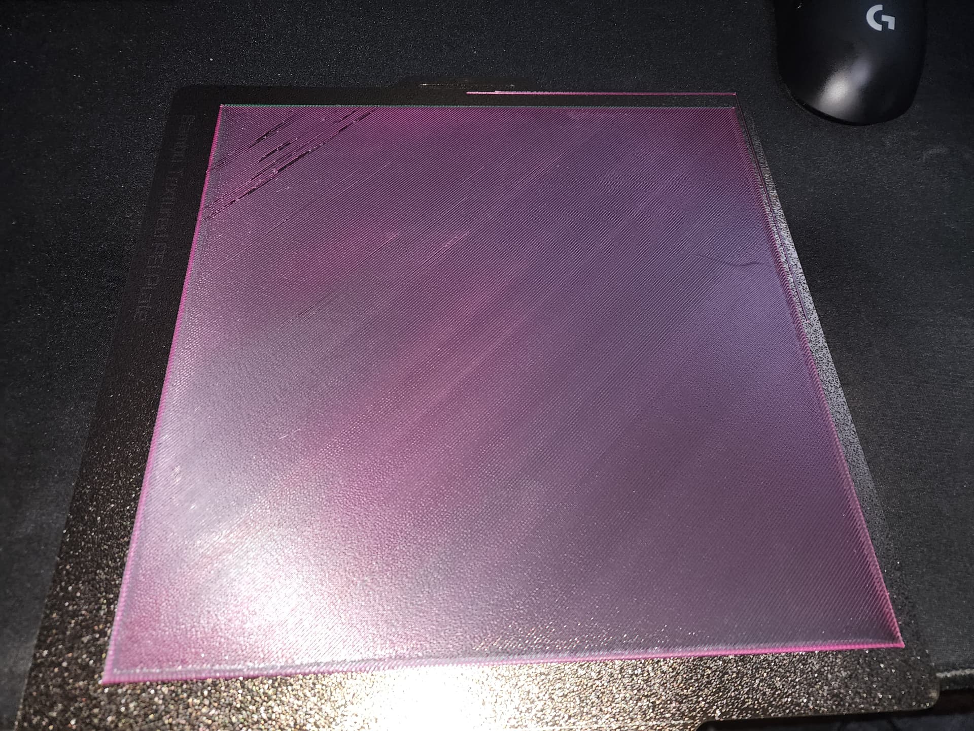

What’s crazy is I was able to do a cold pull. Print one first layer sheet and it did pretty darn good. Then I printed one thing and now it’s doing it all over again.
I just got in a whole bunch of pla yesterday I printed eight prints on PLA and had zero issues I don’t understand this.
