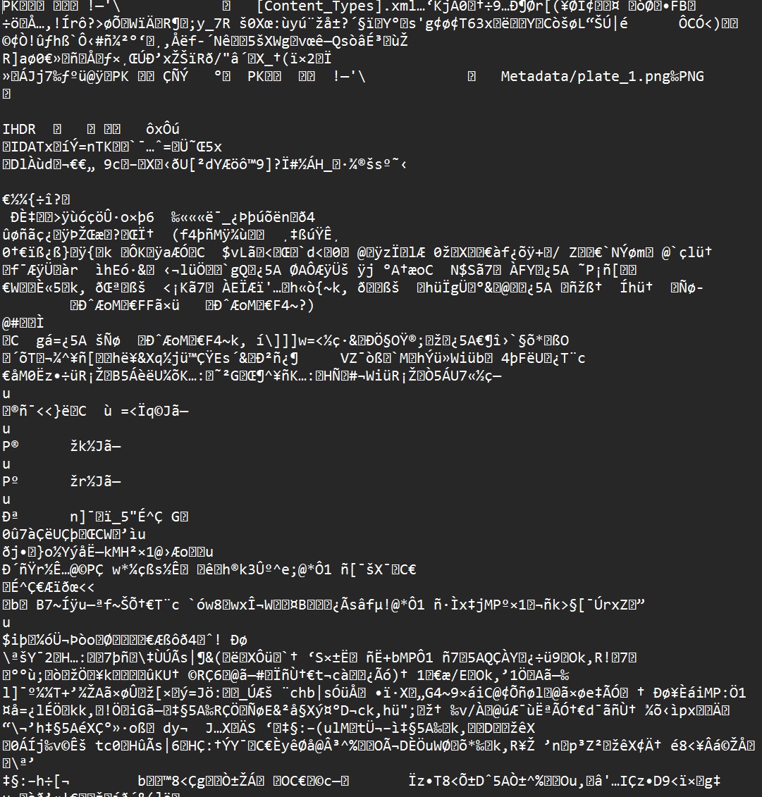

Opening the xxx.gcode file in notepad gives me this:
In properties it says the file is xxxx.3mf. I can’t find a reader/editer for this file.
A 3mf file is a zip/tar archive. File of files.
Download 7zip
Open the 3mf file with 7zip and look thru the folder structure for the gcode file.
Edit: or if you’re the one producing these files, just use export as gcode instead of whatever else
Thanks. Exactly what I was looking for. :+1:
