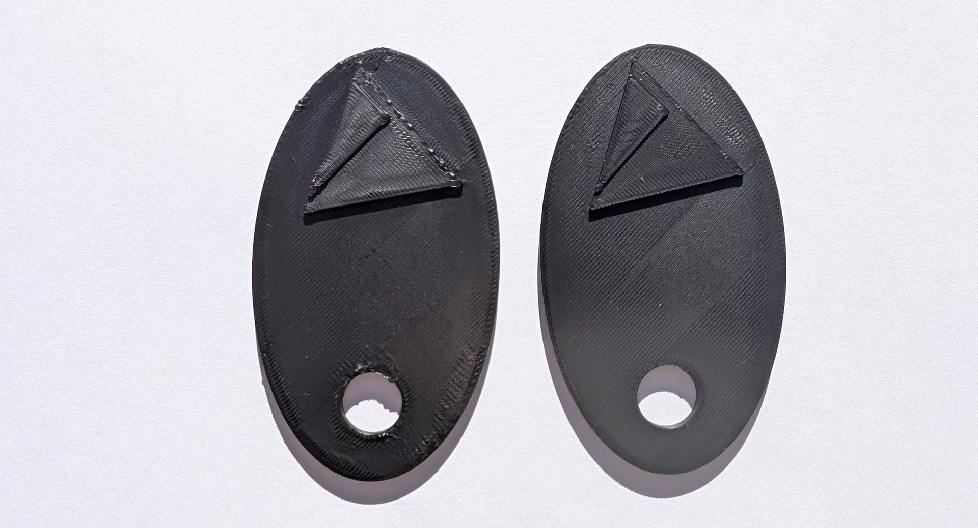

Gentlemen and Gentlegirls,
let me clarify that I cannot reproduce the issue with the K-Factor issue when using the FTS.
I did now several tests for you and wanted to share wisdom.
Test Setup:
  • Bambu Lab X2D Firmware v01.02.00.00 (v2 hardware revision, bought mid of July 2026)
  • AMS 2 Pro, Firmware v05.00.22.19
  • Filament Buffer Firmware v02.00.17.18
  • FTS Firmware v00.00.16.65
  • External Exhaust Fan Firmware v00.00.13.35
  • Bambu Studio Beta v2.8.4.57
  • Bambu Lab Basic Black (Flow Ratio 0.985, Cooling a bit retarded)
  • Nozzle temp Initial = 220°C, other = 215°C
  • Speed set to 200mm/s
  • Top Surface 75mm/s, Monotonic Line + Sub Top Surface
  • Line width 0.45, Top Surface 0.32
  • NO Ironing
  • LAN Mode enabled
  • Flow Dynamics Calibration = off
I ran from left to right the same settings above just with the following difference:
  1. manual G-Code = M900 K0.00
  2. no manual G-Code, Flow Dynamics Profile K-value 0.001
  3. manual G-Code = M900 K0.021
  4. no manual G-Code, Flow Dynamics Profile K-value 0.026
  5. manual G-Code = M900 K0.027
As you can see it works like it should at least in the configuration above.
Please, if you are complaining make sure to check if your general parameters are correct and you are comparing apples to apples.
I am curious to see if you can get the same or near same results as me.
Hope that helps

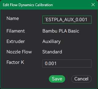

Cool, but what about auxiliary extrusion? I tested aux and got 5 identical prints no matter what I did, only M901 gcode done it right
@Petrovich39
I did now run more tests just to verify on the auxiliary extruder.
Used the exact same Process Preset just some speed differences like “outer wall” are changing for the auxiliary extruder.
Also the Filament Preset is the same one. In the above test I did not use the manual G-Code = M901 Kx.â– â– â–
This is the result:
I did create a PA Profile for the auxilary extruder and entered the K-Factor of 0.01 and assigned it to the BL PLA Basic Filament on the left one.
The right one on the other hand was using or assigned to the PA Profile of the main extruder which was at that time using a K-Value of 0.030 which as I would guess did not apply and instead a last saved from the auto Flow Dynamics Calibration was used.
So your take on “with the FTS it stops working” is (at least for me in the mentioned configuration) not true/valid.
On the other hand Bambu should do better as we may want to use our PA Profiles from both extruders on our filaments depending on the print job and color configuration.
Reduces risk and greatly improves User Experience.
@Bambu_support - Please have a look at the observations in this thread. This should be a must to implement.
Thank you and cheers​:clinking_beer_mugs:
