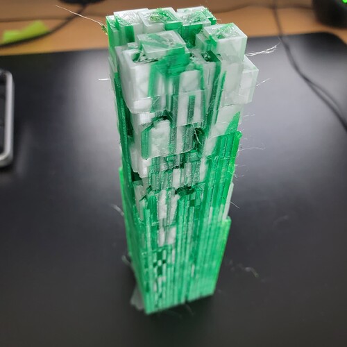

I have been trying to print these for years with mixed results. Single color, no problem (other than filament dye lots not matching, etc.). Multiple color prints remain elusive. With the X1C, I’ve had the best results so far, but the problems have led me to give up.
  • I’ve had problems with “poop” since day 1, and it appears that this has never really been fixed with this printer.
    • Chute clogging
    • Random “droppings” all over the build plate, confusing the spaghetti detector to stop with false positives
    • Random “dropping” inside my prints, causing extra weight and a rattling sound.
  • Random print head cover falling off. Most of the time I can recover from this by just clicking it back on, but many time the X-axis becomes misaligned, ruining my print.
Perhaps I am being too demanding. Are 16-day prints a bad idea? I have had some succeed, other than having the print filled with random poop, but just because the printer can do it, I’m guessing means that I shouldn’t try it.
I get it that the H2 holds the promise with the head switcher to reduce this problem, but given that there are still “not quite ready” features, and this is a V1 implementation, I’m thinking I’m tired of turning perfectly good money into worthless trash.
I’m happy to consider I’m wrong. I would buy a new H2 if I could thoroughly test it first, which means at least 2 months to try and print this.

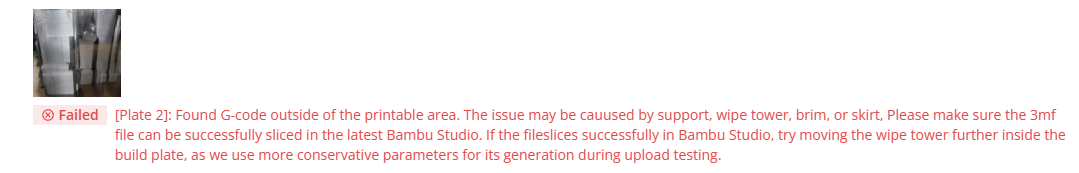

I would attach the job, but I don’t see how. I tried uploading it to my profile, but the system rejected it with this (sic):

Your extrusion multiplier is almost certainly wrong. If your printer is extruding correctly it doesn’t create any excess material, period.
There is zero reason to not be able to print the models you linked. Although I’m a bit curious why the print time is that long, something seems very off.
The poop process is really sensitive to filament moisture levels. I printed a lot of ABS/ASA and Nylon on my X1C and those filaments are like sponges. If the filament wasn’t dry enough, I’d get poops that stuck in the chute or got flung on to the build plate. Redrying always fixed the problem.

Means nothing. In fact, if you assumed your brand new filament right out of the bag was dry so you didn’t bother to dry it, there is a high likelihood that not drying is your problem. There is no guarantee that a sealed filament bag contains dry filament. The packaging is not hermetic and the desiccant package inside is small.
As I stated in my original post, the site wouldn’t let me upload the entire project with profiles, even though it slices and prints fine (up to a point).
Did you look at the video? Does that look like a moist filament failure, after 2 weeks of successful printing?

Yes, it does look like moist filament. What I see is lots of stringing and malformed poops. That’s exactly what moisture does. When the filament has moisture in it, that moisture turns to steam in the hot end and it drives filament out of the nozzle even when the extruder isn’t pushing. Every time the extruder stops extruding, filament will ooze out on its own. When the nozzle is idle for any length of time (like the pauses that happen during filament switches), potentially lots of filament. Which is why the poops are malformed.
There is no other mechanism that can cause this phenomenon.
To me, it looks like your filament is much wetter than you think. The only other way this mess can happen is if the extruder motor runs when it’s not supposed to run. The odds of an extruder failing that way are exceedingly low, IMO. More likely it’d stop extruding entirely than randomly run on its own…

It’s looking like the consensus is moist filament. I’ll try drying and let everyone know. Thanks to everyone for the constructive assistance!
