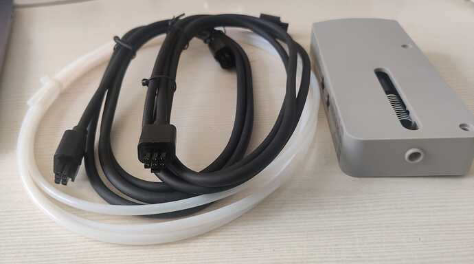

I bought following things:
  1. Bambu Lab AMS 2 pro: it has one 6 pin cable
  2. Bambu Lab AMS Hub: It has two 6 pin cable, a PTFE tube and 1 AMS HUB
    Image of Content of AMS HUB:
AFAIK AMS 2 pro does not have 4 pin cable, neither AMS HUB as per their content page on Bambu lab website.
Now I don’t have 4 pin cable and cant find it in India its out of stock all over internet.
This is pathetic situation Bambu lab (if you are reading) why not 4 pin cable included?

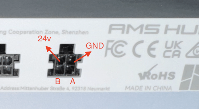

Finally after reading about pin out and connector find out 2 pins were for 24v and GND, other 2 pins are for RS 485 communication.
Connected these with female jumper wire after removing its casing and ams pro 2 is working well.
For others reference attaching images which I used wiring up.
You’re right! I saw only the picture with the 2 cables and thought, it were a 4 and 6 pin cable. Before the AMS 2 Pro and AMS HT it made sense, because the AMS 1 contains the cable together with the filament buffer. And the AMS Hub for P1 / X1 series was used to connect to multiple AMS (1). So normally one or more 4 pin cables were available. :roll_eyes:
