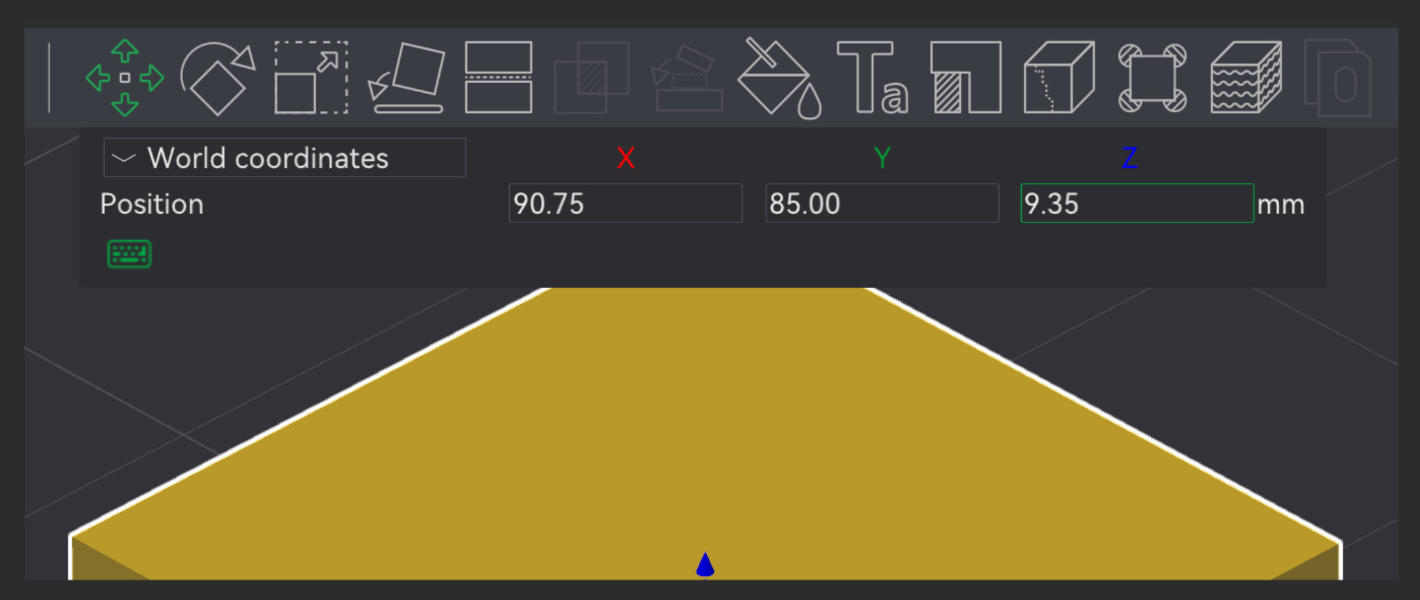

If you want to do it accurately, don’t move it by hand; instead, use numerical values and world coordinates:
Try Face and Face Assembly or Point and Point Assembly.
