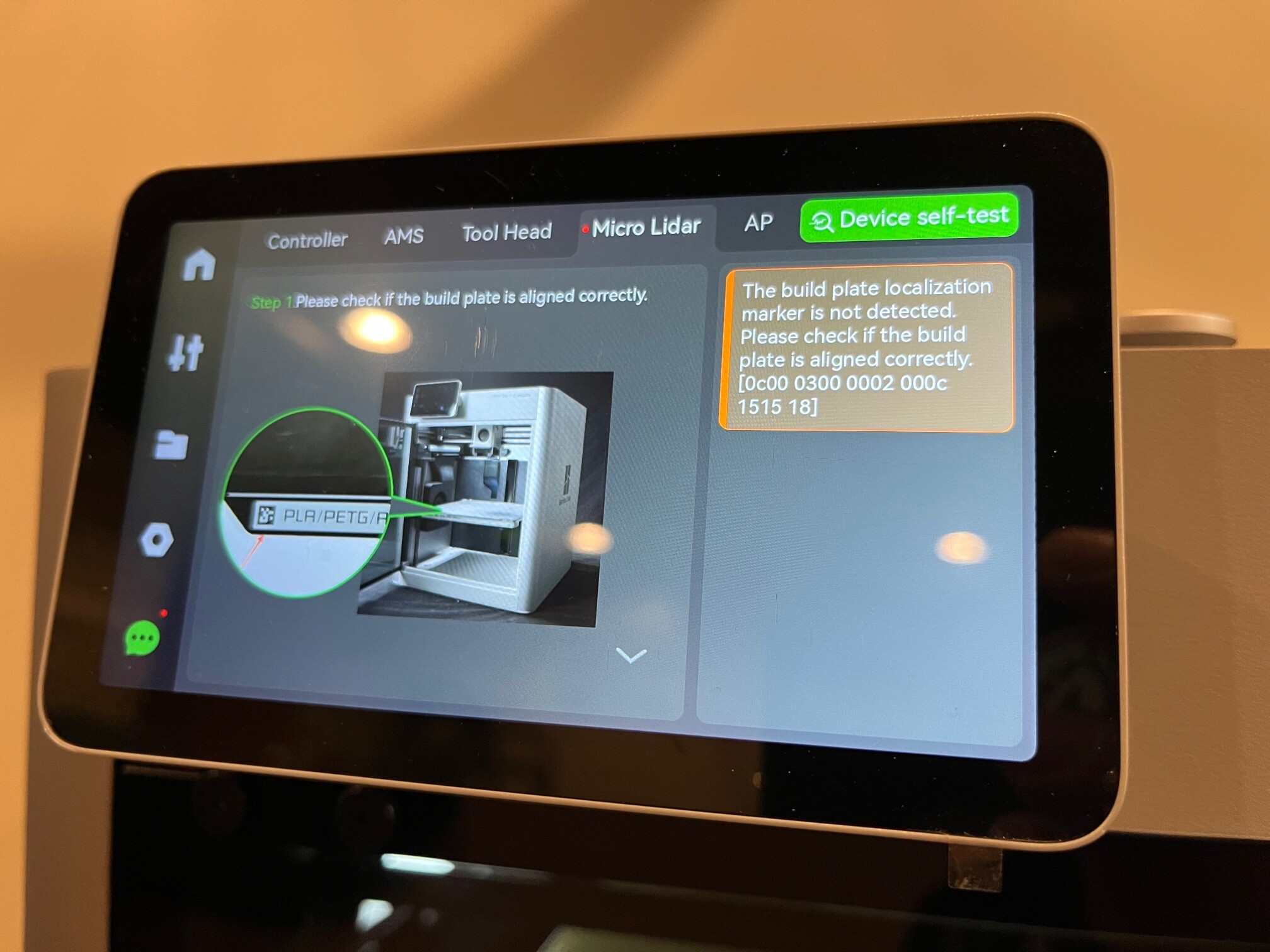

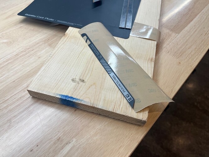

The Bambu detected abnormalities with the build plate and I didn’t know there was a little code on the cool plate that it scans. I just cut that small section off the cool plate and stuck it to the build sheet to trick the machine.

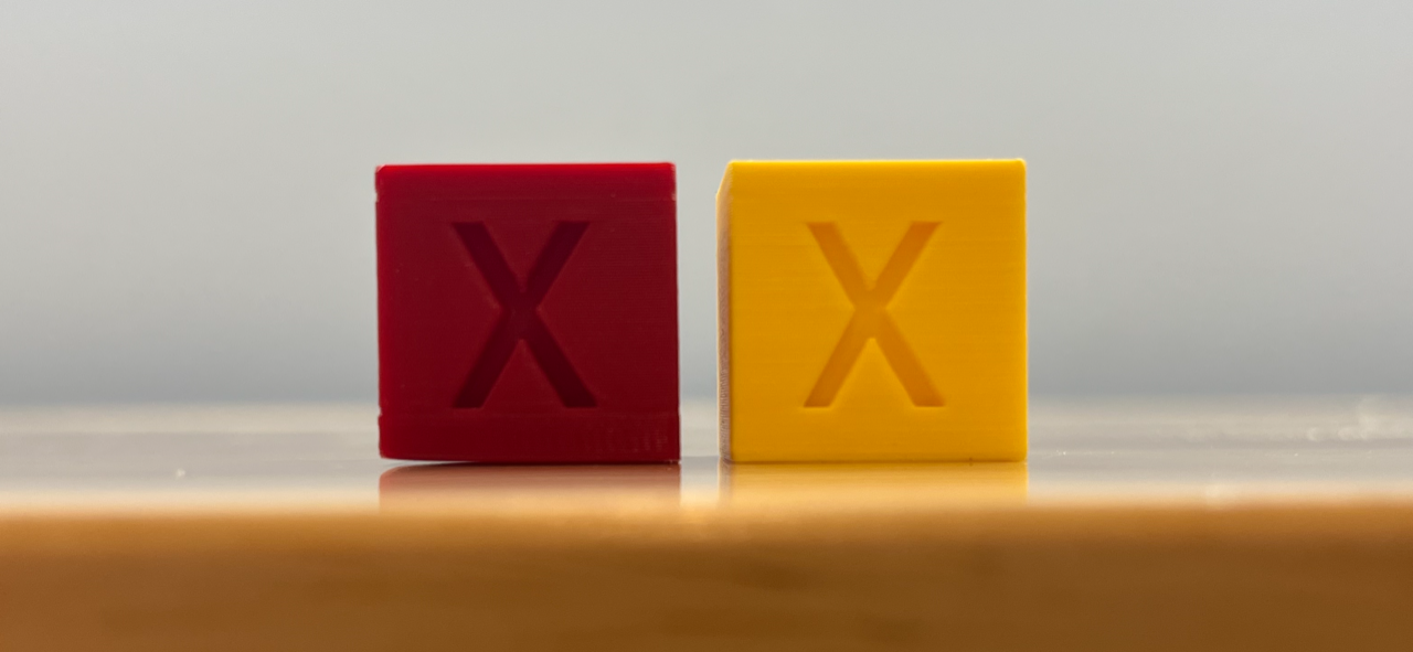

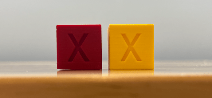

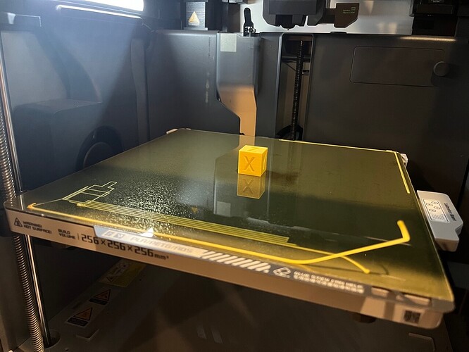

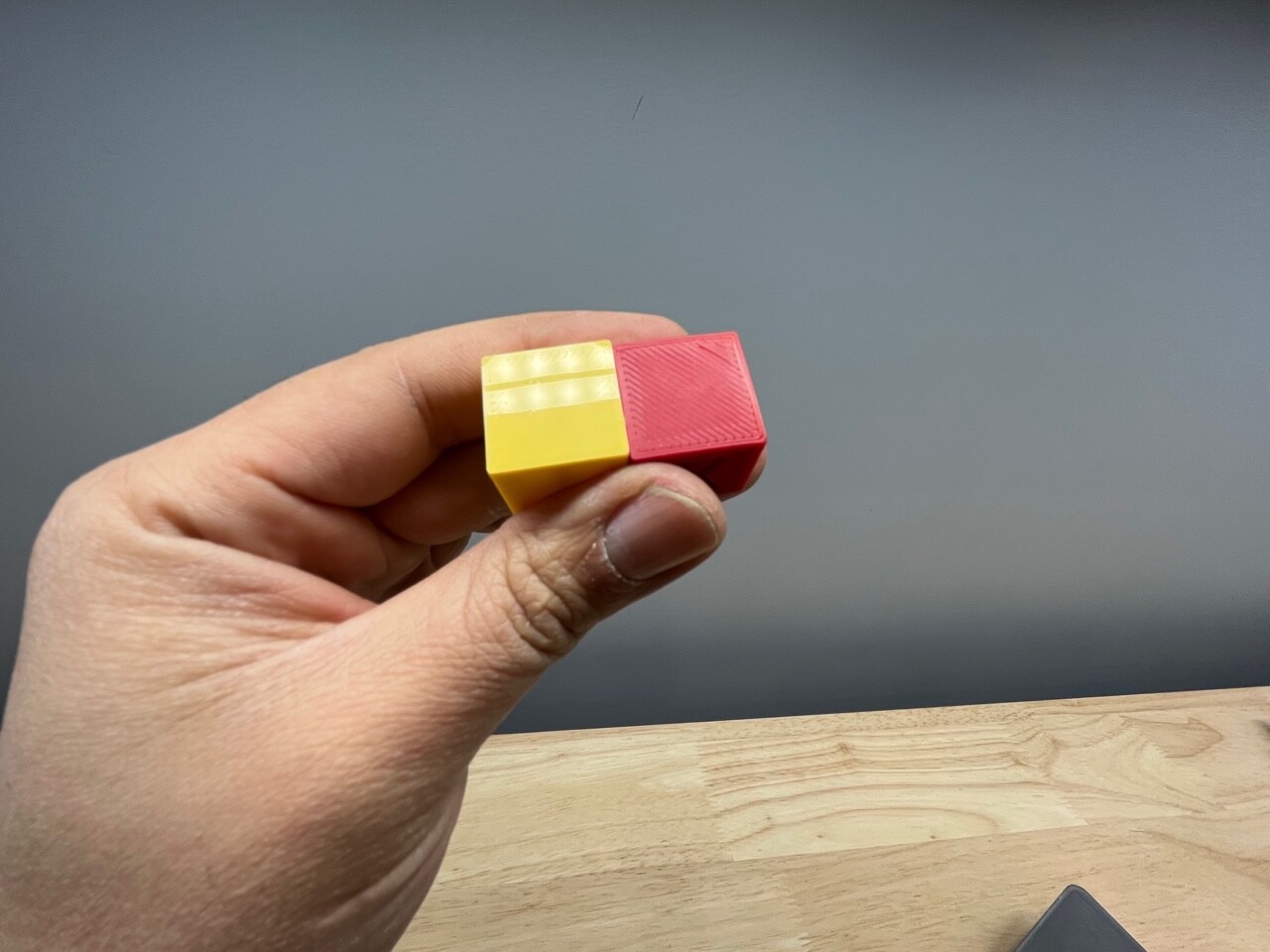

One of the small parts I would have adhesion issues with is the calibration cube. Red part(PLA) would lift off the plate (aux fan side) with the cool plate. Yellow part(PLA) on PEI is nice and flat and released really well when finished. I had concerns the Bambu wasn’t going to like this mod ,but I am very pleased it works with the Gizmo PEI sheet and I would highly recommend this upgrade. Only thing I will do different is scuff the glossy sheet with 800grit sand paper like I have with my other PEI build plates because I don’t like the glossy bottom layer.

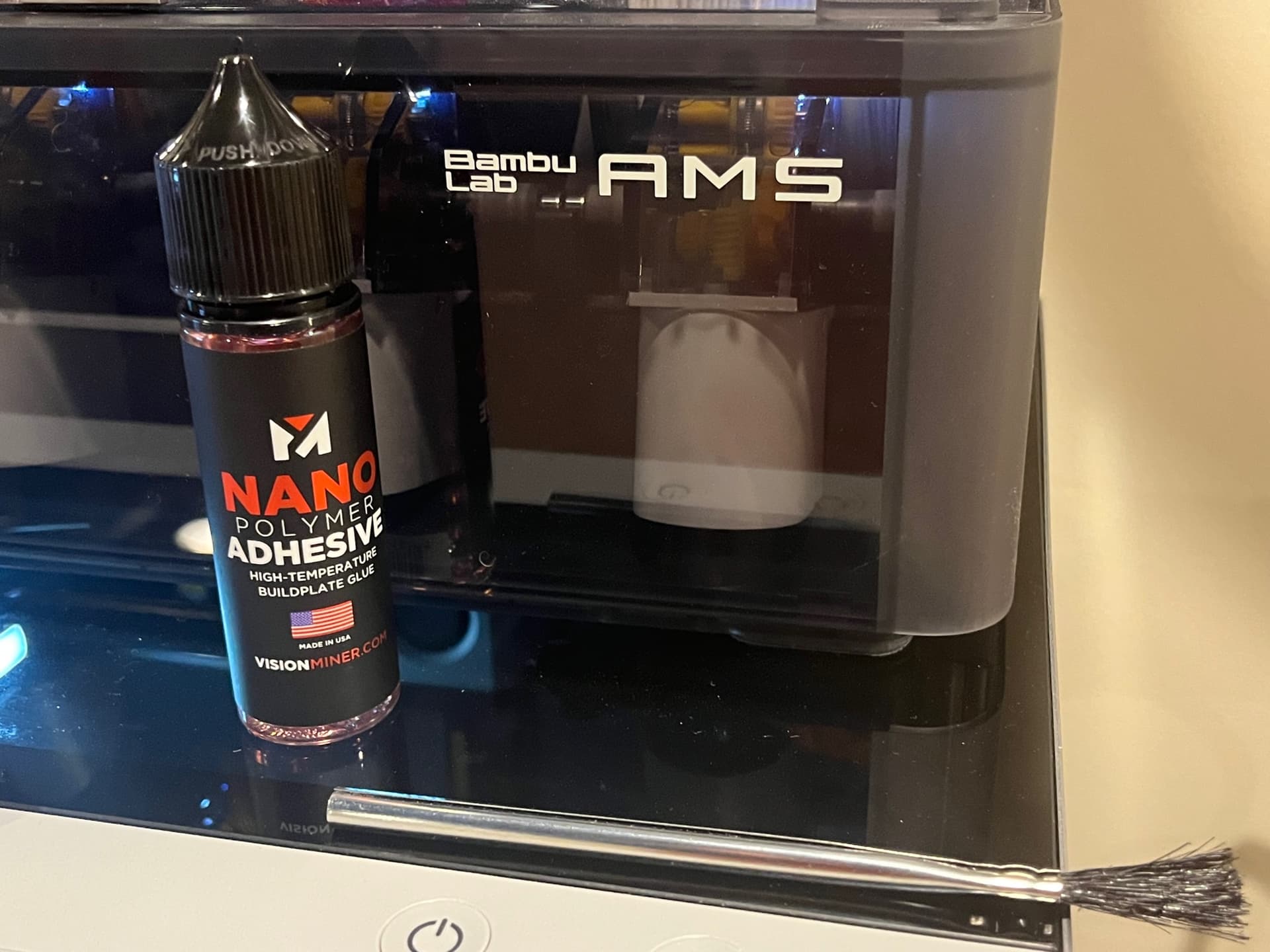

Received the Vision Miner Nano Polymer Adhesive and after testing for a week, I am very happy with the adhesion this product provides. Very pleased with the Bambu X1 ,but first layer adhesion has been a problem for me so I’ve been very pleased with the modded PEI sheet (Gizmo $17.95, Amazon) and the recommended to me Vision Miner adhesive. The PEI sheet performs well on its own ,but after testing with various size parts, I still find a little warping on corners with long skinny first layers and it is always on the aux fan side. The combination of the Gizmo and Vision miner results in zero warping or lift on any parts I have printed so far.

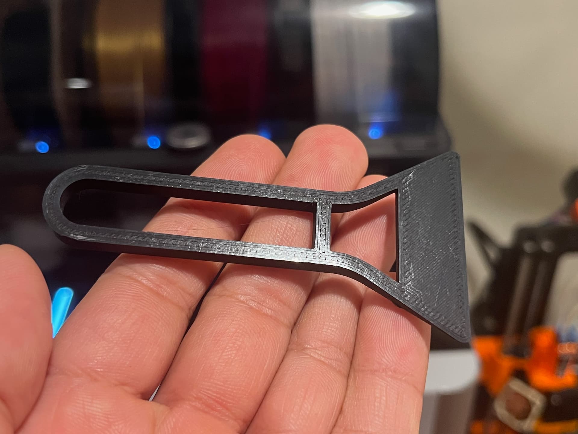

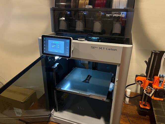

Just for fun, I wanted to try printing PLA on the engineering plate using the stock bed scraper file, 220C EXT./35C BED. The only success I have ever had on the engineering plate is PETG with bed temps of 90C+ so I am happy to report the PLA bed scraper printed perfectly with no warp or lift. This is just a quick test and results might be different with larger prints!
So if anyone is having trouble with part warp or lift, I would highly recommend trying the Vision Miner first before modding with the Gizmo PEI sheet and that is because the 3M adhesive on the Gizmo is very very strong, basically making it a permanent mod, and I’d probally buy another flexible build plate before trying to remove it to replace. Of course there is also the Bambu offerings and these are just options if you can’t seem to find anything to work.
Want to say thank you again for the people that recommended the Vision Miner Product!
