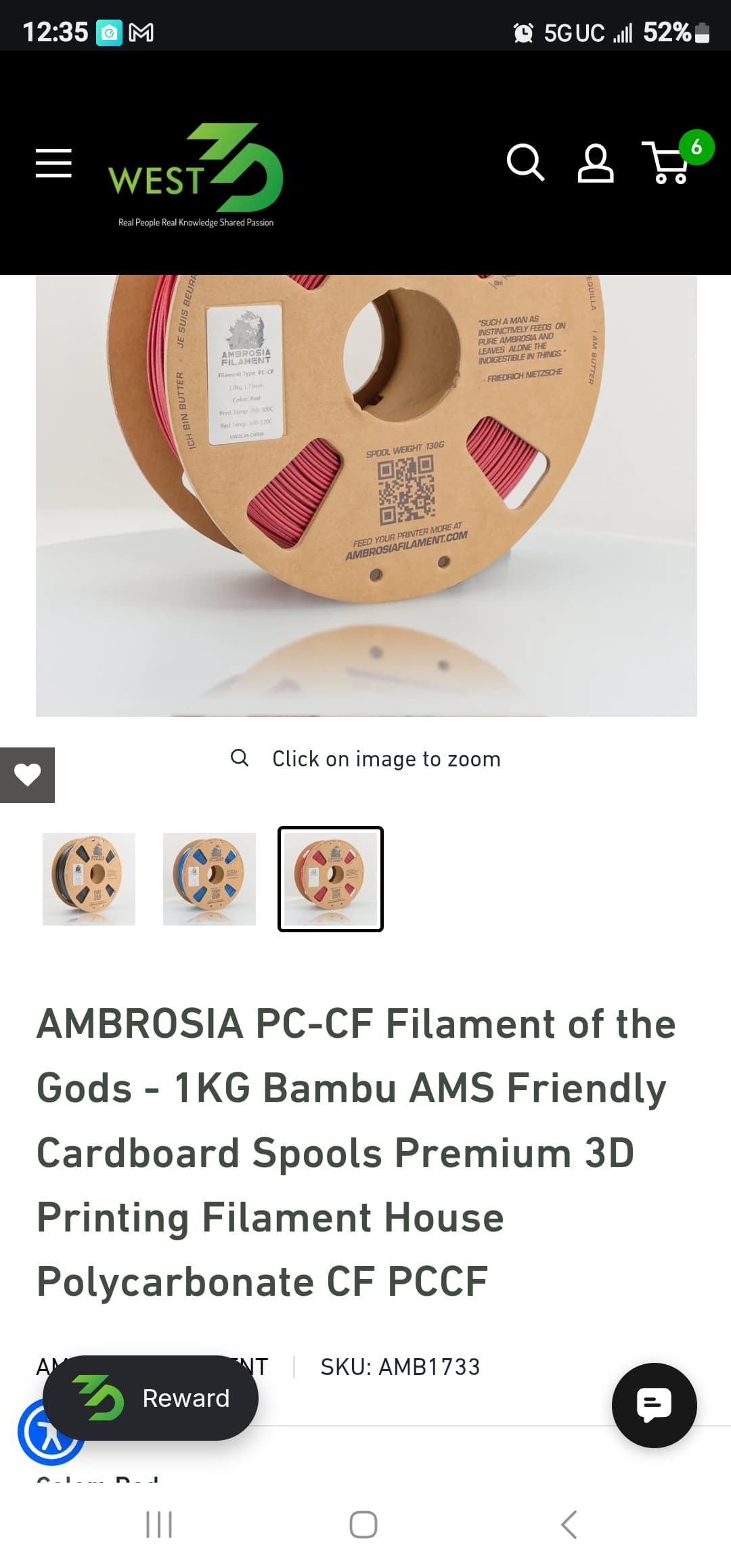

Looks like a bit of an overload on requirements. Qidi’s PPS-CF prints very well on a Plus 4 but would need to be painted to match a color…
PC isn’t good enough for him, PPS-CF is worse.
Good point. Got by columms mixed up…
