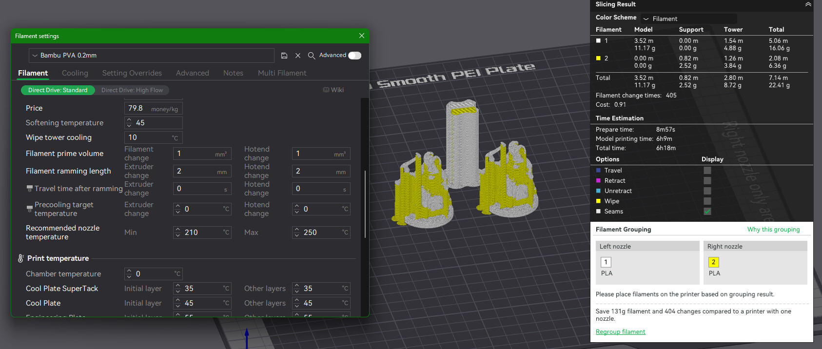

Regarding your advice, those prime volumes and ramming lenghts, do you use those values for a 0.4mm nozzle or 0.2mm nozzle?
With your values I didn’t even come close to an acceptable tower (I only tried it for a 0.2mm nozzle, not 0.4), but for a 0.2mm nozzle I had to even further reduce it to 1mm³ and 2mm respectively. I had also have to do the same for the “filament change” and “extruder change”, which kinda makes sense if I think about it.
Anyway, too much rambling, here some screenshots for others
For this print I also changed the “Length when change hotend” to 2mm to match the ramming length. To be honest I can’t really tell if it actually helped.
Regardless, these settings gave me 2 succesful prints both printing with PLA Matte and PVA.

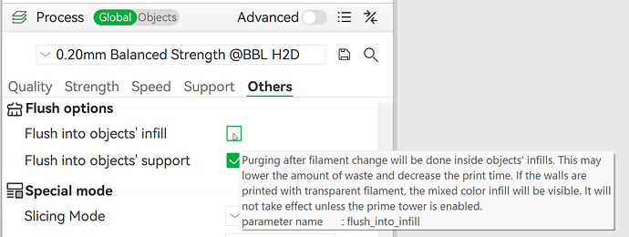

Not sure what you mean with “clean”.
For priming I guess it is not ideal to do that into the infill. For flushing, yes, it is possible and can be enabled in the process settings.
