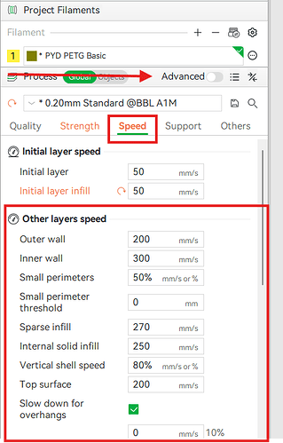

Hi everyone! When printing this model, I get very obvious layer lines when it finishes and starts the circle. The 3MF is perfect, no non manifold triangles and well designed. The problem I think it the cooling speed. Can anyone help me?
Edit: I’m using pla. Also, where is the speed section in bambu studio?
Hi, I think you need the “advanced” toggle on for speed.
And any solutions for the layer lines?
There is no magic button.
  1. Properly calibrate the filament (Temp Tower, PA, Max Flow Rate)
  2. Experiment with cooling settings
  3. Experiment with print speed
  4. Open the door/roof if it gets too hot inside (especially when printing PLA)
I believe something here should help.
