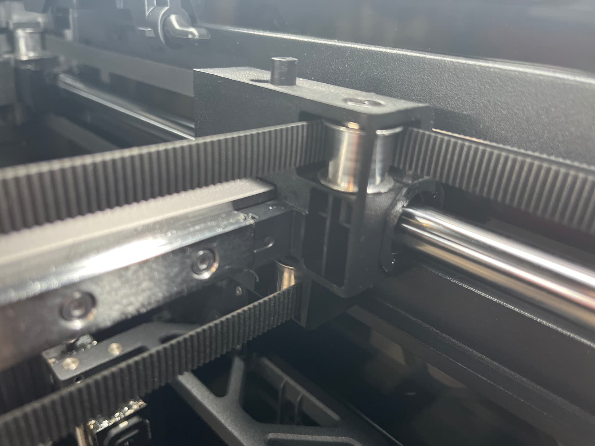

People actually questionned not the fact that the belt could run a bit sideways and drag against the flanges but that the tooth side of the belt runs on some smooth pulleys rather that the back of the belt thinking this could be the reason for some VFA and some tried to replace those pulleys by toothed ones. I think nobody proved it made any difference and my H2C is built the same… so no, issue is not fixed because there is no issue.
Thank you! Appreciate knowing I’m not making any of this up.
