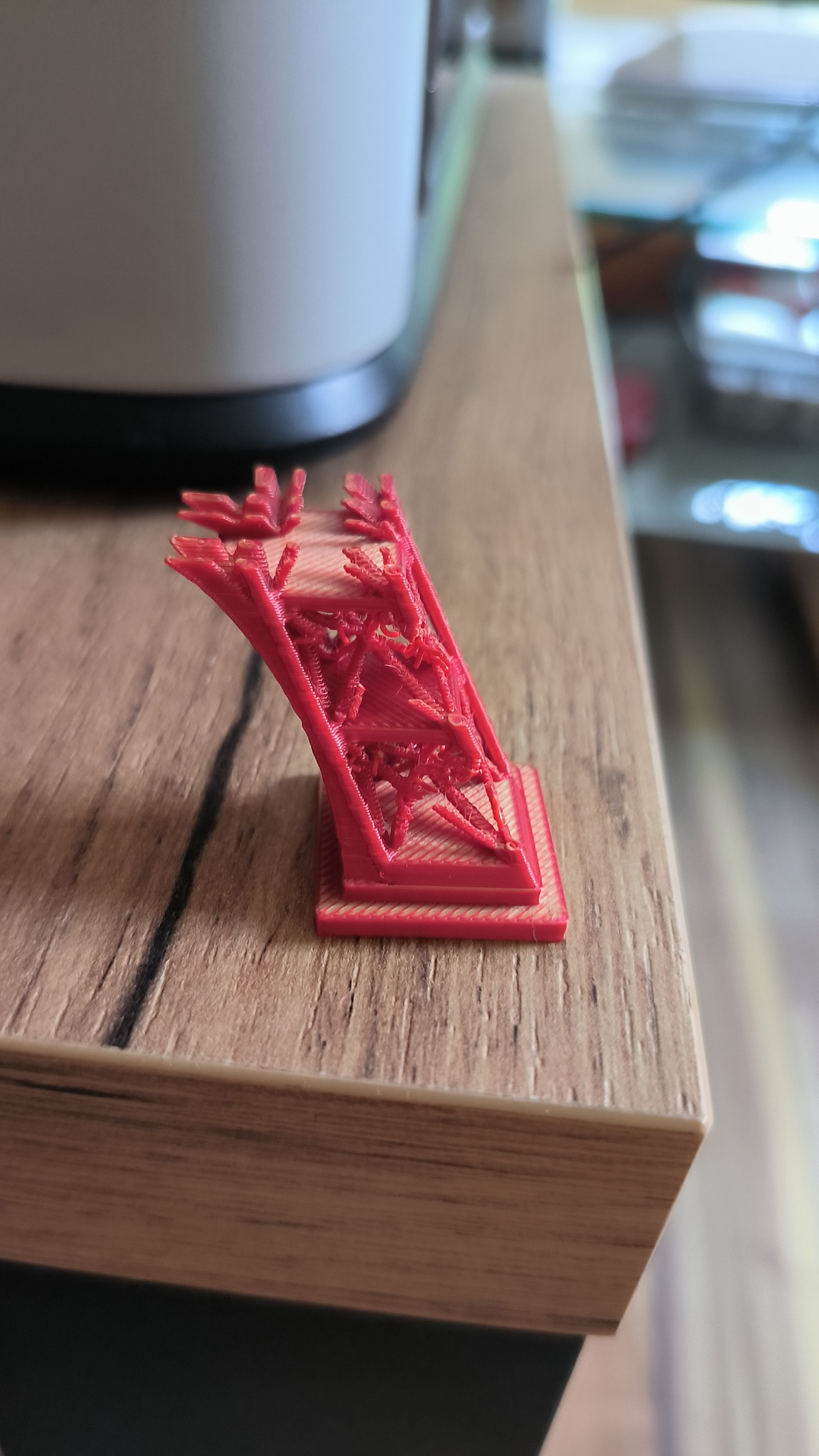

My Print fails. 1-5 PLA, 6 and 7 is from ASA

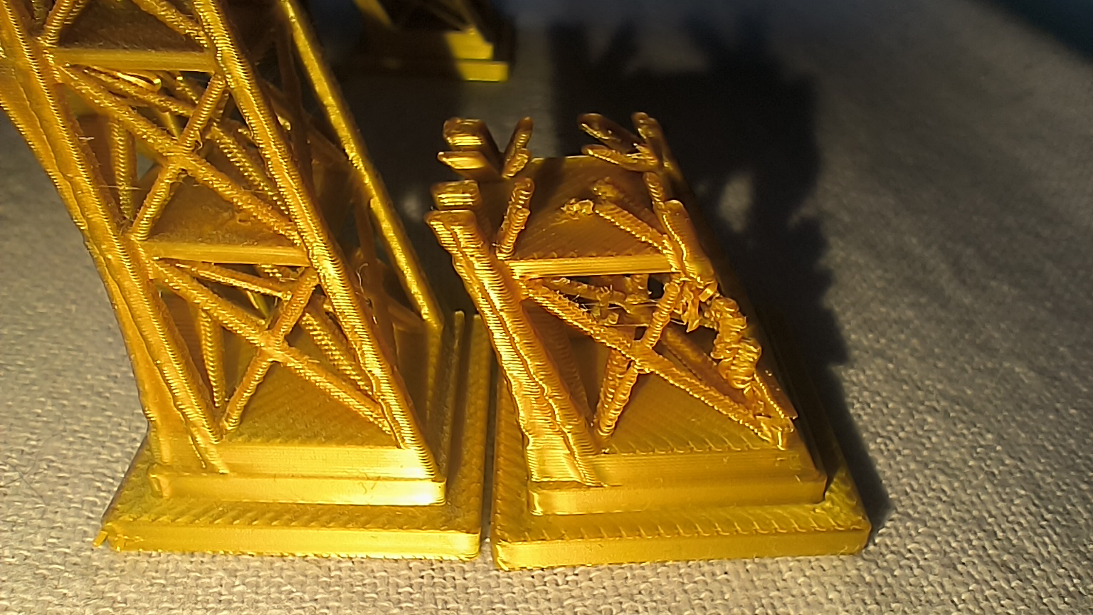

We printed about 2500 hours on A1 and I had a print success rate of about 98%, now I have about 50%. I’m trying different configurations because I understand that the profiles are not tuned. But this is really extreme. I tried the forum on FB but no one could give me advice. For comparison, printing the same Eiffel Tower project from the same material. A1 on the left, H2D on the right.

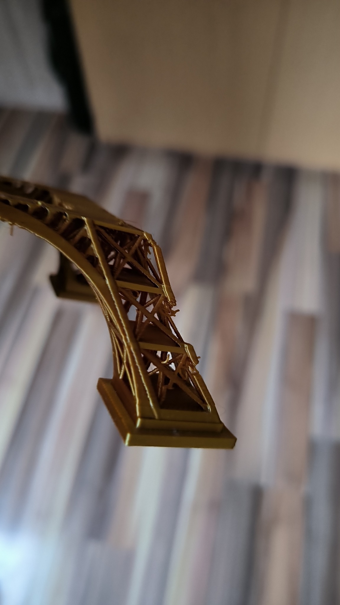

I would like to give some advice on printing small parts. I switched from A1 to H2D but I noticed that objects that I printed on A1 without any problems and in any configuration, I can’t print on H2D at all. I first encountered a problem with the Eiffel Tower which was no problem on A1 but with H2D I tried different printing profiles from 0.2mm, 0.16, 0.12 to 0.08 and the bottom part always breaks off. I also tried adjusting the profile speeds on H2D according to the profile from A1 but it only improved a little. I also tried half the speeds and although better but still error-prone. I also saw a similar problem with smaller perimeters when printing a box. Thin lines simply broke off in a certain place. Nowhere else, only in the middle at the back. I tried different PLA. Printer temperature 32 degrees Celsius. Filament 220/230 degrees. Interestingly, the Eiffel Tower has a problem on all 4 outer sides, not anywhere else, and the box has a problem in the middle back. Please help
Those top surfaces are giving you a clue. The filament is not extruding properly. Now you have to figure out why.
The first and easiest thing to do is to ensure the filament is dry.
The second thing to do is calibrate the filament. Flow rate & flow dynamics. These pretty much need to be perfect for small features like the ones on the Eiffel Tower print you’re doing. Get this done if you haven’t already.
See where those 2 things get you and we can go from there.
Thanks for the response but I really don’t understand. I did both calibrations that BambuStudio allows and since I have AMS 2, of course my filament is perfectly dried. Now about 13%. I never solved the humidity on A1, which is open. I solve it here and it doesn’t help me. I would be happy for other ideas what to try. I tested heights, temperatures and speeds but I can’t print it.

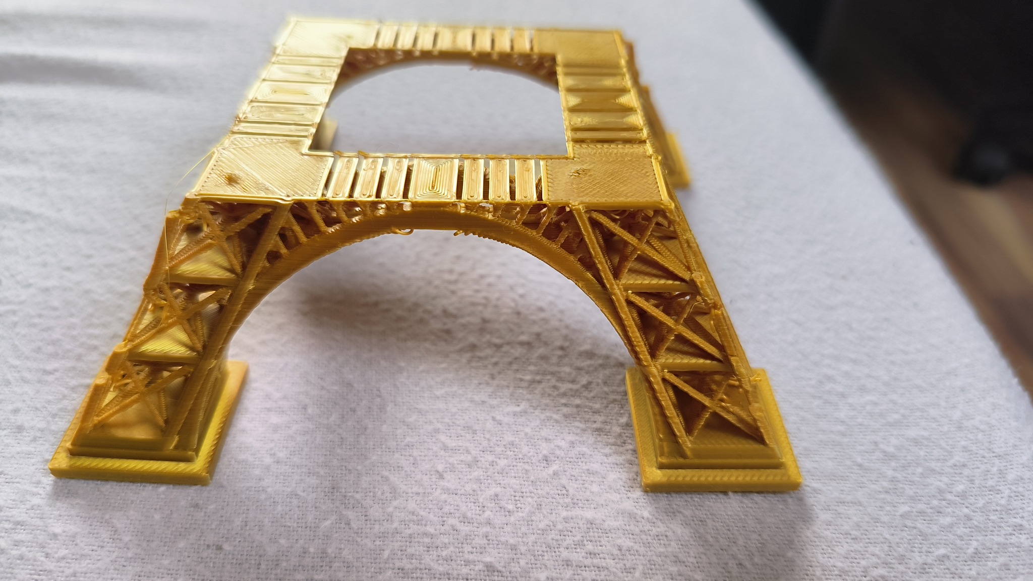

In some individual posts, the H2D fans were mentioned as being noticeably more powerful than those of the A, P and X series. Using identical relative fan speed settings, the H2D would then deliver a higher airflow, providing more cooling. This in turn can become a problem in curling prone prints such as the Eifel-Tower.

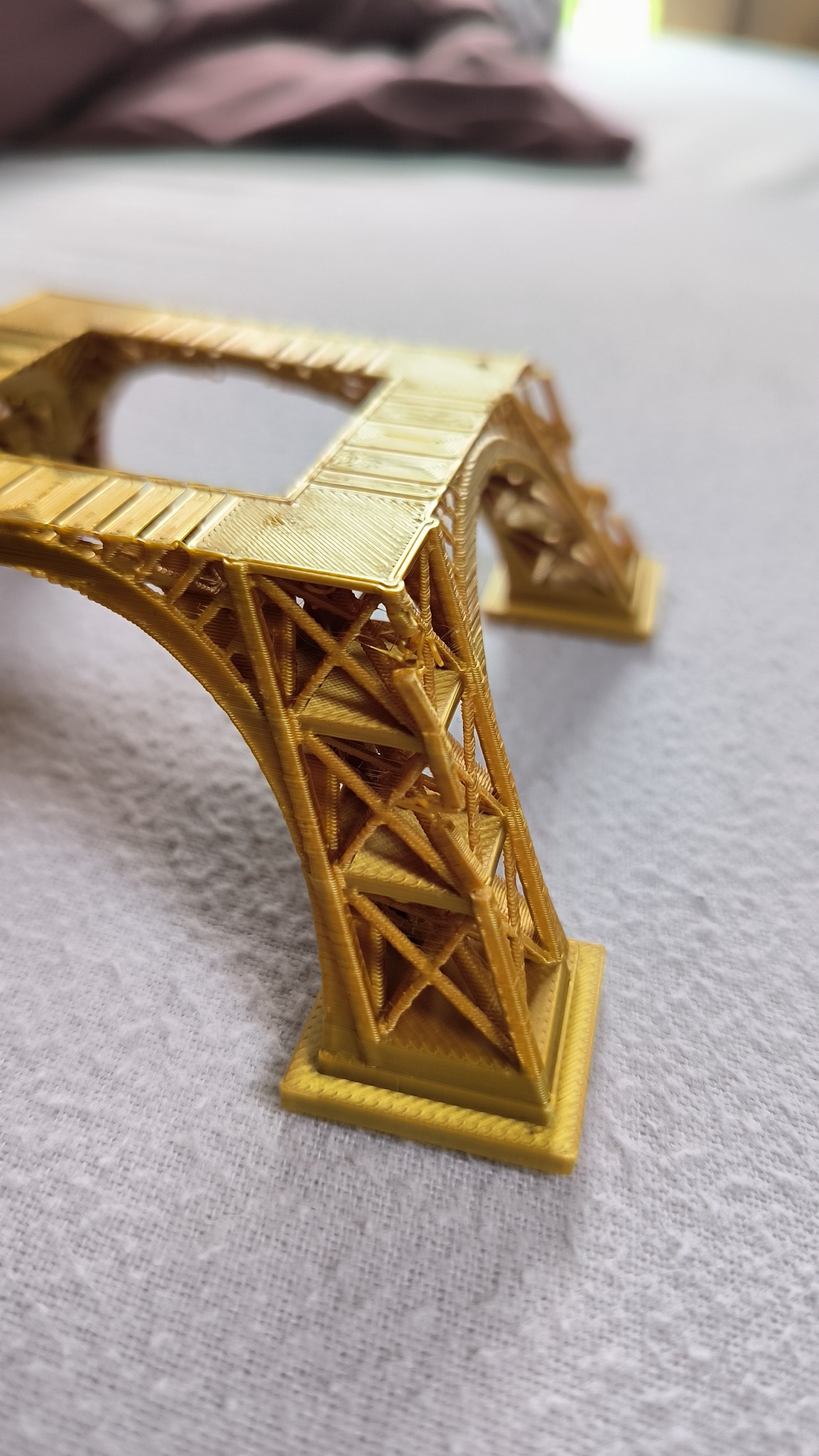

Indeed, the red Tower foot seems to show quite a bit of curling. Unless of course it is just confirmation bias…
My own experience with trying to dial in cooling settings were a real PITA. But if the failure mode is curling and filament dryness, chamber temp, speed and layer height reduction have all been ruled out and tried already…
But it would be a real bummer if filament profiles were not in fact applicable across the series. Maybe we’d need to use conversion tables for absolute air flow (part fan) and airspeed (aux fan)…
Apologies if this is BS. Just an idea based on comments I read and printing on my X1.
Hi, I have also tested different fan configurations. Unfortunately, this could be a problem with multiple things at once and I am already frustrated. Or it could just be something I haven’t tried yet and I believe in the community’s ideas, but back to the idea, I tried it with the side fan turned off to the extreme and also with the ventilation on full. I only noticed a slight improvement but every time, even with different PLA manufacturers, those thin ethereal prints broke off. I don’t know why. I have several towers from A1 and I have never set anything extra.

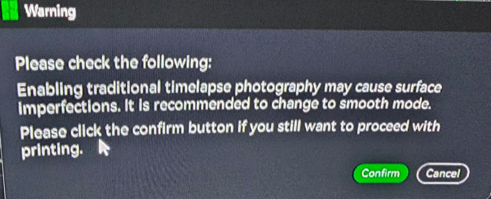

With the Eifel-Tower, the problem could of course also be related to layer time and the warmer ā€œchamberā€ when compared to the A1. In this case the smooth timelapse hint by @StreetSports could be a really good one.
