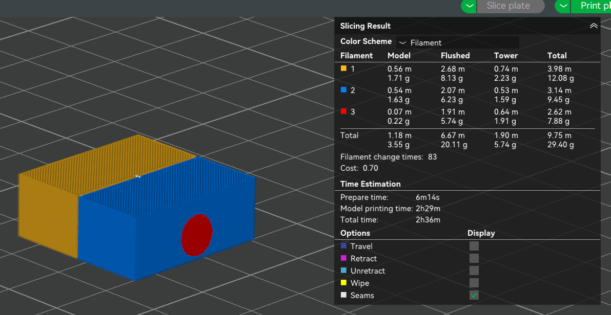

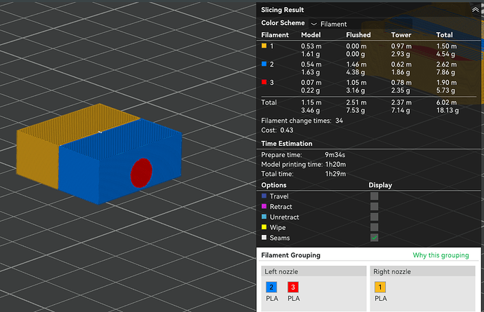

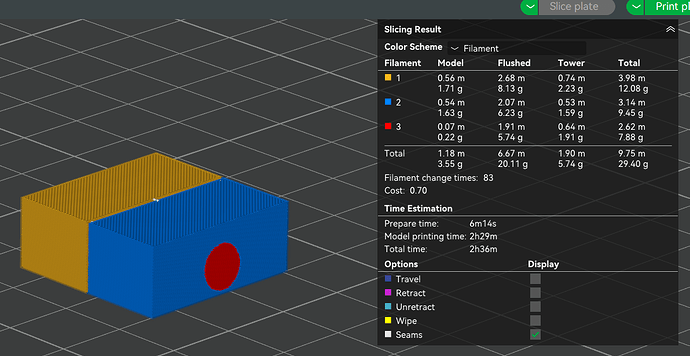

Unless I’m misunderstanding your metric, that seems misleading. The multicolor being slower would only maybe (but not likely) be true if you’re not utilizing the 2nd nozzle, which I’m not sure why you would if you’re doing a multicolor print where it’s optimal to use it. It’s absolutely faster for multicolor at effectively any amount of changes, not just those over 100.
Here’s a 25x25x10mm multicolor shape (83 changes on a single nozzle) on both the P1S and H2D:
P1S:
H2D:
H2D knocks it out of the park and more than halves the number of changes, so I’m a little confused by what you mean there.
